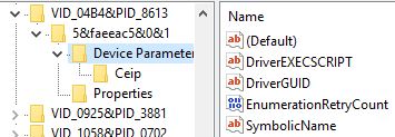

I believe I finally have a solution to the script problem. After my first attempt failed (post #14) I spent some time with the MS and Cypress .inf documentation. It turns out the original CyUSB.inf file is missing the statement in the [Strings] section that defines the path of the script file. No wonder it fails. So here's what I did:
1. Created a new directory and copied the SigmaStudio ADI_USBi.spt, CyUSB.inf and CyUSB.sys files (see post #14 for the path). Then I renamed CyUSB.inf to CyUSBx.inf and CyUSB.sys to CyUSBx.sys.
2. Edited the .inf file to correct the error, gave it a new GUID (per Cypress recommendation), changed descrption strings and cleaned up the code. Full comments are in the header.
3. Used device manager and the "Update Driver" option to load the new driver. See post #14 and be sure to select the "Have Disk" option. Since the driver is unsigned you may have to restart Windows with the "Disable driver signature enforement" option.
4. After the driver was installed the I2C LED on the USBi card immediately turned on and SigmaStudio colors the device green w/o having to run the script. I unplugged/replugged the card several times and each time the I2C LED comes on and SigmaStudio automatically recognizes the device.
Notes:
- I attached the new CyUSBx.inf file. I had to rename it to CyUSBx.txt.
- I always have the CY7C68013A board jumper off.
- When you load the driver you should see "Mini-USB USBi (Chinese)" as the model. This changes back to "Analog Devices USBi (programmed)" in Device Manager after the script is run.
- The Cypress USB Console app still seems to work with this driver.
- Hope this works for everyone. 🙂
No, doesn't work for me....
board comes up everytime as Analog devices usbi programmed ok, but script does not load and Sigma Studio does not see the board, unless I load the script manually.
I don't see the device name changing from mini usb to analog devices either.
Sorry it didn't work for you, Here's a couple trouble shooting notes:
- The board needs to appear as the regular Cypress board (VID 0x4B4, PID 0x8613) for CyUSBx.inf to work. You can check the board's properties in Device Manager before doing the Update Driver. If you have the jumper on or have already run the script the VID/PID will be different.
- When you did the Update Driver did you see Model ""Mini-USB USBi (Chinese)"?
- After CyUSBx.inf runs there should be a registry entry named "DriverEXECSCRIPT". It's under HKEY_LOCAL_MACHINE\SYSTEM\ControlSet001\Enum\USB on my machine. I attached a screenshot.
Hope this helps.
