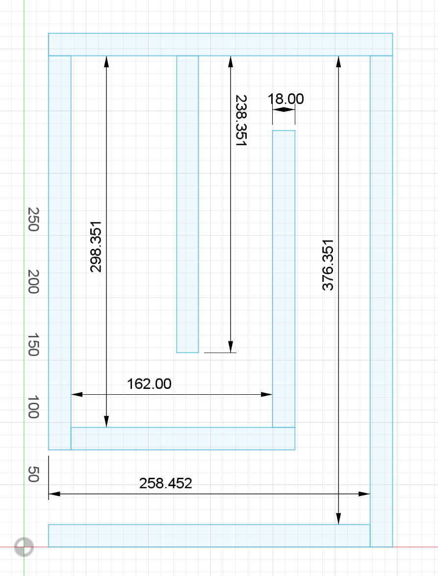

Привет от България!
Искам да попитам автора на темата XRK971 има ли промяна в кутията на оригиналния чертеж в началото на темата.
Ще използвам тези високоговорители:
https://www.soundimports.eu/en/sb-a...XnnqPtGAynkTLXgTMR_6IbX7VCvhjOMHZMkaAtXbEALw_ w cB
https://www.soundimports.eu/en/sb-acoustics-sb19st-c000-4.html
Тази рисунка имах предвид.
Hello from Bulgaria!
I want to ask the author of the XRK971 theme if there is a change in the box of the original drawing at the beginning of the topic.
I'll use these speakers:
This drawing I meant.

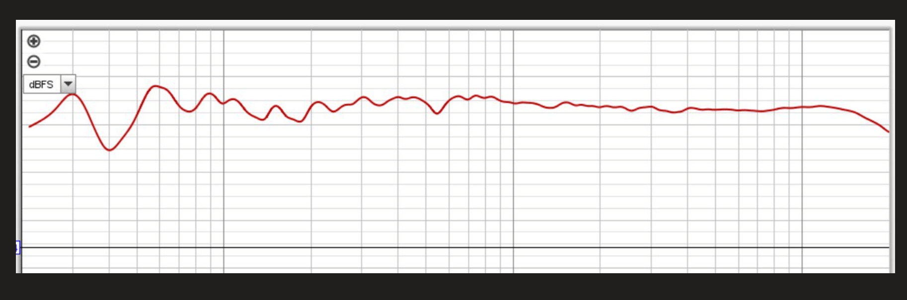

This is what I get, I had measured at 1m at middle point between woofer and tweeter.

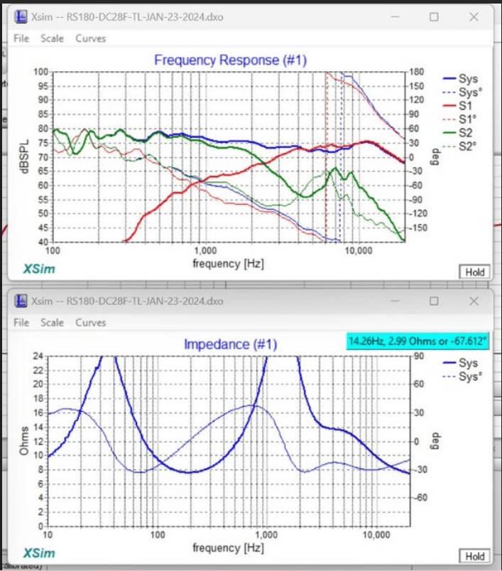

@xrk971 - I have moved my speakers to a different room now, so thought of revisiting the measurement of the TL with RS180-8/DC28F version of mine.
Getting a huge dip around 40hz due to which the low ends are getting cancelled, seems a room issue any suggestions to fix it?

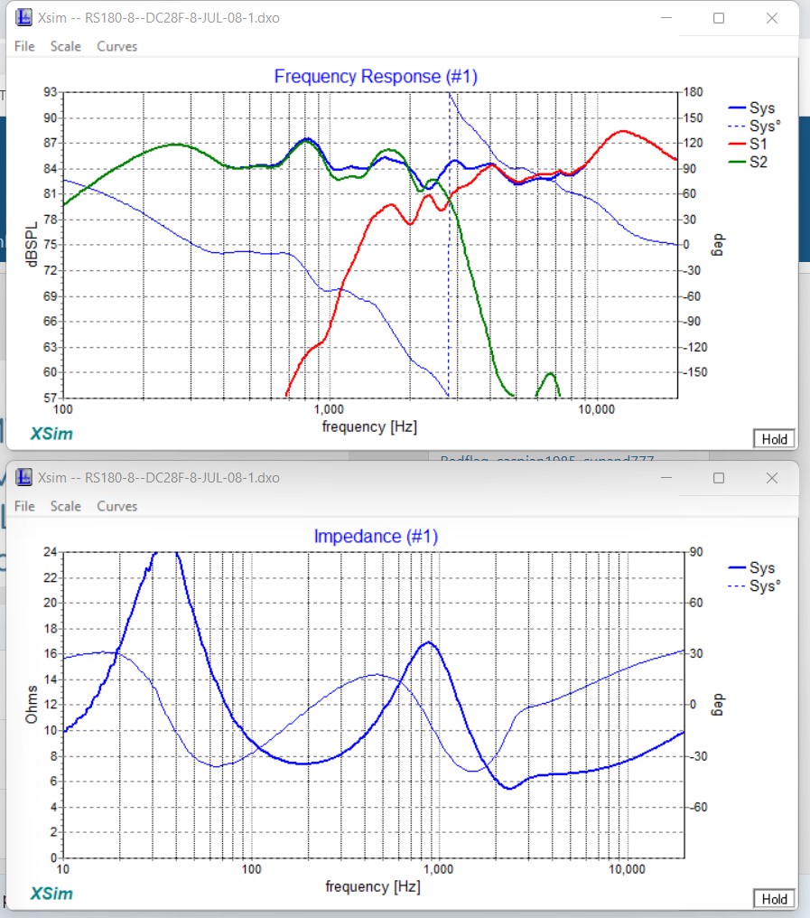

This is the crossover I did it for them now
Measured response in room
Reactions: audiomovil
