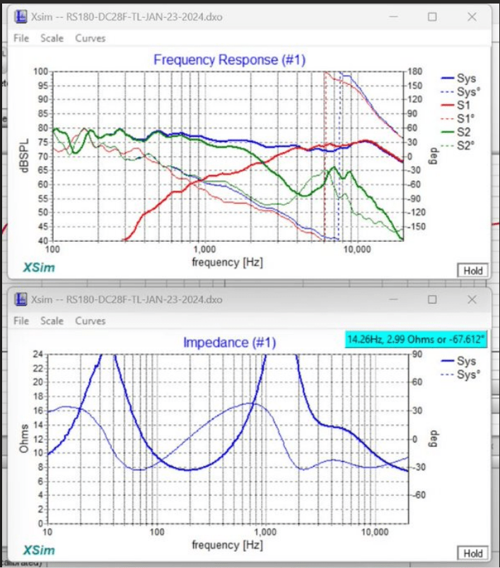

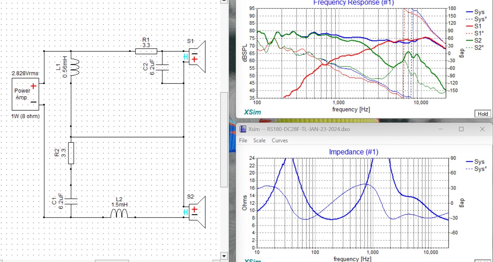

Whats your view on the crossover which i put in, can you just have a view on that simulation when time permits
You mean this? I think it looks good and 2.5kHz is a good place to cross. Can you show the schematic? If you want, put all the files (dxo, frd, zma etc all in zip archive) and upload to this thread. I’ll take a look at it on Xsim.
Here is the complete xover schematic and also attached all the requested file in zip formatYou mean this? I think it looks good and 2.5kHz is a good place to cross. Can you show the schematic? If you want, put all the files (dxo, frd, zma etc all in zip archive) and upload to this thread. I’ll take a look at it on Xsim.
