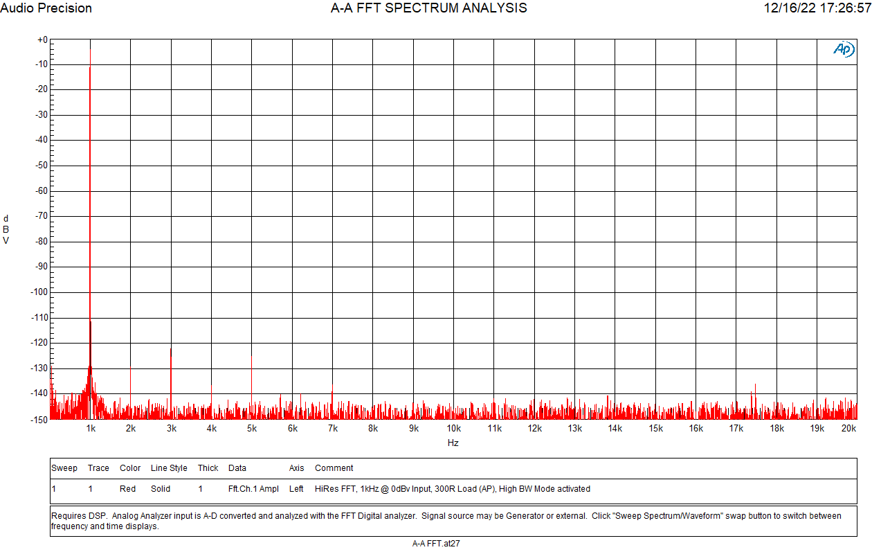

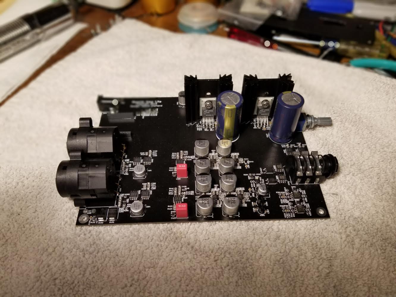

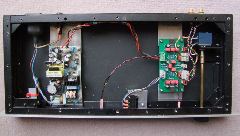

This is my amp that I completed in January. I made the case a long time ago to house an earlier headphone amp. It is constructed so that nothing is fixed to the bottom panel so that, with the bottom panel removed, the underside of the PCBs can be easily accessed.

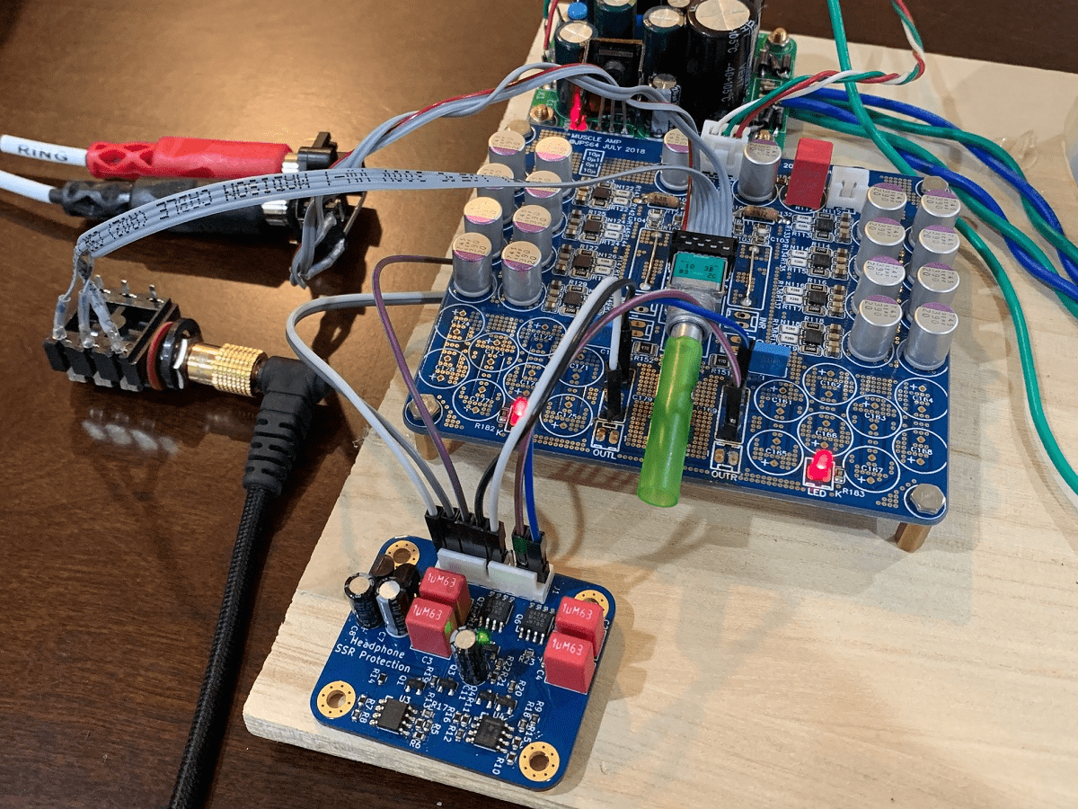

An add-on relay board has been designed. It can be added to the headphone amp to mute a line feed so that, for example, the insertion of the headphones will disconnect that line feed to speaker power amps if they are routed through the headphone box.
There are two stereo relays controlled by the same circuitry.

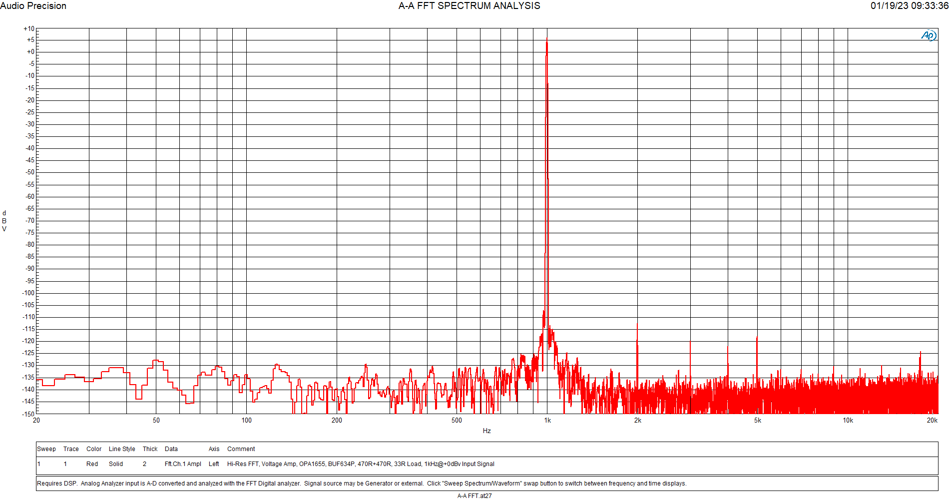

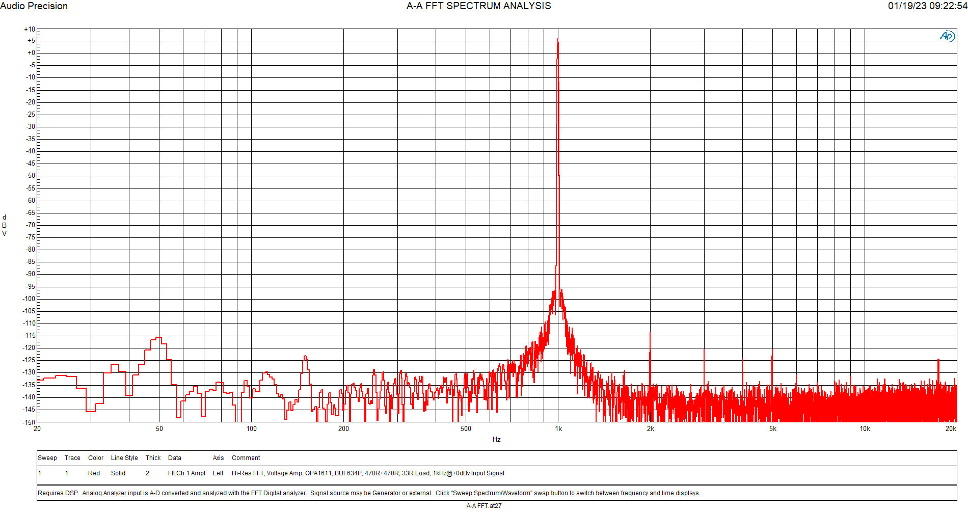

Inspired by your design I made a bread board design with a BUF634P and I'm really impressed at how good the OPA1656/OPA1655 can perform, heck in my design the FFT even looks a little bit better than the FFT with the LT1028 or the OPA1611!
Nice work. I’m sure it sounds great. This concept is great fun.

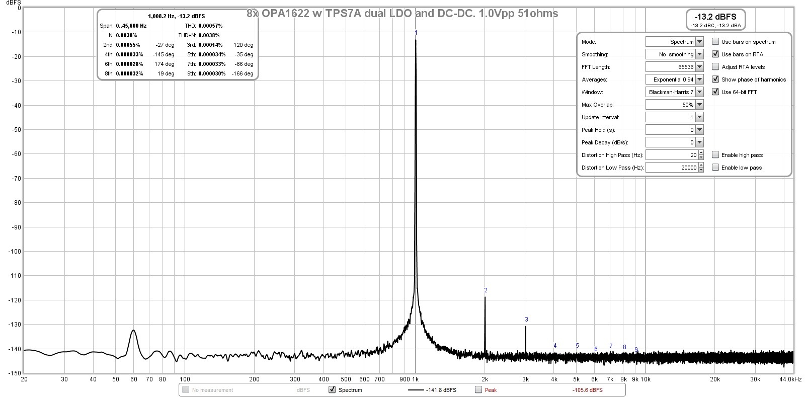

Jhofland made the Muscle Amp lite using 4 OPA1656’s in parallel driven by an OPA1656. Since they can drive 100mA each, it was good for up to 400mA drive. It definitely had some “Muscle”.
I made one using 8x OPA1622 in parallel. It could drive 8ohm speakers. But kind of pricey for all those OPA1622’s.
