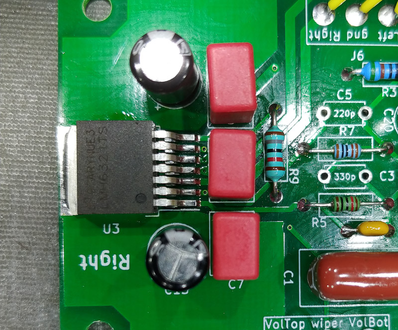

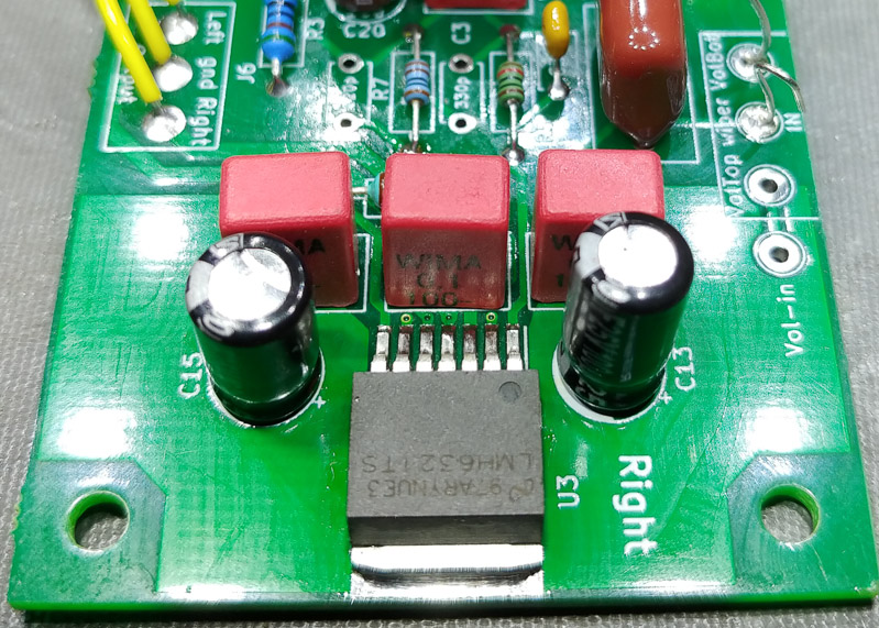

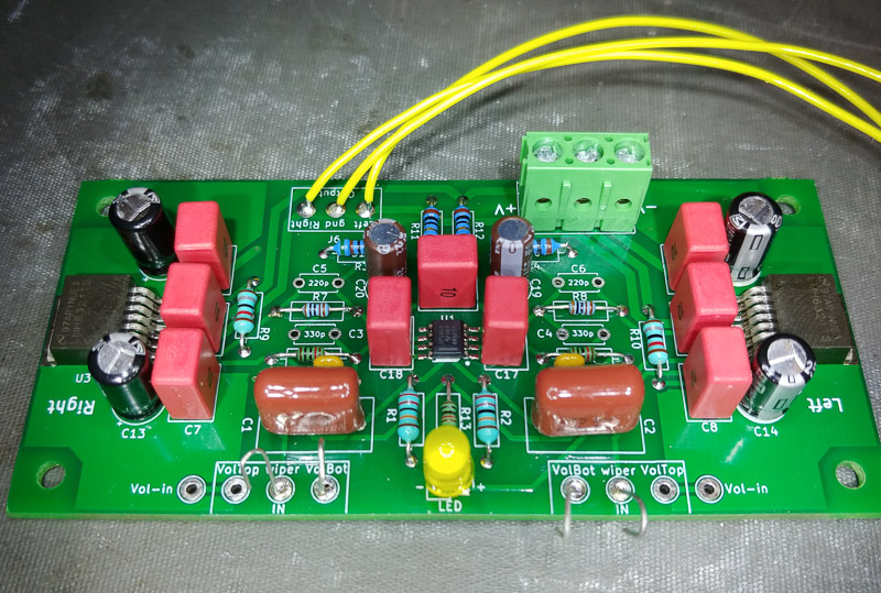

I've had a successful build as well, constructed according to the BOM except for the feedback resistor which I increased to 1K to up the gain a little. I'll be driving 250R DT880s with this amp from an LG VG30 source so I may need to raise the gain a little more.
I had some concern about soldering the DPAKs but it was straightforward in practice. Good cleanliness, a little flux and a large tip in the iron made for a simple job.
I have a chassis coming on the slow boat from China. The headphone amp will live with a Khozmo attenuator and a DRV134 balanced line driver in this chassis to provide a simple but very high quality preamp function.
Thanks again Wyn for making these boards available to a lucky few. It might make your job easier in future if you were willing to share the layout files so interested builders can get their own boards fabricated.
