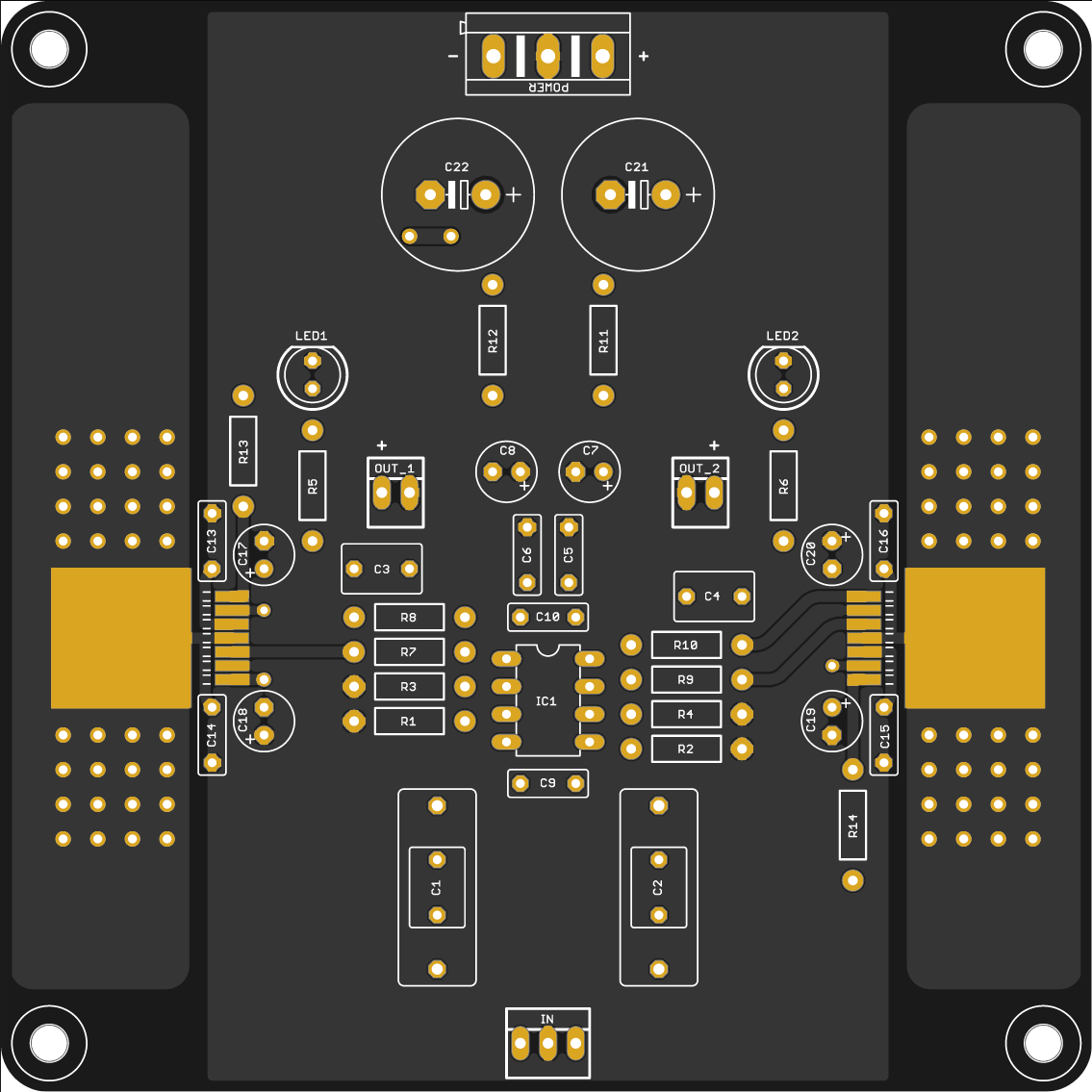

Here's my first attempt. Op amp is socketed for easy rolling. 10 x 10cm

It's bigger than the prototype board. The 100uF caps should also be more proximate to the buffers. I can't tell anything about the thermal pours for the buffers, but generally vias are placed directly under the pad to the bottom side board as the thermal efficiency falls off as you move away from the pad, especially with normal thickness copper, and having both sides acting as efficiently as possible as heat sinks is essential. Heat sink areas on each side bigger than about 1.5 sq ins. are essentially pointless with 2oz copper. The 100uF caps are long life, high temperature varieties in order to maximize their lifetime in close proximity to the buffers.
I'm not a fan of opamp rolling. You can do it you want, but unless you want to use a decompensated part and add the circuitry to make the loop think that it's operating at a higher noise gain in an appropriate region to stabilize the loop, I wouldn't recommend it. Most other opamps will exhibit degraded specs in this application, and many will be unstable or exhibit other pathologies.
In any case, I don't intend to critique this further.

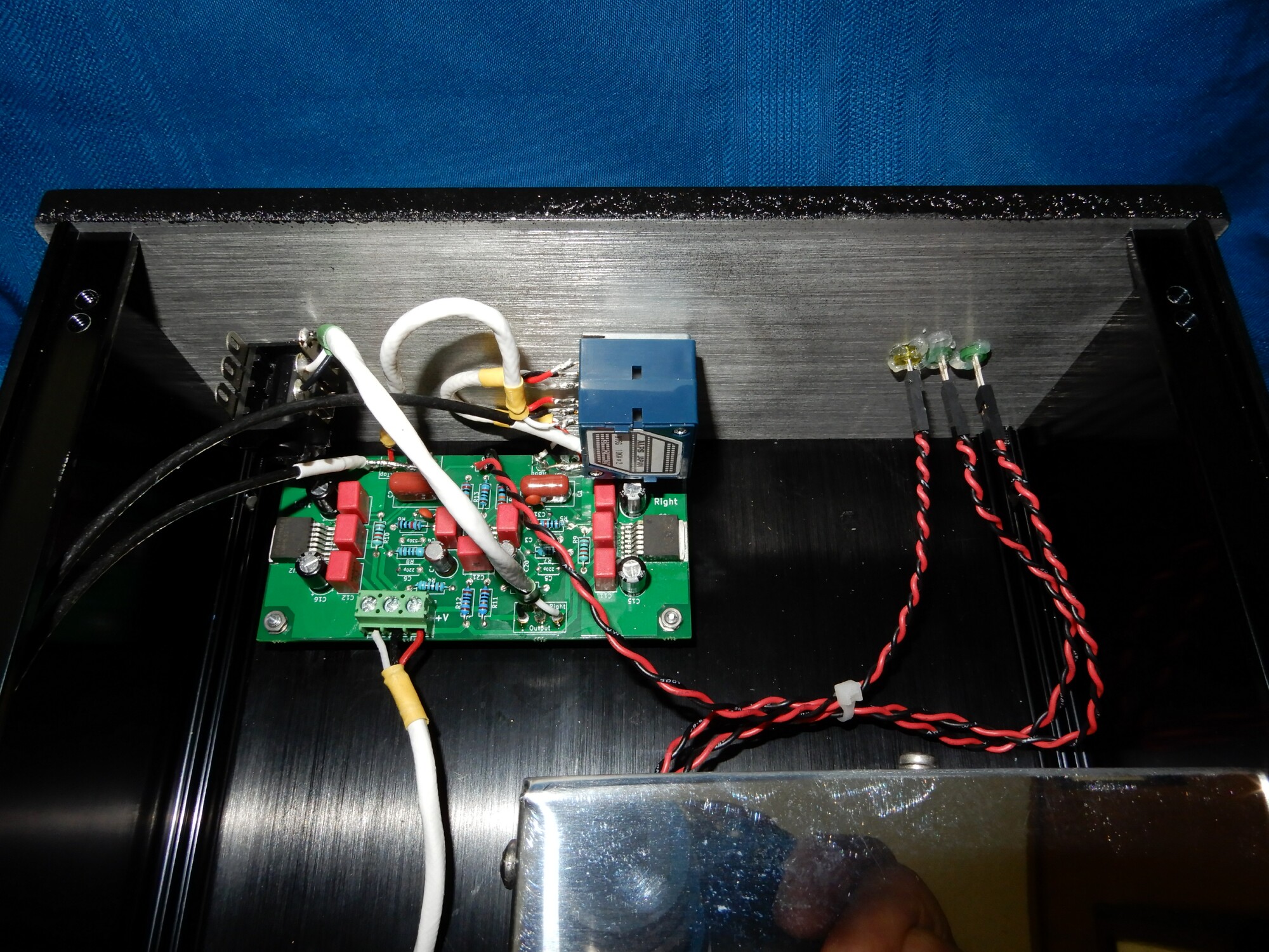

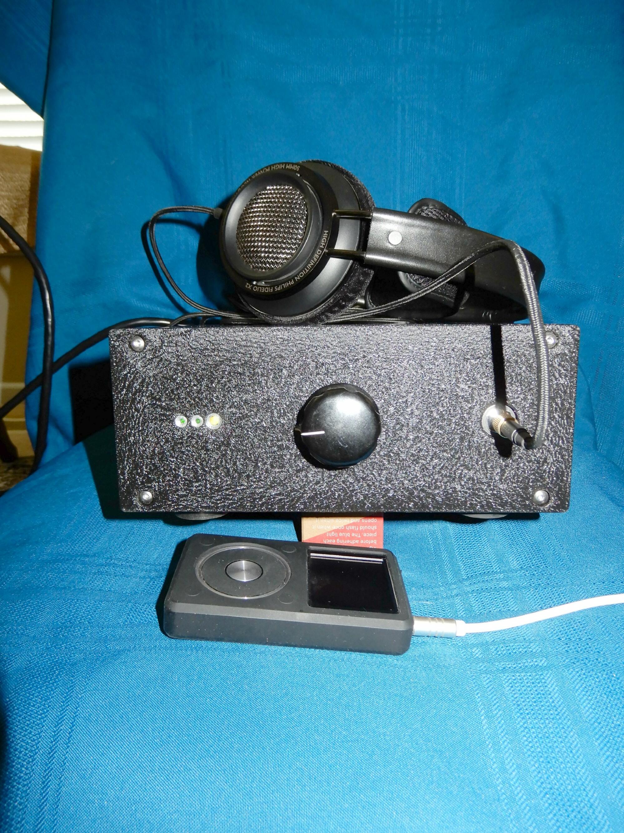

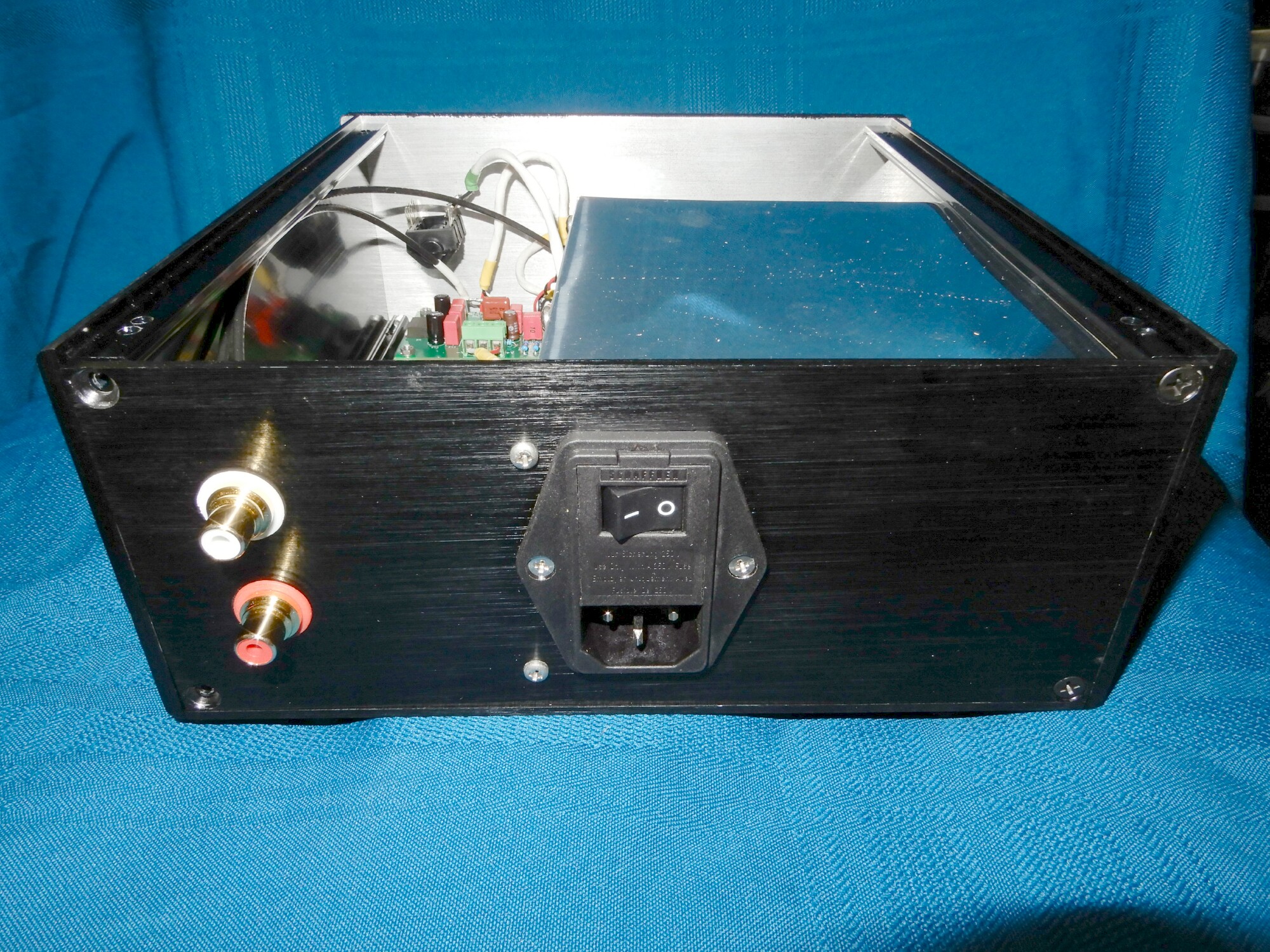

Completed Wyn Palmer headphone amp
It really does sound fantastic! Extremely detailed, in fact - so much so I'd like the ability to roll off some highs for some recordings, but it is really dynamic, clean and quiet.
My original layout induced some PS noise, so I rearranged the board, made a cover for the PS enclosure I made, and re-routed all signal cables and the power wires. It is now so quiet it has to be turned up full blast to catch even a hint of electrons buzzing around. If I had played music at that level I'd be deaf.
In fact, it is so powerful I can't safely use the line jack on my Fiio hi-resolution player - have to use the volume-controlled headphone output jack.
I went retro-look; it is rather anachronistic to listen to 2-channel stereo in today's world, even more so to listen at home through headphones while, heaven forbid, reading! Went with wrinkle black on the front panel to match the old ham radio knob from my father's gear. Two green leds are power indicators - one for each rail, and wired for very low current draw. Yellow fault indicator is just to the right. Everything would have fit in a 1 - 1.5" shallower cabinet, but this is what I had on hand.
Yup. I have a few different template sizes that I work from. Makes screwing them down on my bench easier.
Trace length is around 4.7mm from the 100uF buffer caps to the 100nF caps. I'll see if I can get em closer.
There are vias under the pad but for some reason they didn't render in the image.
If this goes to fab it'll likely be 1oz.
These will be Rubycon YXM caps (or similar).

Not a matter of offense, it just isn't particularly convenient at this time.
However, having said that, the caps you have chosen are fine. I don't know why you wish to change the BOM, but it's your choice. Also, with lower weight copper, making the pours larger has even less value. Stick with 1oz, <=1.5 sq in copper per side.
