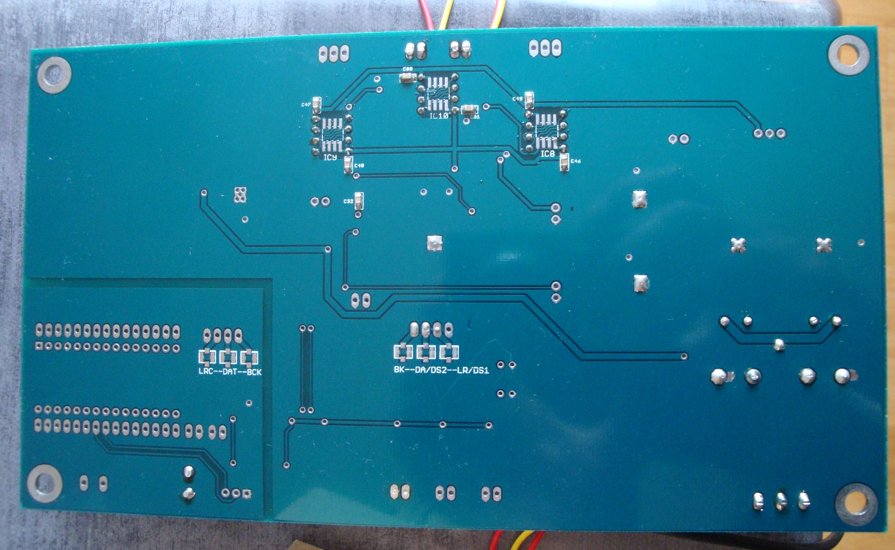

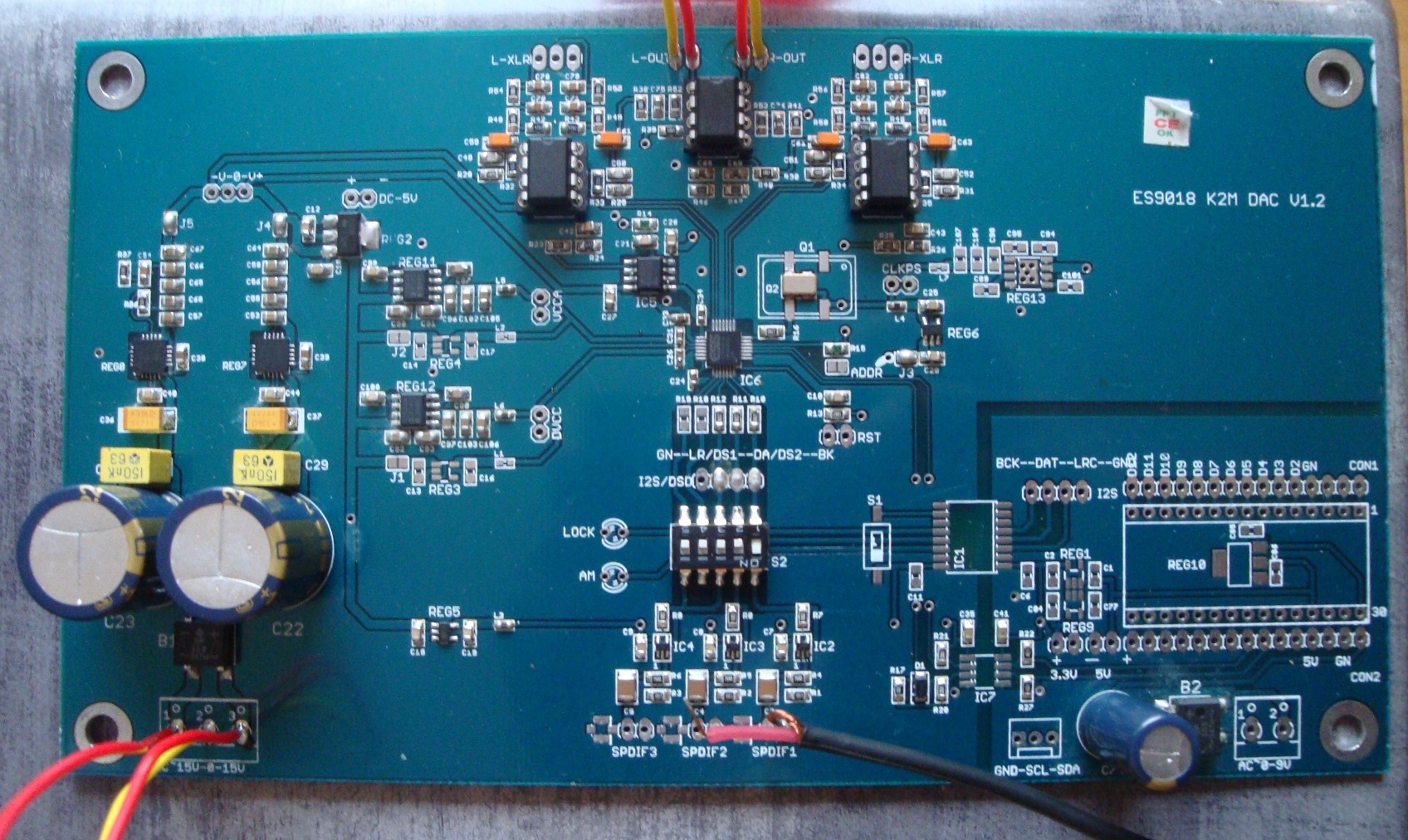

This is a bottom and top view.... with this components, the DAC works, however not perfectly:
- The sound cut sometimes during playing and I don't really know why!
- When the DAC switched on during an spdif flow ON, I suspect the HC1GU04 gate which oscillate. The spdif flow should be off during switch on the DAC.
Perfect, this is just what am looking for 🙂 many thanks for posting (for freeman too).
are you going to put MCU and other components too in future? Am a noob and still not clear whether this board works as stated as designer might not have tested with all parts populated on this version of DAC.
