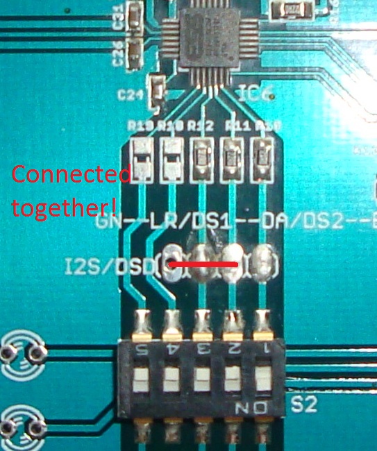

I'm myself looking for a half decent PCB for the ES9018K2M, but this one doesn't seem to be it. From what I can see from the pictures, some return paths to the GND pins are long and sometimes almost funny: luckily there are for example the ground connections of the lock & AM LED's to make the connection to the bottom groundplane for one of the two DGND pins and decoupling of the oscillator is simply bad: ground and supply are connected each through a via and total loop is to be measured in centimeters...(scratch some paint and get C32 to the upper side). The ground return between DAC and oscillator is very long. I would also have used the thermal path underneath the chip for a low inductance connection to the bottom groundplane, but that doesn't seem to be the case. Ground is probably bouncing in some places, I would get the drill and add some via's around pin 1 and pin 20... or go with the pcb from DIYINHK (what I will probably do) if nothing else comes along
Have had a careful look at the grounding, and the above is good information - the grounding indeed is pretty bad. The good news is that it's all fixable with some mods to the PCB, which should quiet down the ground and reduce RF emissions. Whether these makes any difference to any lock issues or sound quality remains to be seen.

Thanks. Looking at the initial layout (http://i1301.photobucket.com/albums/ag103/audiodesine/IMG_5763_zps61f084ce.jpg and http://i1301.photobucket.com/albums/ag103/audiodesine/IMG_5784_zps02fe8123.jpg), overall ground was slightly better (although ground return of C21 is bad, ground should be on the top side to be close to the DGND-pin and ‘RST’ RC should have been moved more downwards to leave a wider trace to the second DGND-pin). Ground was partially messed up with the powersupply changes and the data lines from IC1 in this design ‘upgrade’. You don’t want noisy grounds, what would otherwise be the use of a clean power supply, good oscillator and all that stuff? I might start a pcb of my own, but the pitch of the dac is so narrow I won’t be able to etch it myself :-/ If you use I2S/DSD , improve the connection to DGND above the IC6-label: I would put the GND of the I2S on the right side of the connector and make a bridge over the reset line. Then there is the oscillator ground… well, this is DIY after all.
At the moment I'm looking at 3 vias, 2 near the DAC chip and 1 for I2S. A via at pin 1 should take care of the clock return. Would be useful to know if the ground pad of the DAC is connected to pins 1 and 21.
