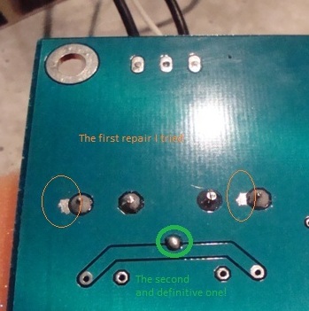

It's may be because the PCB is false!
A connections to ground of the C22 and C23 missing!
I just try my dac board with only tps regs plugged and I measured first, -12V and 2V at ouput... After looking the schematic, I don't believe myself to that huge error.
I have scratched soldermask and made contact and know I have +12V and -12V!

Do you have a pic of the repaire?
There were a bunch of Indians who got the boards first who reported successful builds and favourable SQ... You don't have a closeup photo of the board. That should reveal if the trace was there. Does it show on the photos syllable or someone else uploaded...

They also built it in 1 day which is slightly fast. Well it seems this will be a long build for the others... I can't help but being an amateur I had to laugh about this professional error, sorry 😉
So the first builders forgot to mention it...
Yes, checked my board - there is no connection to ground 🙁
Oh well, Just tested mine with multimeter, what you've said is true!
Will perform your green circle mod.
Thanks for your findings!
