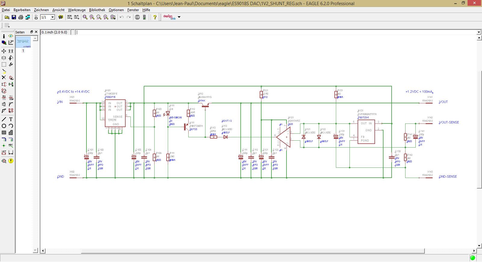

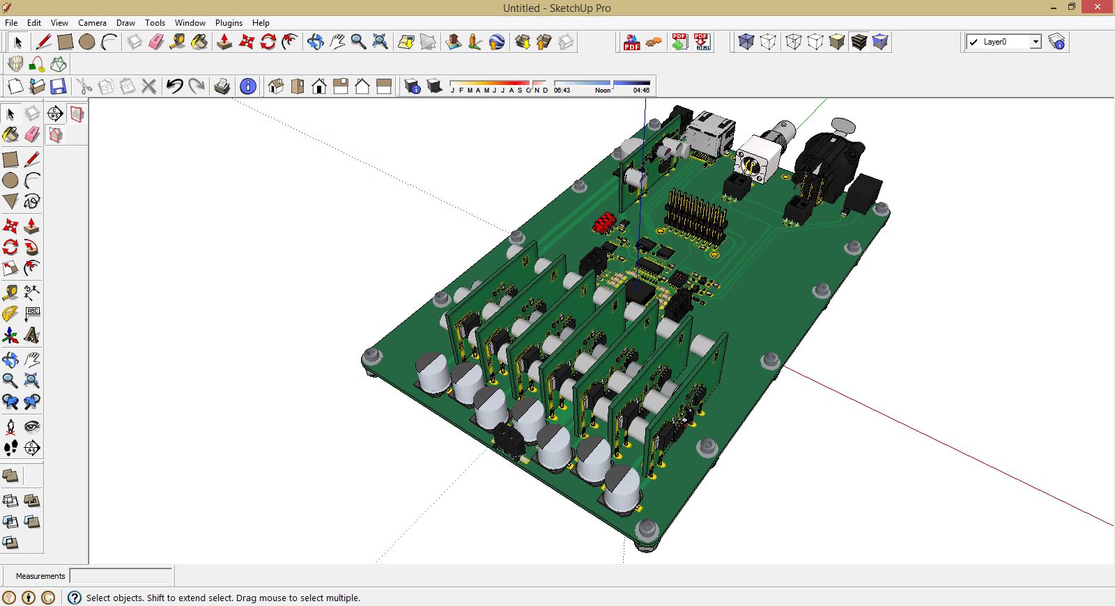

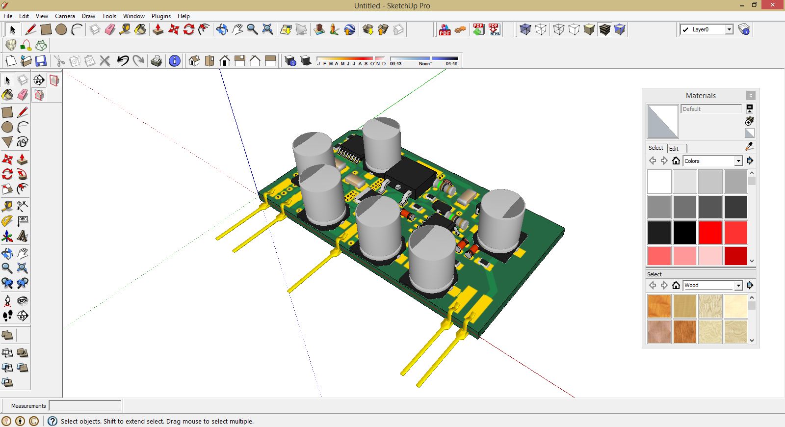

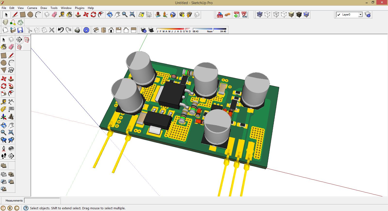

Working on my own DAC (started last year):
- LiFePO4 powered
- Amanero USB to I2S module
- Raspberry I2S interface (needs add-on card for differential driving)
- SPFIF copper and fiber interfaces
- AES/EBU interface
- isolated SPI communication interface for micro/TFT
The shunt regulators for 1.2V and 3.3V and first routing DAC board (to change).
What do you think about the new AKM AK4495SEQ?
