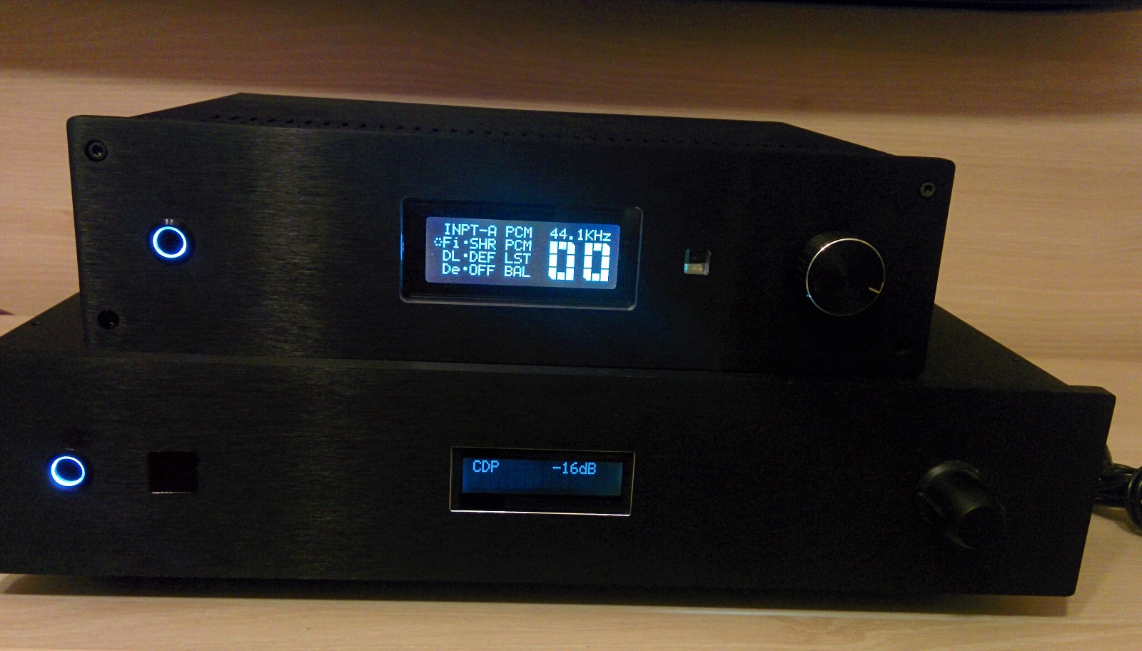

This is my almost finished DAC discussed in this thread. I added some more preregulators and i'm trying to find a good grounding scheme for everything inside the case.
The most annoying problem is when i'm electrostatically charged and discharging on dac case my microcontroller goes crazy and display shows
hieroglyphes.
I will go in details with my final configuration if there are still interested people in this subject.
