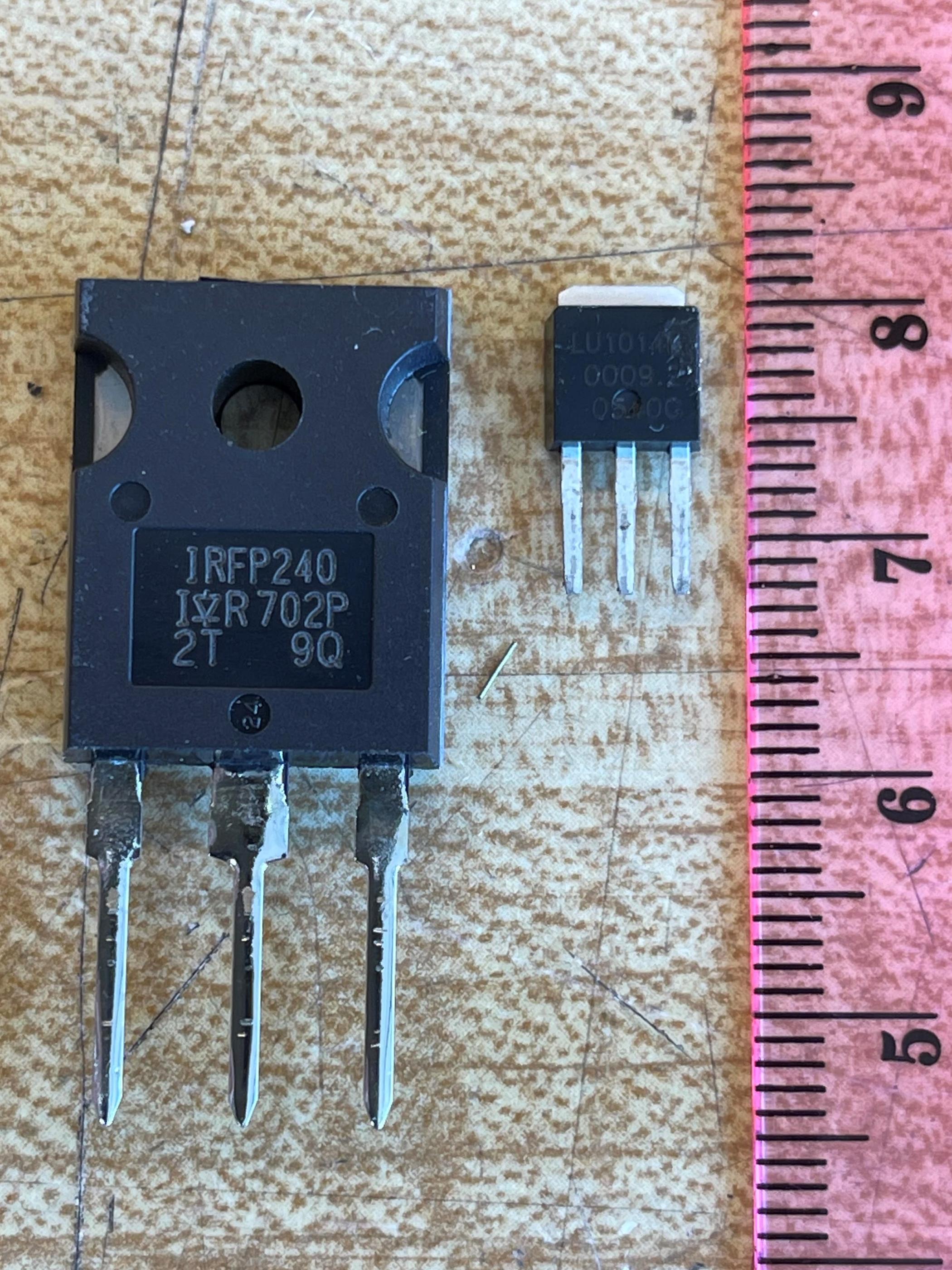

If you haven't seen an LU1014D, I've attached a photo with an IRFP240 for comparison. They are tiny.

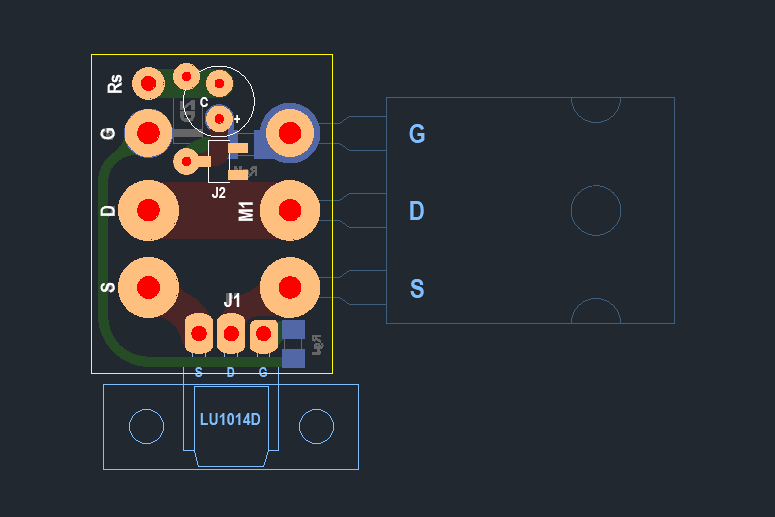

And you can use existing J2 or Aleph J PCBs.
Just need a small adaptor board for the LU1014 triode cell.

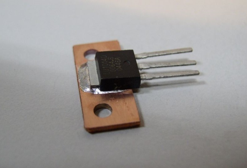

IMHO, there is no need to use a 3.2mm thick copper plate as heat spreader.
Even the normal TO220 devices are only 1.3mm thick.
The gain in thermal conductance is of diminishing return.
And it only makes soldering more difficult.

For an adapter board you could use glue/epoxy just as well.
An arctic silver epoxy for example isn´t too expensive and has good thermal properties. I used it for mounting some high-power LEDs on a 10mm thick aluminium strip and it just works like a charm.
At work we use Epotek H20e or similar epoxys (typically also used for LED mounting) with very low thermal resistance but that stuff is expensive and impossible to get in small quantities.
(besides it has to be kept in a freezer and needs a curing at 120° for at least 20min.; not very practical)
Epotek H20e has a thermal conductivity of 3.2W/mK.
SnAg solder has a thermal conductivity of 78W/mK.
https://www.epotek.com/docs/en/Datasheet/H20E-PFC.pdf
Thermal Conductivity of Solders | Electronics Cooling
Assuming the LU1014 is used in a power amp with 1.2A bias.
After cascoding, it will see a Vds of ~3V, or 3.6W.
It has a thermal pad approximately 6x7mm, or 42mm2.
Further, assuming a glue / solder thickness of 0.2mm.
From the above, the temperature drop across the Epotek comes to 5.4°C.
That of SnAg solder comes to 0.22°C.
I know which one I would use.
Patrick
Patrick
OK. At only 3.6W and a huge pad of 6x7mm its "almost regardless" what you use. I thought we were talking 40W/chip.3.6W
Our chips have up to 4W on 2mm² and yes they are glued with epoxy.
Sometimes even not directly on metal but on the PCB first, thermal vias and then the PCB is epoxied on to an aluminium carrier.
All I can say is it works very well and most products are qualified to mil-std.
But yeah, if you can, use solder. No extra costs and other hassles.
