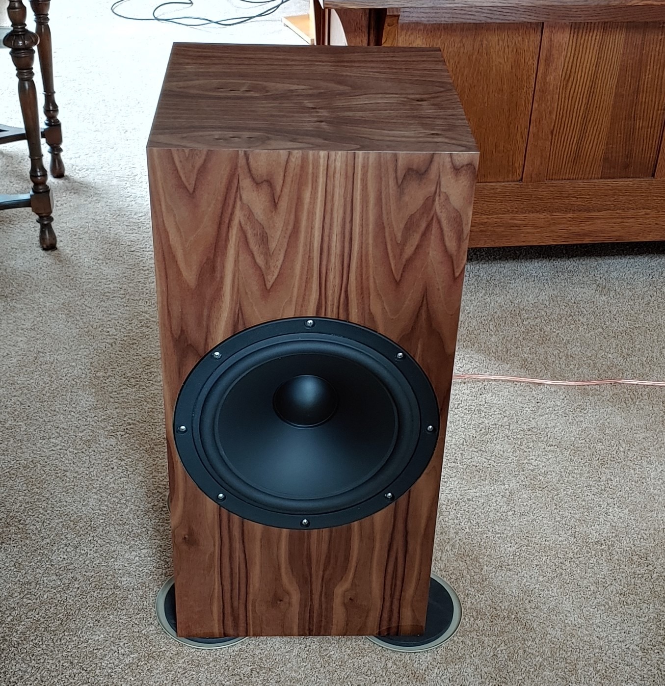

Do not fear the word "subwoofer". It simply means a bass speaker that is designed and optimized for the range from ~ 120 Hz down to the limits of the driver/cabinet... but typically most subwoofers extend down to at least 30 Hz. Good subwoofers sound excellent with classical music, acoustic music, live recordings, etc. If it sounds boomy, buzzy, or unnatural, it is not well integrated, or poorly designed, or poorly built.
Attached is a picture of my woofer cabinet. It is an SB34NRX75 in a 70 liter cabinet. There are two cabinets, left and right. It is an active system sealed box system. It uses a bass equalization technique called Linkwitz Transform, and I have bass extension of -3dB at 30 Hz, and -10 dB at 19 Hz. I currently cross over to the main system at 200 Hz, so technically, this is not a "subwoofer", but more of a "woofer".
j.
Reactions: Silvio Novais
🙂 I intended to do the same but only with the SB34NRX75-6
