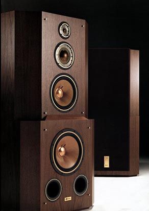

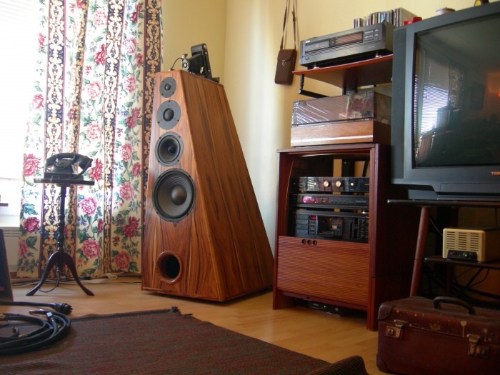

The closer you can come to a 4345 is a Troels Gravesen's TL1.
Won't come cheap.

I'm just finding TL2The closer you can come to a 4345 is a Troels Gravesen's TL1.

http://www.troelsgravesen.dk/The-Loudspeaker.htm

TL2 or TL3 are effort to make smaller box.
The description of TL1 is interesting as it gives his own vision of the 'recipe' to this kind of loudspeakers .
