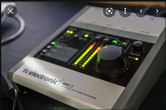

Yes the volume control will be a nut to crack, you don't want a youtube add, by accident, run flat out on a 200w amp 😀
Otherwise a very good solution with the player inside!
I run a BMC-2 to my Open-DRC-DA8 just to get the feeling of a volume.
