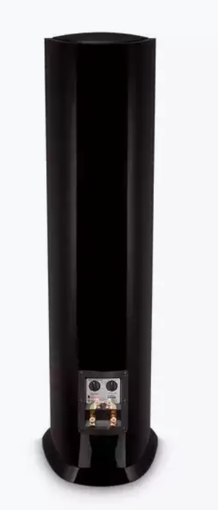

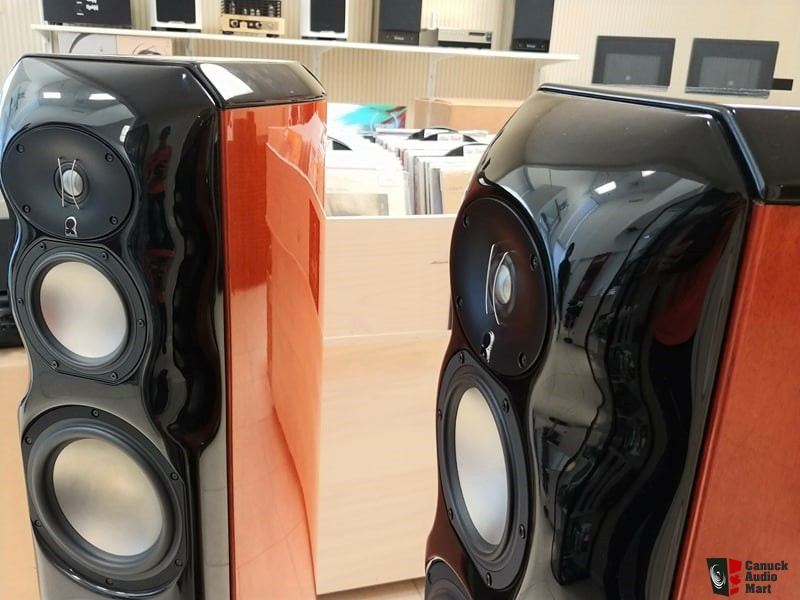

Lo and behold, using a massive roundover on the baffle, like in the Revel Salon 2, doesn't improve the curves as much as I'd expected. The curves ARE more consistent, but they're nowhere near as smooth as the very wide baffle.
Here's the published polar measurements, which reflect a similar level of raggedness, so I guess the predictions are relatively good.
I was hoping for a return to those silky smooth curves that the wide flat baffle yielded, but so far, it doesn't look possible.

I wouldn't toss the baby/bathwater combo quite yet. A hard look at pictures of the Salon 2 shows
1) there's a serious lip around the tweeter waveguide, which could mess up response from reflection at the discontinuity, and
2) the roundover, instead of starting at zero degrees for a smooth transition from half-space to full-space, seems to start at about 45 degrees, which might also trash the response.
Both those issues at almost the same distance from the tweeter would tend to reinforce their vices.
Zaph was surprised at how even a 3/4 inch (19 mm) roundover smoothed tweeter response, so one could argue the problem here is execution, not principle.
