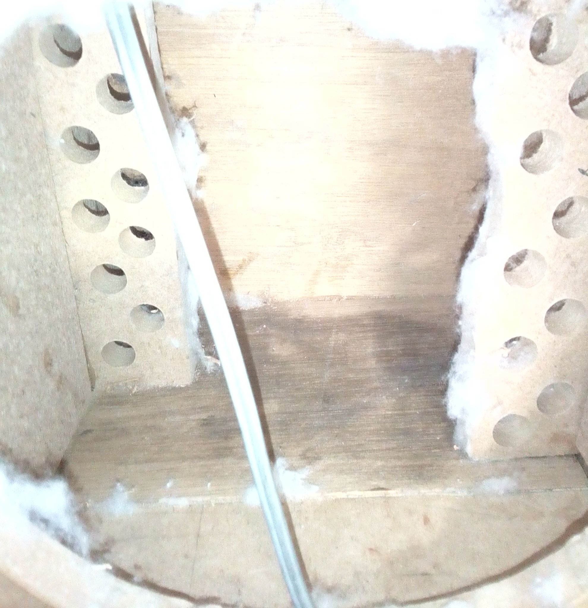

After I had written it, I remembered "holey braces", and was going to edit my post, but I couldn't remember who had posted the idea.That sounds like my Holey Braces. Add a bit of dampimng (lower density) over the holes toincrease resistance/damp down harmonics.

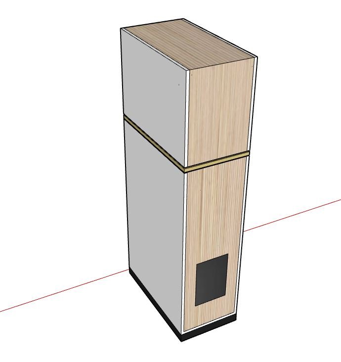

Now, once upon a time I did an experiment on a closed enclosure, I took all the damping materials out side and instead placed a large pvc tube filled with insulation directly behind a large 10inch midrange. For my surprise I could hear a clear upgrade. Since then I am more careful with damping materials and more searching for this magical diffuser and it's interaction with closed cabinets.
In my experience, damping is killing dynamics.
What I would like to creat is a closed box that can simulat an open baffle clarity.
I am not sure about the practicality of this experiment but it sure a lot of fun to think of

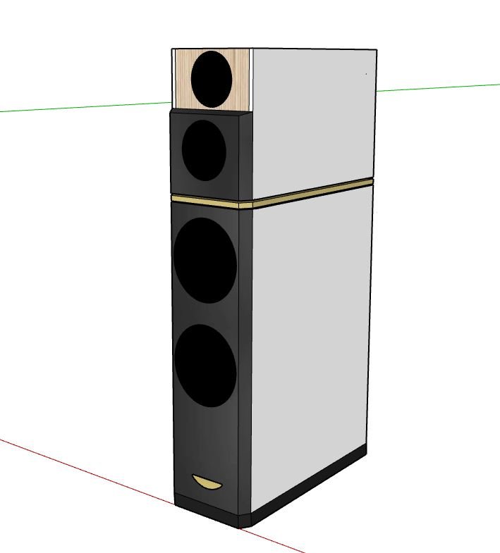

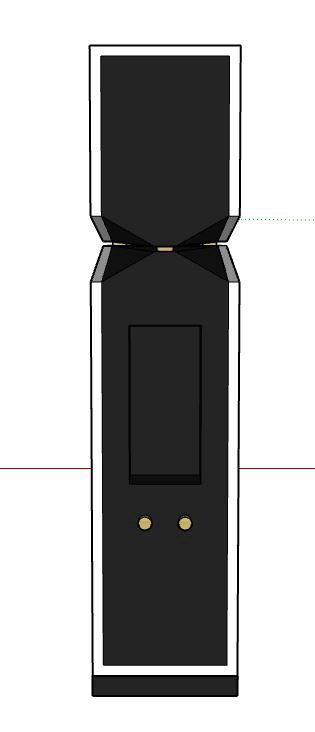

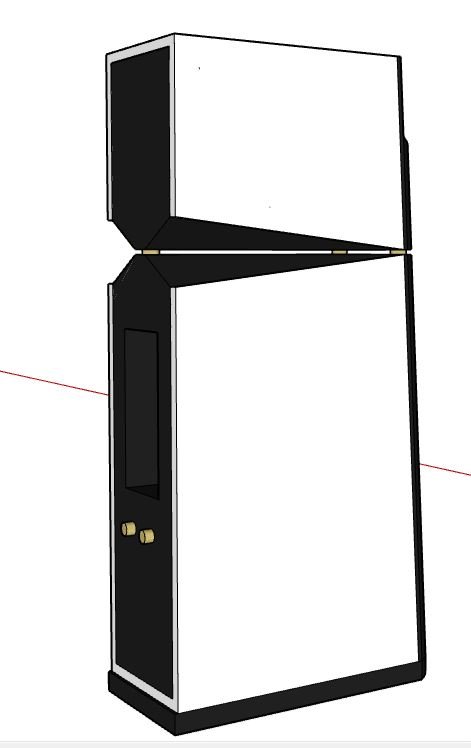

I am more fixed on the loudspeaker Id like to build. the CNO Grande from Troels Gravesen...
http://www.troelsgravesen.dk/CNO-GRANDE.htm
I have the design pretty much fixed. to me it looks a bit like a Stenheim speaker.

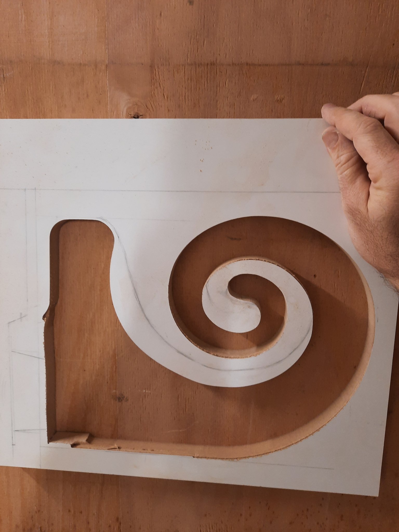

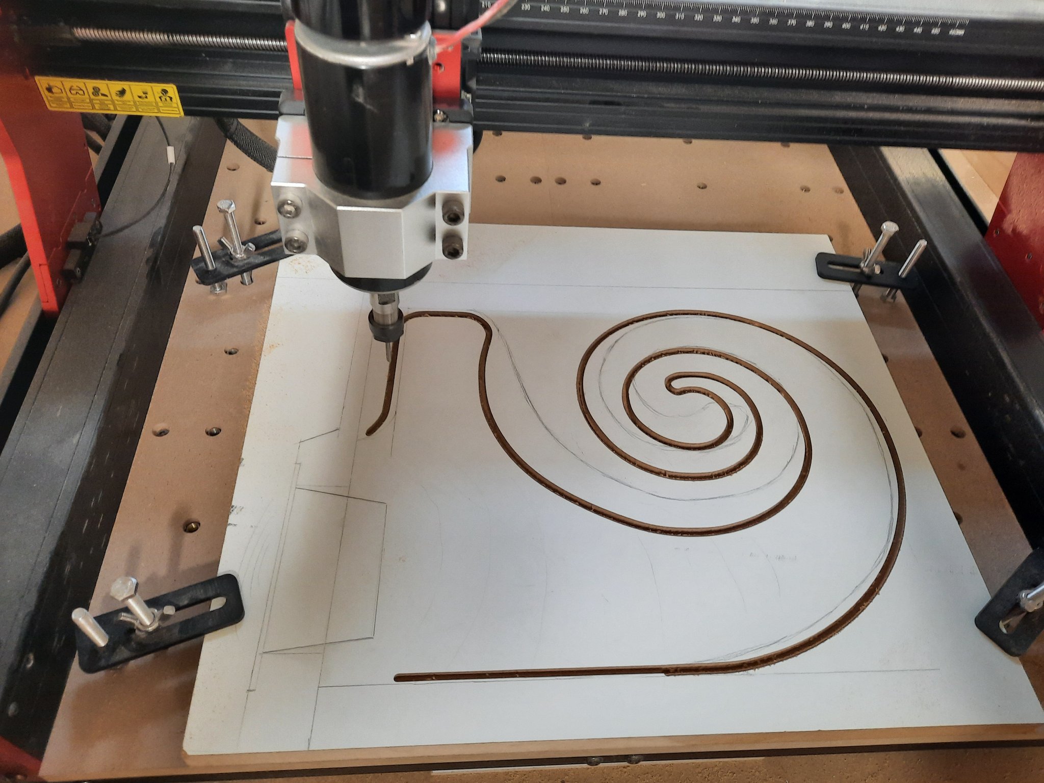

what about the spiral in the picture below? could be a nice experiment.

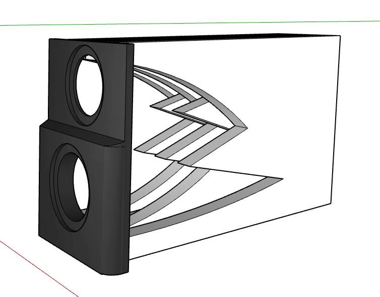

Or maybe this???
+1 for this design. I really like the lines.
Extreme case in the other direction - extremely minimalist holey braces. I'd forgotten how minimalist they were until I took the driver out for the picture, they seem to be effective though, perhaps helped by the considerable quantities of cotton wool stuffing that was inside
