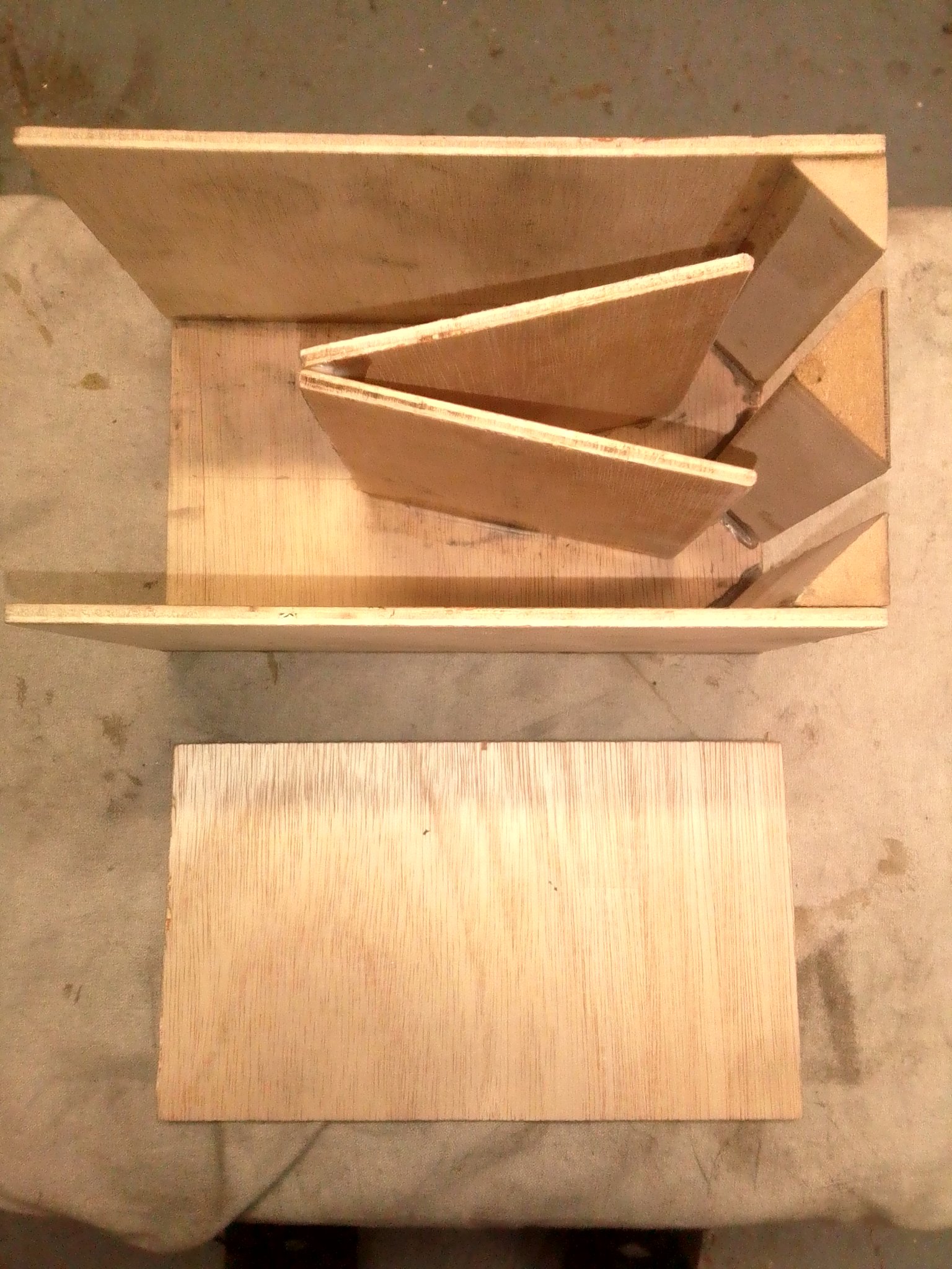

Thank you guys for All the repleys!

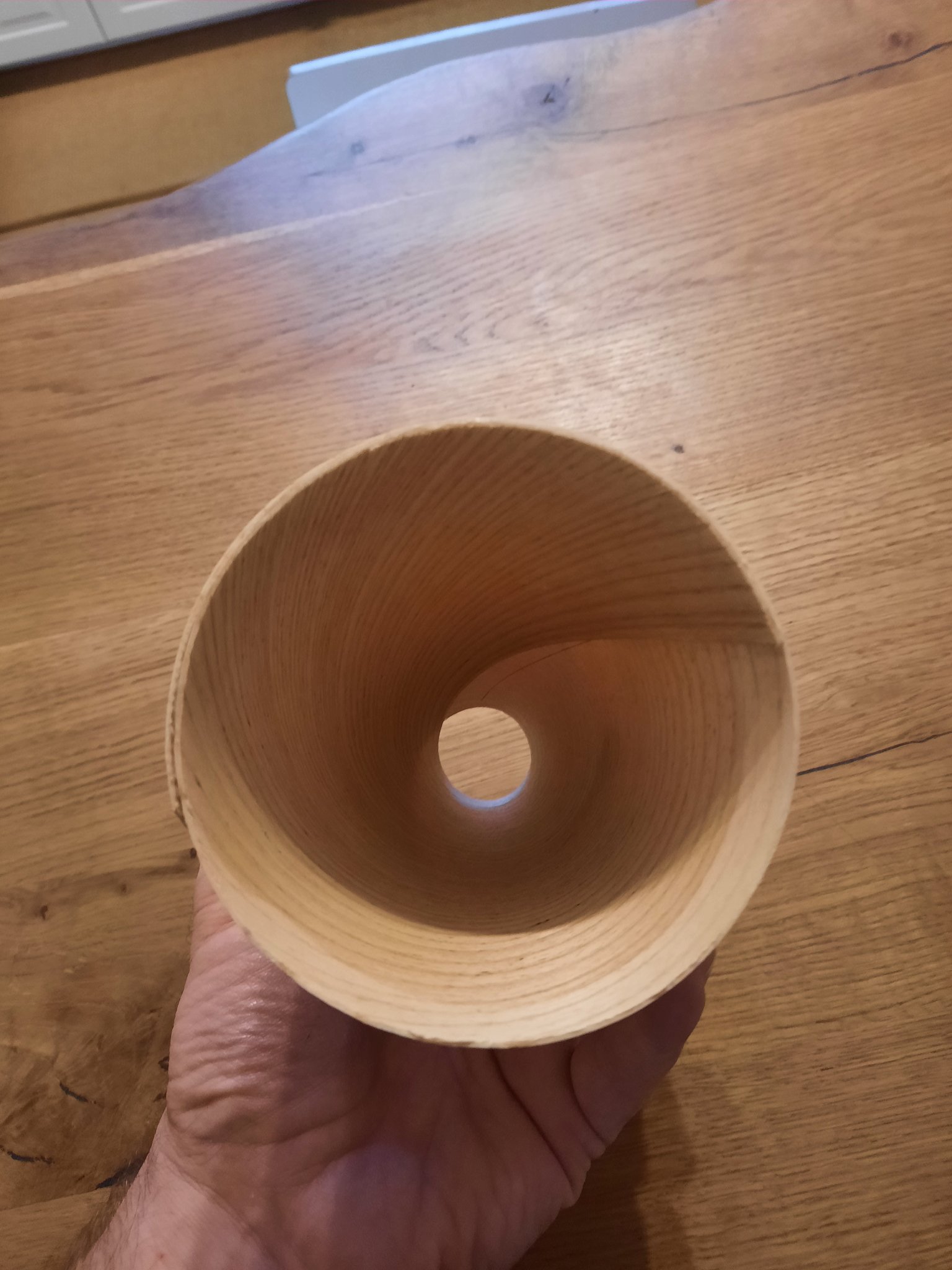

I have decided just to go and try. I literally cooked some veneer in hot water so I can bend it easily (my wife being very patient as always 🙂 and created cones. I will stuff them to certain degree and place them all over the place. Especially behind the driver.
This looks great, probably the most effective I've seenView attachment 1366444View attachment 1366445

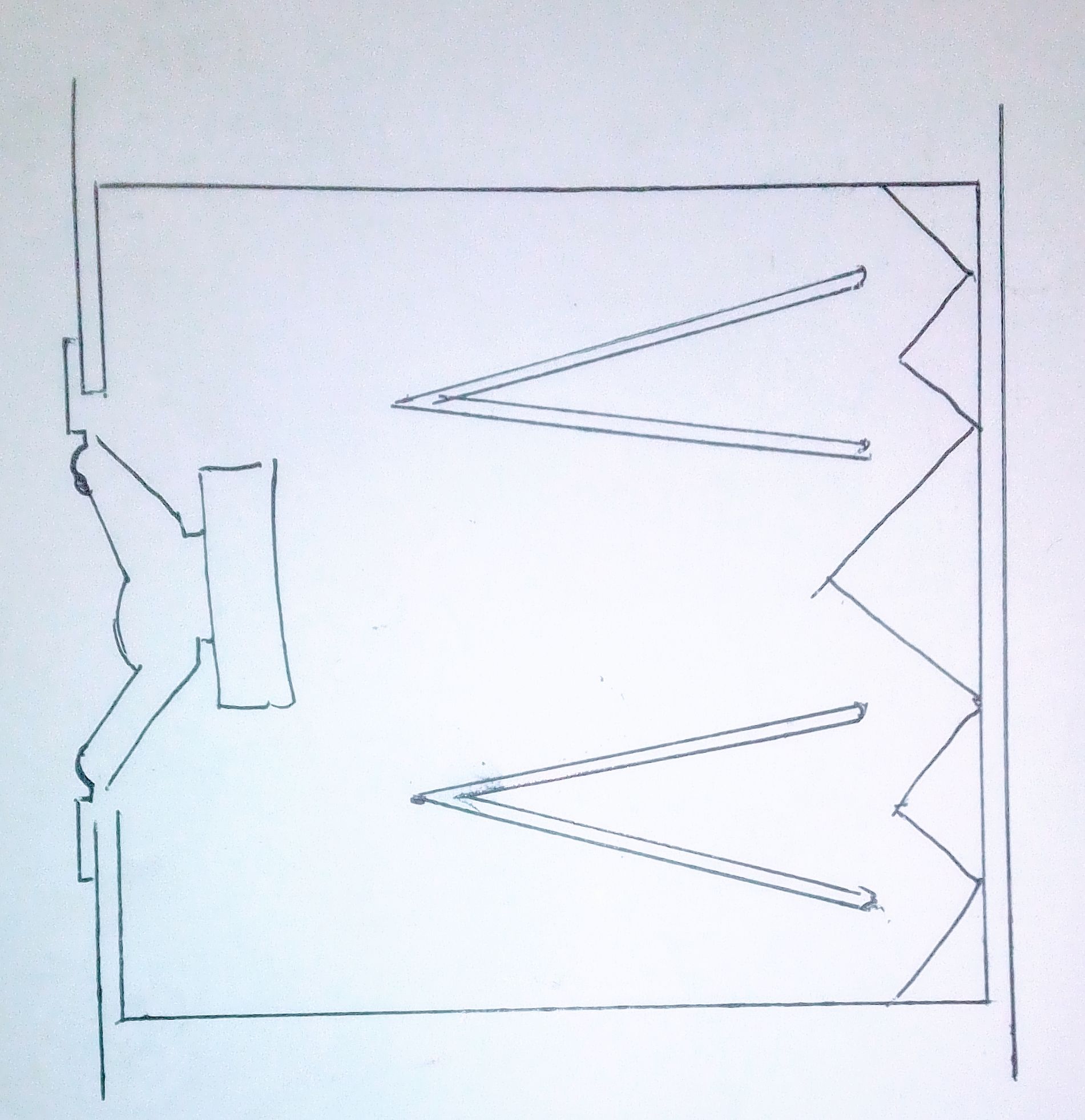

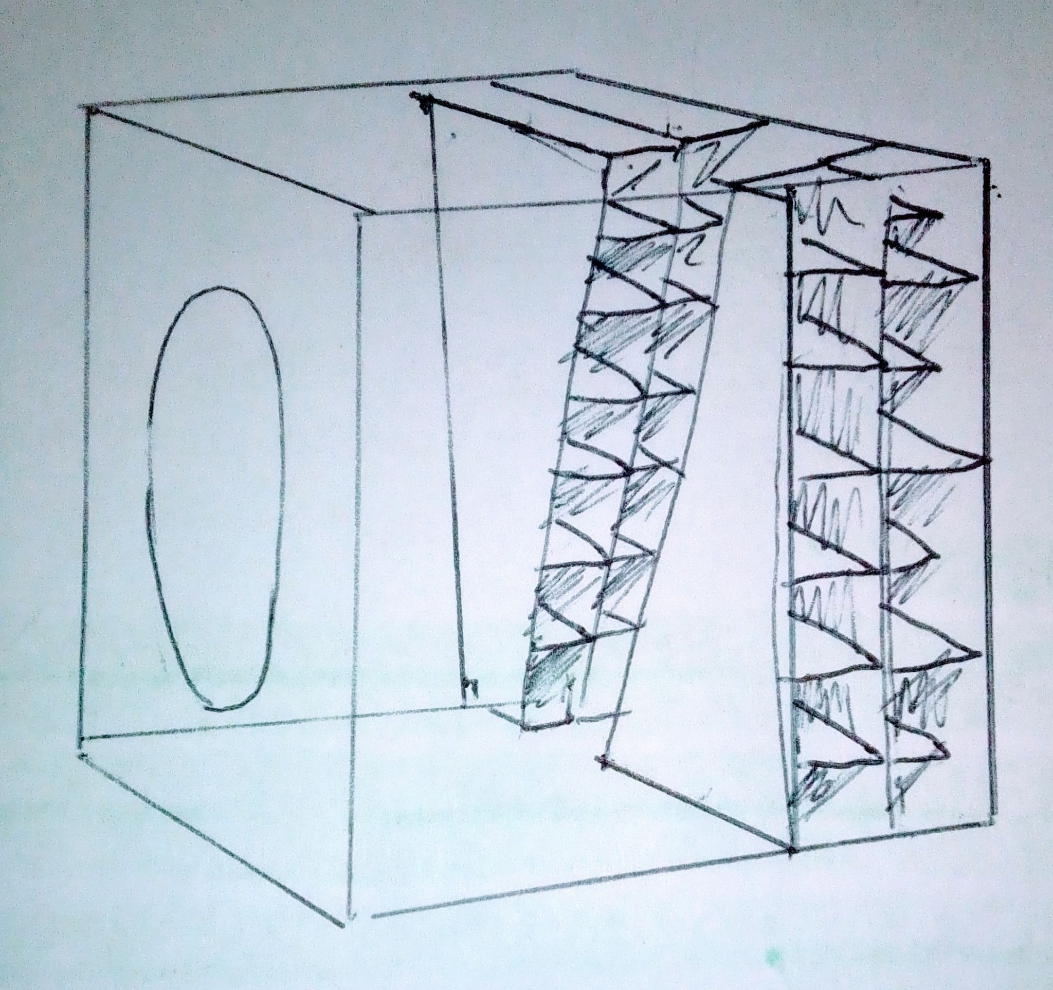

To be honest, you're starting of with a cube, which is not the best starting point; I'd go for a double V diffuser (drawing), going from one side to the other, much like the single V diffuser (picture).
I did use a cube enclosure many years ago, and found different types of foam, in different layers worked well; however some experimentation was needed to find the best combination/order of foam. If memory serves my right, the first layer was a course open cell foam, followed with a finer foam against the rear wall. I may have used cotton wool as well.

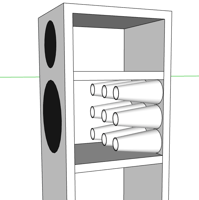

Is there any argument to be made in favour of utilising a an internal soundwave diffuser within an enclosure to break up standing waves or to any other benefit? Just to be clear, a diffuser role is understood not to absorb soundwaves, but merely change or sufficiently randomize their angle of reflection to break-up standing waves and resonant frequencies. In a studio or theatre environment, the panels can be quite large and cover a significant area. Lower frequency waves are longer than the longest dimension of most...

I'd make all the cones different heights, and fill their insides with something absorbent.
It could make sense if the next load was stuffed and sealed, but being open what you get is called an organ.

Trying to combat the evil of rear cabinet reflection without the obvious solution-fiberglass or sheep wool.
Will it work? what do you think will happend?

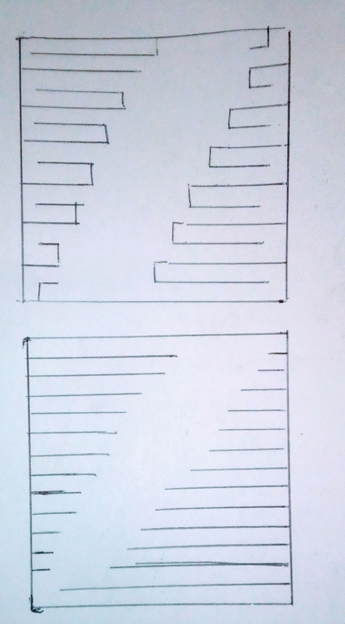

Of course, you could always make your own midrange "meta" labyrinth, like the tweeters of some KEF tweeters. Perhaps collect some wooden drink stirrers from fast food restaurants, and glue them in place at the back of the enclosure, then add baffles over, then anouther layer. I've drawn two layers, but you could have a few more. Some people have 3d printers, they could print off a labyrinth sleeve that slides in.
Also thought just to stick a box with many many sticks from different angels and send them down , it will look like a magic box full of sunken swords or like a Swiss cheese
Another idea is, you could have a few dividers, with lots of hole drilled through; enough holes to let soundwaves pass through, without significant reflections, but still cause a successive resistance - so the wave will emanate from the rear of the cone, pass through the first divider, losing some of its energy, pass through the next divider, losing more of it's energy, bounce of the rear of the enclosure, pass again through the second divider, losing still more of it's energy, then again through the first divider, if there is anything left. Unfortunately, this design might dampen the movement of the cone, although if the first divider is half way down the enclosure, it shouldn't be to bad.
That sounds like my Holey Braces. Add a bit of dampimng (lower density) over the holes toincrease resistance/damp down harmonics.
