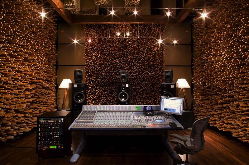

The conversation appears to be pursuing various related ideas to what I had originally intended to enquire about. Imagine please the walls of the enclosure, which is curved, not rectangular, with a surface resembling a vastly scaled down version of the studio image below.
What could the effect of a such a randomized surface with relatively small peaks and valleys be?
