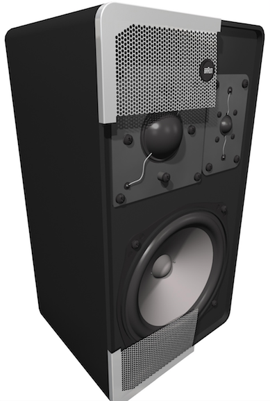

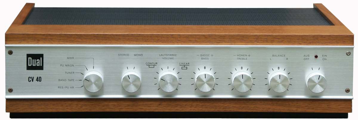

I came across the Dual and Braun while looking for Dieter Rams designs. I think the packaging is excellent and if the outside is nice then following form/function the circuits must have sounded heavenly.. Simple and functional no more no less.
So I study the early designs. Braun, Dual , Telefunken, Philips and so on. I'll have to look at Grundig. Many companies attempted to copy Dieter Rams but it usually did look like a style copy, not quite correct. The early Sansui circuits are also interesting but not packaging. Some circuits I have adapted to valve-opamp hybrids. It is not difficult and the fft is exactly what I want.
The images are from BRAUN, BRAUN Hifi, Braun design, Thomas-Mathias Bock, Dieter Rams,Computer Graphic,

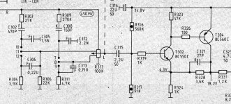

Does anyone have a circuit to make use of a tapped volume control? I have an ALPS RK27 type (probably a clone) stepped attenuator with a loudness tap, I wouldn't mind trying a passive loudness circuit on it, so that it is active at lower positions only. Thanks in advance!
This is 5 pin volume pot in Grundig SV 2000 amplifier.
Many Grundig models use that double loudness.
To copy/test the Dual loudness ckt a stepped attenuator can easily be made to operate as a 5 terminal volume control i'm thinking.

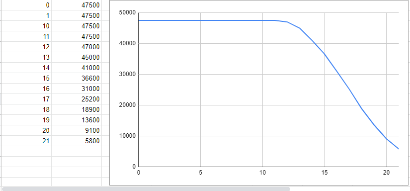

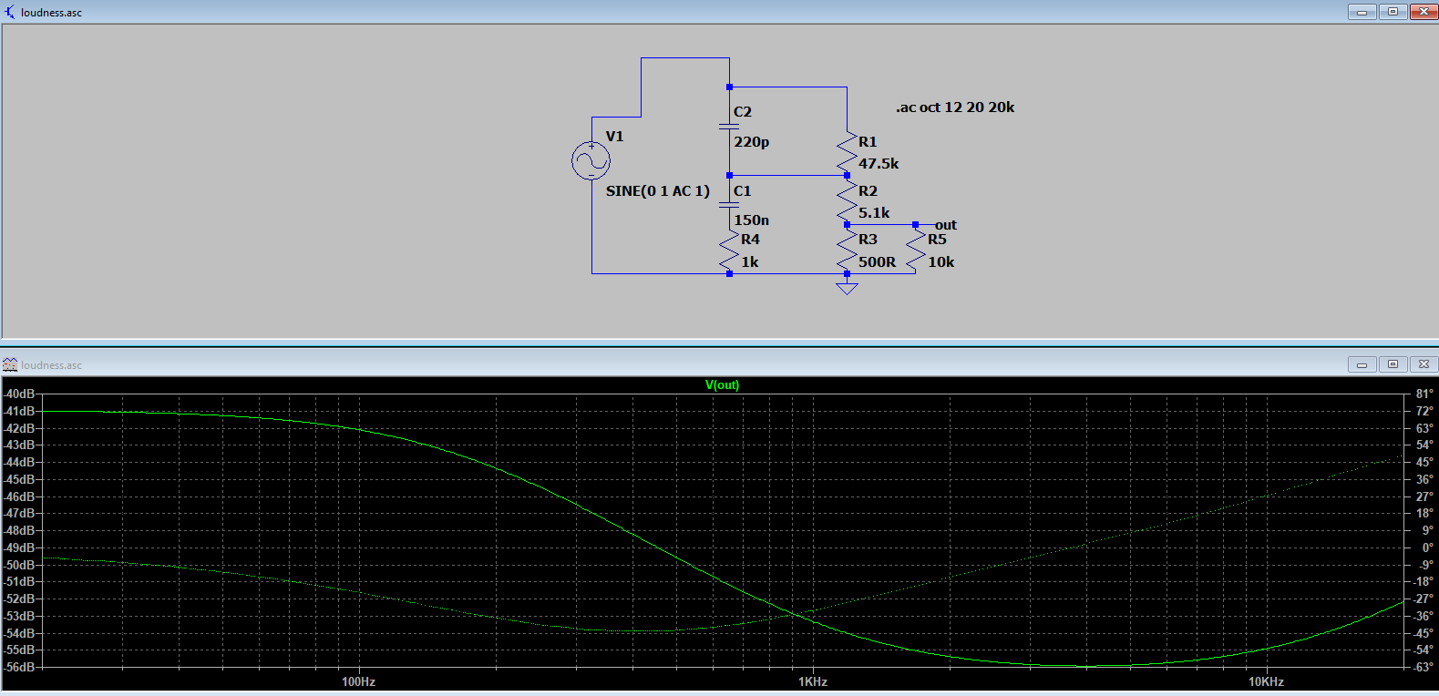

OK so in my case the tap seems to have a resistance from the input pin as follows:
1-10 : 47.5k
11-22 : reduces by ~4k each step, ending in 5.8k at position 22 (it's a bit more gradual to start, then reasonably linear until it reaches step 22)
Question is, how do I use this tap to create a loudness control? I feel like I'm missing something obvious. This is a 50k log taper attenuator.

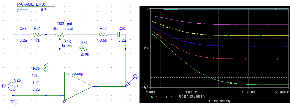

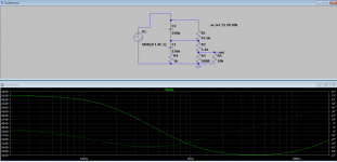

This seems like it should work fairly well for the tapped 50k. Any suggestions? Note ltspice doesn't have any built in pots so I knocked something up quickly. values based on measurements off my actual pot.
The effect lessens as the volume is turned up.

That is a step in good direction. I was thinking of testing a "volume" control like your's configured just do bass side to see if works.
The goal for sure is volume and variable loudness from one standard 10kA(or B) three terminal.
The volume cannot go to zero so would sound like muted in zero position. Who cares, then hi side is somewhat in ckt at 270 degree. But 50k is good too maybe with a 4.7k on bottom terminal and 3.3k on top. 58K total.

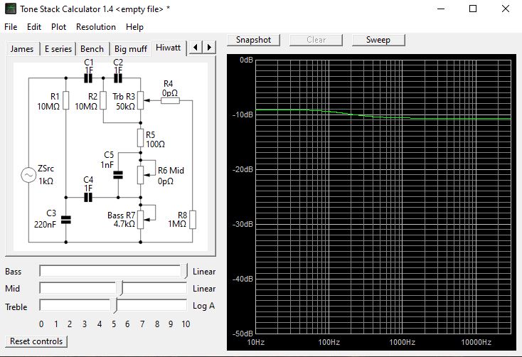

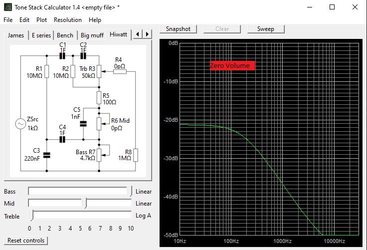

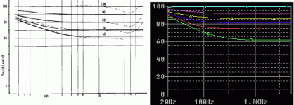

tsc simulation
I was able to simulate volume-loudness combo on a three terminal 50k log pot.
The latest free Duncan TSC can be forced to do this sim by using absurd values to eliminate unwanted parts.
R1,R2,R5-optional,R6,C1,C2,C4 and C5 are forced inactive.
These plots use the new HIWATT circuit in TSC 1.4.
http://www.duncanamps.com/tsc/download.html
The zero volume level/R7 and roll-off C3 and C3/R7 can be tweaked to change profile. Note low-Z drive with hi-Z takeoff.
The hi-side may not be necessary. I will audition this circuit.
