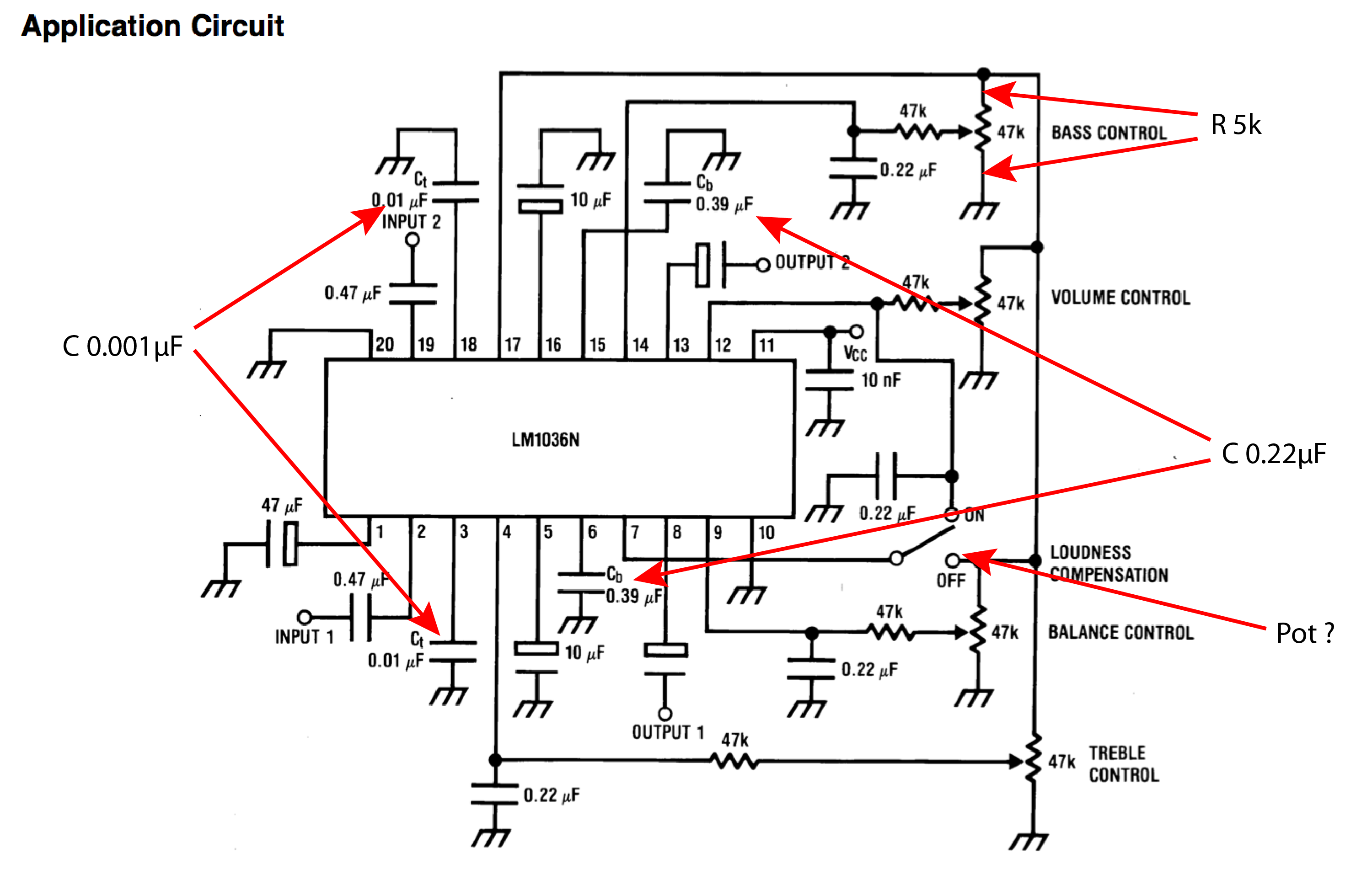

O.K. just so I feel like I contributed, here is a circuit from my folder full of ideas. looks similar to previously posted schemo's with different values :rolleyes: :2c:

The caps look OK, typical polyester film types. The use of the loudness function (pin 7 of the chip) is detailed in the data sheets. You will have to see how your board is configured to know if its used or whether its left non-functional.
I am looking into schematics and I wonder what would I get by making these modifications noted on pic...
Also, does it make sense to replace loudness switch with potentiometer in this case...?
My aim is to get nice and fat bass and bit of treble response, but in the way that I can level it with a potentiometer, if it is possible with this solution..

Interesting question. It looks as though the loudness could be made variable with a pot because all it does now is use the same DC control voltage as the volume input. So I would say probably yes, but it would be a non recognised loudness curve vs level i.e. you could apply a loudness contour to high output levels when you normally wouldn't do so.
Haven't got the data sheet in front of me but from what I remember altering those caps will change the turnover frequencies. Anything like that is trial and error to get the effect you desire.

OK, great,
as soon as I get it I'll try with 50k lin. pot in the place of the loudness switch...
BTW, when I insert bypass switch before tone board, do I need to watch out for something special, like feedback signal from amp on the output of tone board?

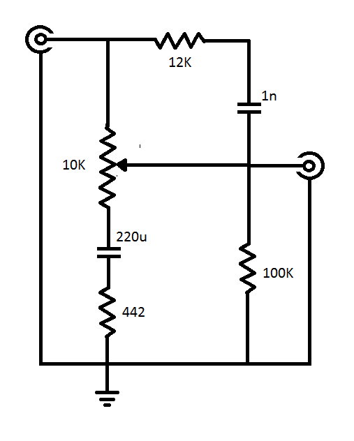

This is a passive loudness circuit that can be put on the end of a pre amp...
The effect as you turn the pot over full rotation is...
The 33k resistor is just to simulate a typical load and is not needed it will drive a following circuit over about a 20-100k range withought very much change in the frequency response.
The component values can be scaled to for instance use the 10k motorised pot widely available here in Oz. In this case just double all resistors and halve capacitors.

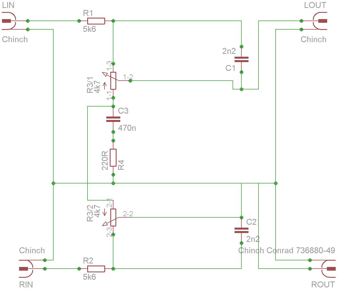

I built this circuit last night on a proto board. I doubled the resistors and halved the caps as per your instructions because I am using a 10k stereo ALPS.
The circuit works, but the effect is very subtle. Based on my ears alone, I suspect I am only pushing the curve down about 3-4 dB with the POT at max setting.
It sounds excellent, but I would like to have more variability in this variable control. Right now it is only useful at maximum setting, and just barely so.
I assume it is a matter of changing some component values but I have no idea where to begin. One thing I checked is the real resistance of the ALPS, which is much closer to 9k than 10k. Does this mean the resistors elsewhere in the circuit should have been scaled accordingly?
Thanks to anyone who would be kind enough to suggest which component values to change to simply achieve a greater range of effect, without changing the resulting F-M curve too much.

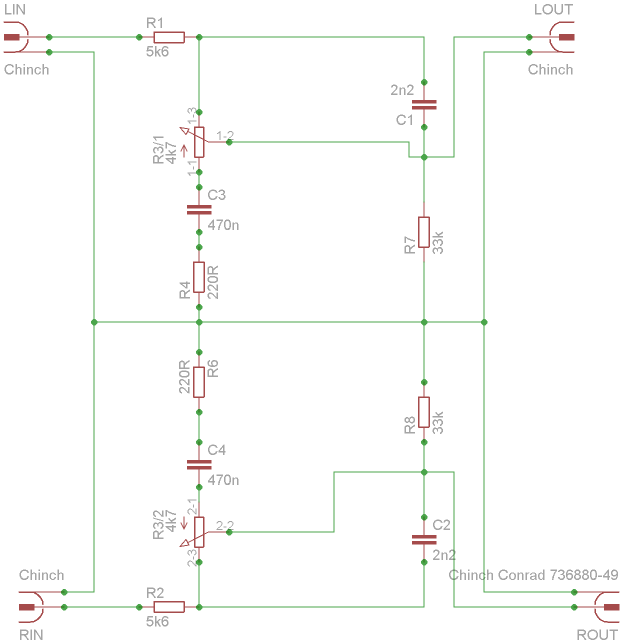

Joined 2011
So, it was a rookie electronics mistake. :)

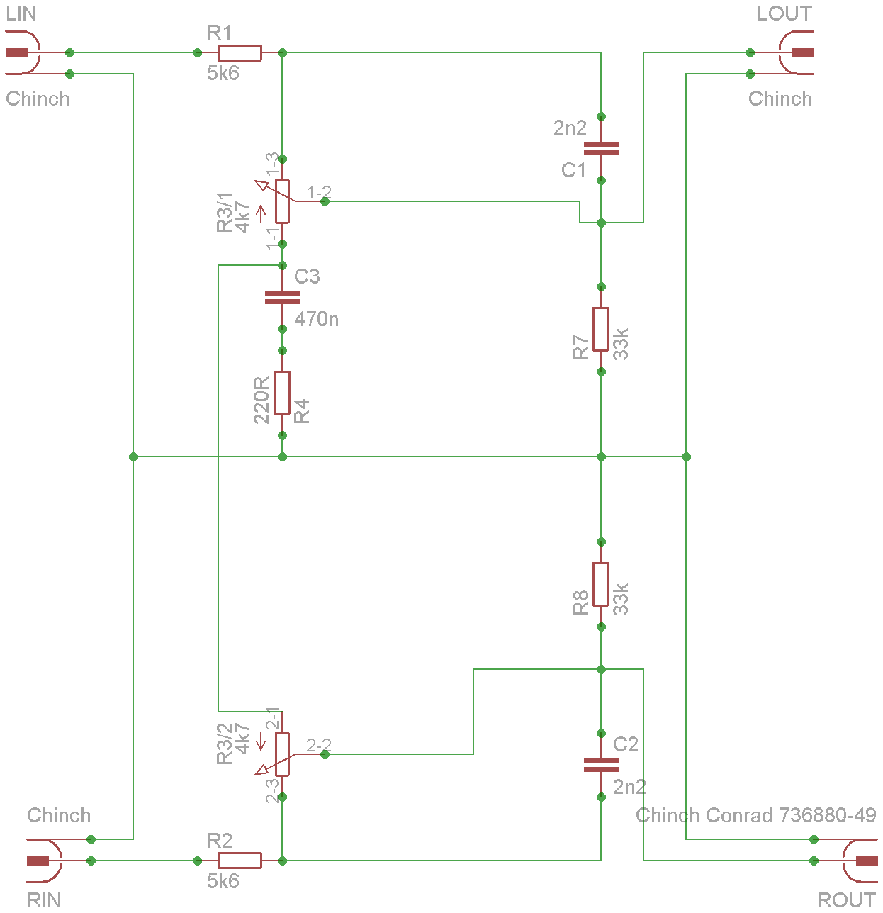

Since the schematic is mono and I wanted to build a stereo version, I doubled the circuit and, as such, doubled all the parts. Not just the "signal" parts, but the "ground" parts as well. What I realized, however, is that the ground connections are all common to each other so doubling up on the "ground" parts (cap and resistor) was a mistake.
I plugged in the soldering iron and a few minutes later I had removed the redundant (parallel) cap and resistor from the ground path, so now both ground connections from the POT are grounded through the same cap and resistor.
The variable loudness control is now much more effective. At maximum setting it is now almost too "laid back" for my taste.
