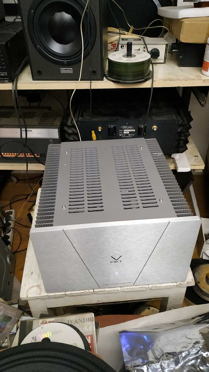

few more details I forgot:
- ZM is Chicken - 20K multiturn trimpot instead of enclosed 25K FABPa model
-washer + split washer everywhere
-heatshrinking wire ends leads to nicer look; it also increase your Zen
-toss enclosed crimping connectors in trash bin; solder everything; it also increase your Zen
-soldering of sensitive plastic parts - crank station to max, do it fast and efficient - funny but lesser melting of plastic that way
-enclosed nice dome head screws - while M3, having 'Merican Allen key head - who invented that shizo thing - ZM Is not having 'Merican Allen wrenches in appropriate quality, so I can't tighten them properly ..... anyway - stainless steel headless screws and nuts are much better for T Bar tightening ..... even if inadequate
-drilling of 4.2mm holes for additional M4 Allen key screws- sorta mid of T Bar length, use calipers to b precise enough to situate them exactly in between the heatsink fins; drill heatsink first, then mark through these holes points on T Bars
-dissipation of mosfet is 1A8*(14V-(1A8*0R75))=22W77
-dissipation of VFet is (36V-(1R1*1A8)-14V)*1A8=36W04
-summ dissipation per channel , including PSU, is 1A8 x36V=64W8
go figure - 128W of heat for 2x10Wrms
aaaaaaalmost SIT-2 Territory

Truly inspirational build quality.
I had one question about how you terminate your bare wire (See bold above). Are you using some type of pin termination then heatshrinking over pin or is that just bare wire that's tinned with solder and then heatshrink over remaining uncovered wire once solder to boards? I've seen this on all of your builds and they seem like a very solid and clean connection.
@CoGT3
my pcbs, power traces, pads on them - all having ~2mm Dia hole, so I'm using needle end wire crimp connectors, supposedly 2.5mmsq; adequate for all wires from 0.75 to 4mmsq
always removing plastic sleeve from them, gentle crimp on bare wire end, then soldering wire and connector together ........ so crimping is just to have it mounted and basic physical contact, solder doing majority of job
then heatshrink all, solder needle pin to pcb, cut
on non - power-traces on my pcbs, I'm simply removing wire isolator on end of wire, mount heathsrink as sleeve, then either pre-tin or solder ditto on pcb
doing exactly the same on all pads on no-mine pcbs, rare case that pad is made for needle end connectors
started heatshrinking almost everything - hate to see even sightly melted isolation; not all wires are having PTF isolation or ultragigamega non-melting plasticky
did contemplate using so called wire sleeves for end dressing - but that's just unnecessary complication - good for screwed connections in pro field, which I'm not using and never will

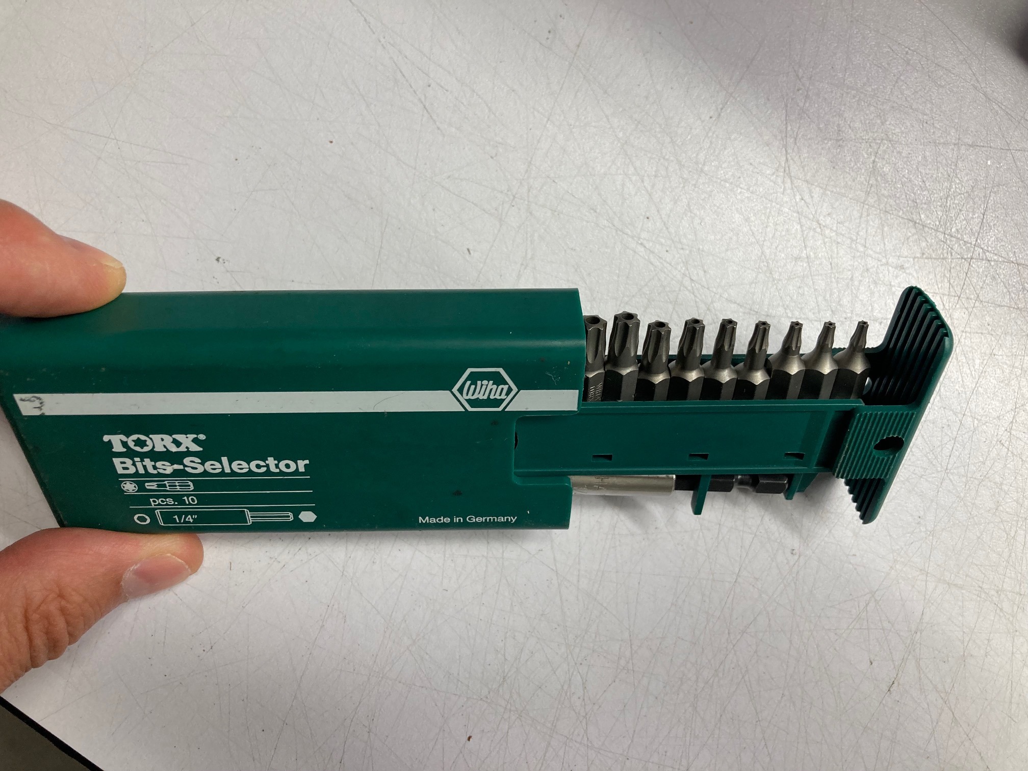

Nota bene, it turns out that "torx" style bits will fit a lot of hex head / Allen head bolts pretty cleanly, with minimal if any slop. The little bolts in the Modushop Mini Dissipante kits that fasten the top plates are one such example that I use the next to smallest torx bit in this picture on exclusively.
well, when speaking of force necessary here, that fitting isn't good enough ..... though main reason why I didn't use those M3 is realization that M3 is simply no go in entire mechanical/thermal arrangement
that's why I resorted to what is shown - brute force with genuine 8.8 screw hardware of appropriate size
was lazy, solved everything with two additional through-hole M4, proper quality, so tightened with force - mechanical terms ...... (say 2Nm as minimum), not electromechanical
electromechanical....... that being field where 1.3Nm is more than enough, dealing with transistor cases, thermal pads etc
speaking of sweet dome-head M3 screws, wanted to use them for top cover, but didn't - exactly because of 'Merican Allen size; so used SS Metric with SS washers, good enough looking

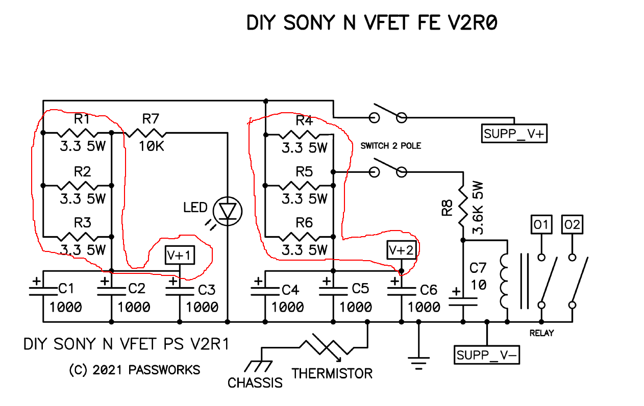

ZM have you note that the green resistor are heating che elco on psu pcb quite a lot ?
Datasheet math can help create useful estimates.

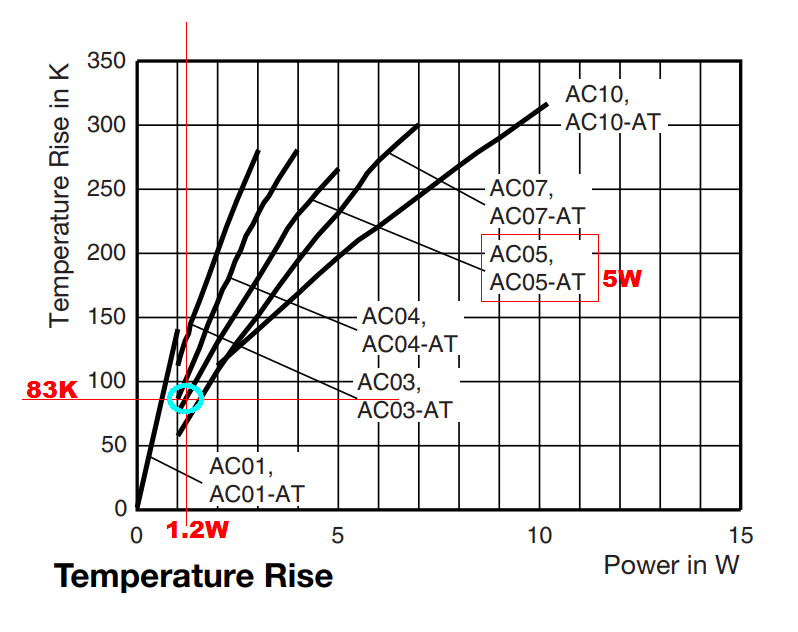

Assuming the PCB is stuffed with six pieces of the green Vishay resistors, Mouser part number 594-AC050003308JAC00 (3.3 ohms , 5 watts , 7.5 x 18 mm) ... then
ZM measured 1.8 amperes DC per channel. Each channel is fed from three 3.3R resistors in parallel, so each of the three resistors carries one-third of the current, namely (1.8A / 3) = 0.6 amperes.
Resistor power dissipation is I * I * R and in this case that's 0.6 * 0.6 * 3.3 = 1.19 watts. Each of the six green resistors is dissipating 1.19 watts. Together the six of them form a linear array of heat emitters.
Mouser has a link to the engineering datasheet from Vishay, and on page 8 of that datasheet we find the graph below. It says that when an AC05 (5 watt) resistor dissipates 1.19 watts, its body temperature rises to 83 Kelvin above the ambient air temperature. If the air temperature is 30 degrees Celsius then the resistor body will be at 113 degrees Celsius. Hot enough to boil water, hot enough to burn your finger. Hot enough to cook the nearby electrolytic capacitors? Use an FLIR / infrared camera to investigate further.

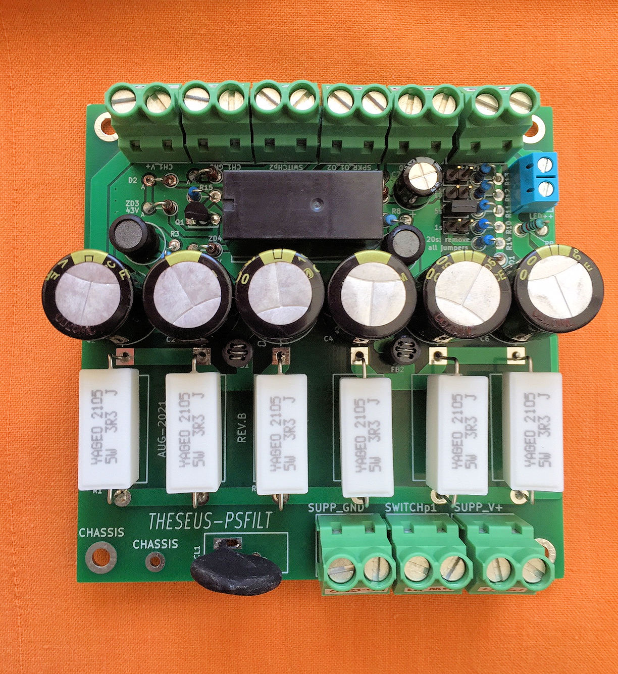

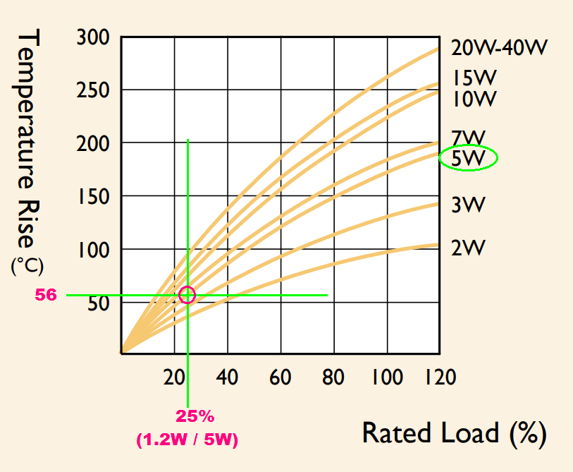

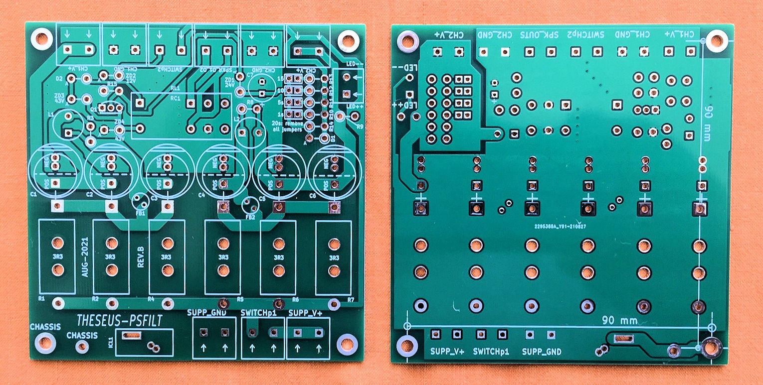

That's one reason why my re-implementation of this board uses rectangular, cement-block packaged, 5 Watt resistors: to achieve lower body temperature rise @ 1.19 watts per resistor. See Figure 1 below: temperature rise is 56K rather than 83K for the green cylindrical resistors as in post #30.
Gerbers and schematics for this board are on the Forum and freely downloadable; it's called the Ship Of Theseus PSFILT. Builders who despise Euroblox connectors can, of course, omit them and solder directly to the PCB instead.
The 5W resistors' Mouser part number is 603-SQP500JB-3R3. Oh by the way, the PCBs have a pair of air vents / cooling holes in each 5W resistor footprint, which has zero cost and nonzero benefit.

Those photos show the high frequency filtering enhancements that I added to the PSFILT board. Each channel's power supply gets a ferrite bead (28C0236-0EW-10) (R)LC filter, and also an inductor (RL622-100K-RC) LC filter, for greater attenuation of SMPS noise. PCB footprints are labeled FB1,2 and L1,2 in the photos.
