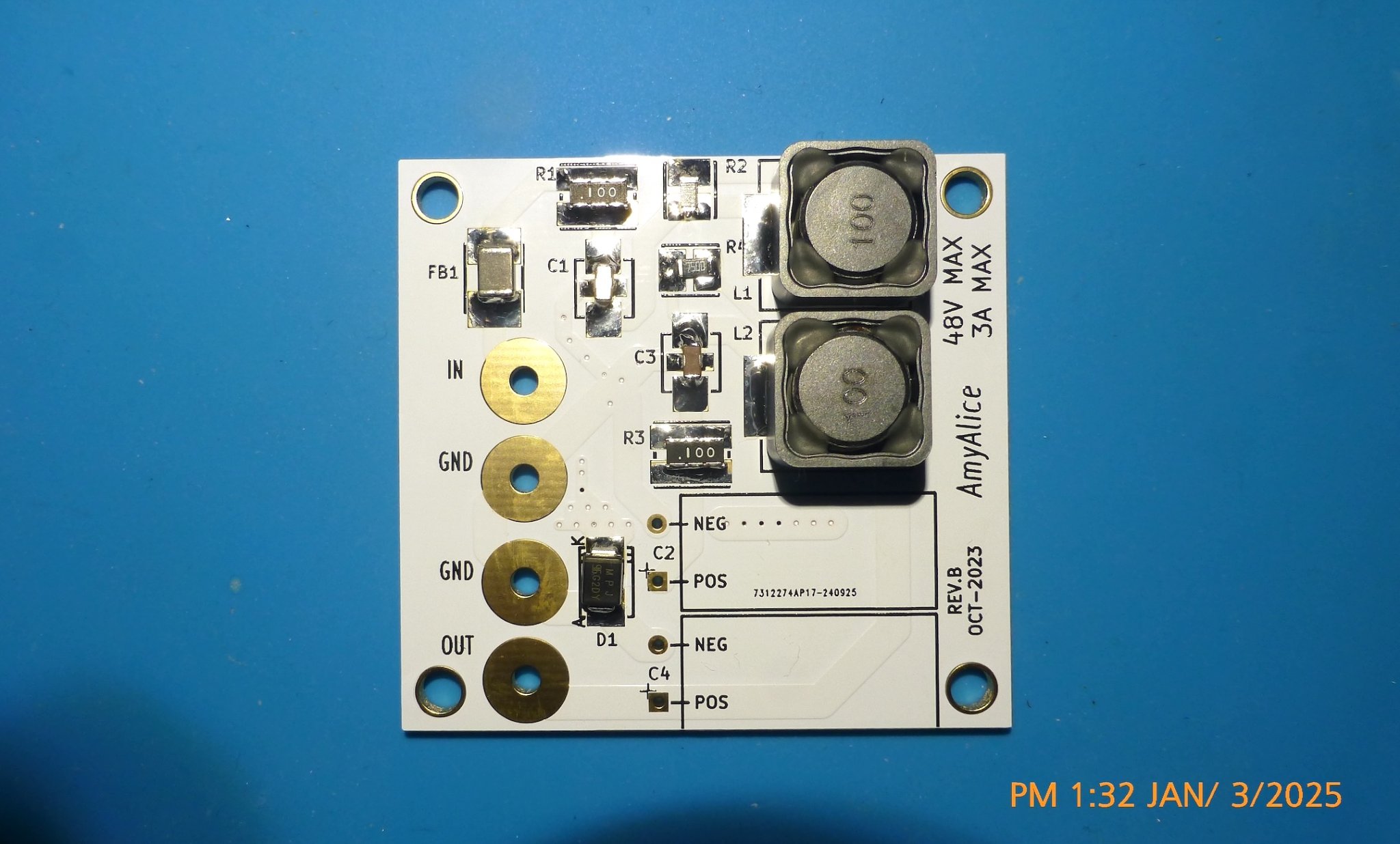

Today I make up two of the AmyAlice kits I got from Dan. This was my first experience working with SMD, so I waited for a quiet time in the house. For soldering, I followed the advice given in this short video (
and I was delighted how smoothly it went. The key thing in the approach given in the video is to preload solder onto one of the pads (I believe Ixnay above did the same or similar), place the device, then bring the iron with a dab of fresh solder to that join, without jogging the device. This pins the device down, and it is straightforward after that. I had my iron set to 650°F and used Kester186 liquid solder applied through a tiny polypropylene tip (a type typically used in electrophoresis) and FireMetal solder (the very fine gauge is helpful). I used a smallish screwdriver tip (Weller ETB 3/32”) that I have been using for a while, and it worked well here too.

Here is my first board after all the SMDs were soldered and cleaned up. I'm not sure why I decided to completely fill the large pads with solder; I was probably channeling my childhood art class training...
Dan’s choice of white makes a very handsome PCB, no?
After installing the large caps, I inspected the board under magnification to check my soldering. I also double checked things by applying 24VDC to the inputs and, with no load, checking voltages around the board. I got the expected values (either the supply voltage or ground) in the places where the schematic indicated they should be.
