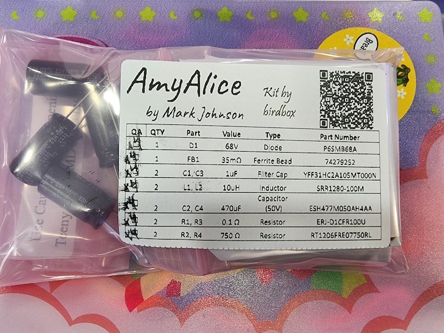

The YIWDAF4 kit arrived safely. I love the BOM on the front and that everything is already marked taking the guesswork out of trying to determine parts value.

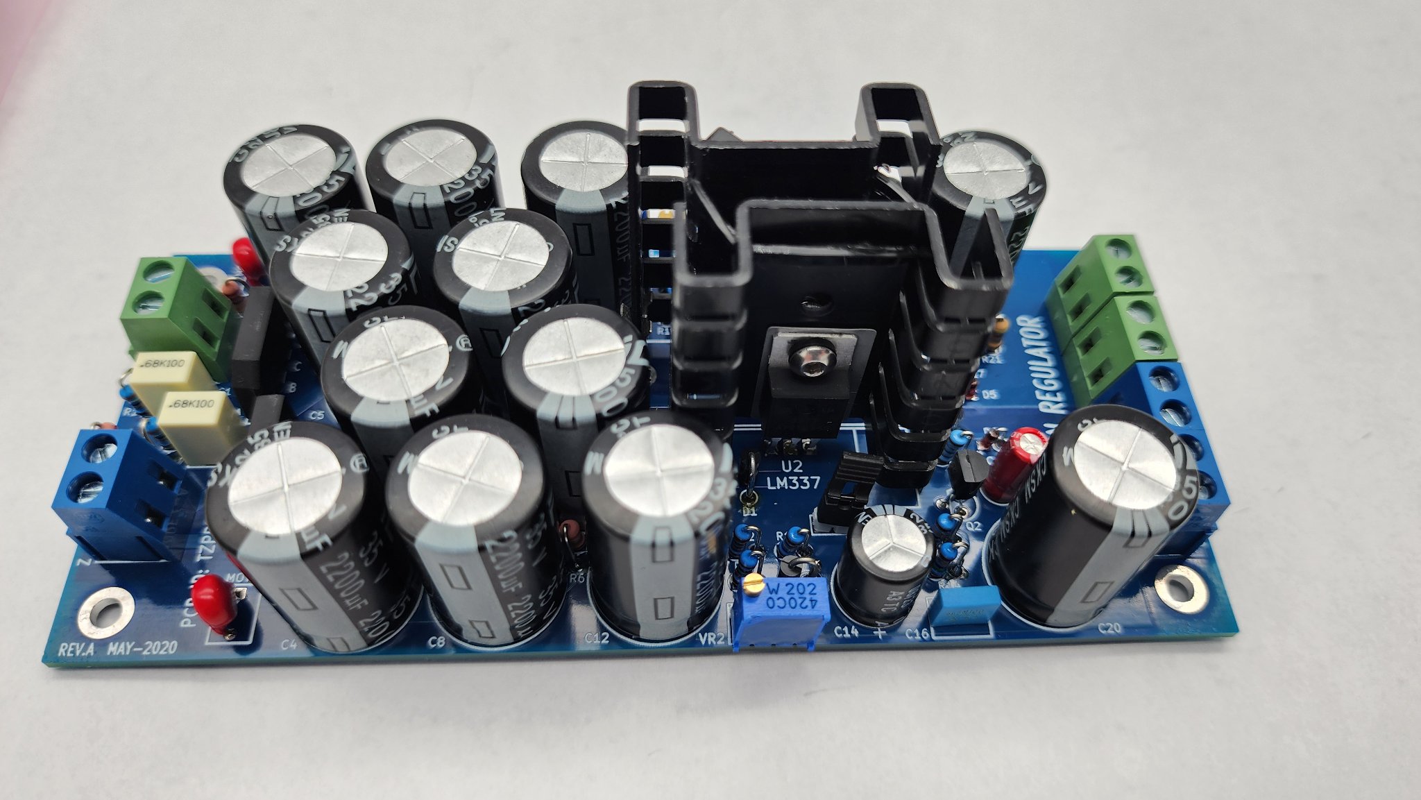

Here is the board all populated.
