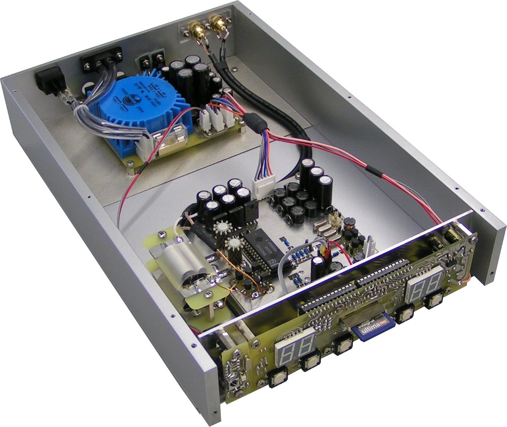

Hi riotubes,
The SB processor load is way higher compared to the processor in the SD-transport.
The SD-transport uses DMA / hardware to generate the I2S stream, the processor is idling most of the time, it just reads some sectors from the SDHC card once in a while. My brother also spent a lot of time tweaking the already correct working software in order to achieve lowest possible interference levels.
The processor we used is based on nanowatt technology and it consumes less than 400 milliwatts in this application.
In the SD-player, ALL sub circuits run in sync with a single ultra low jitter 11.2896 MHz clock. This also helps to keep EMI levels down.
The SD-transport sits in a separate screened compartment (attached picture), and I used plenty of dissipative ferrite beads to prevent spreading of EMI. perfectionists could replace the 2mm thick aluminum SD-transport screen with a copper screen.
The picture shows the new TDA1541A-MK2 module.
The entire (I)SD player sits in a solid aluminum chassis with 3mm thick bottom and rear panel, and 8mm thick solid aluminum side panels. I placed a sheet of mica underneath the mains power supply PCB for optimal safety.
The DAC outputs on the MK2 module are placed as far away from the masterclock as possible in order to minimize crosstalk with the masterclock. The transformer is a toroidal version that has very low external electromagnetic field. Perfectionists could add an extra mu metal screen.
Very important feature of the SD-player is that it can run on battery power supply (3 x 12V battery) completely eliminating mains interference / ground loops.

Dear John, I saw your nice and clean photo of the SD card player. Can you talk about the grounding?

One doesn't realize this when looking at the tiny SD-player, but it's actually an audiophile Jukebox. The SD-player supports random disc / track play for plenty of variation during listening.
The SD-player is a double insulated device (no earth connection). The entire housing is a massive star ground (GND) and shielding. The TDA1541A-MK2 DAC module is grounded on 4 points, massive 3mm thick sheet of aluminum provides extra low impedance bypass and shields the electronics on the solder side.
When battery powered, it's a "floating" device that completely eliminates ground loops running through the sensitive DAC electronics.
The ISD player also uses the complete massive aluminum chassis as star ground / reference. Like the SD-player, the SD-player part of the ISD-player can be fully battery powered if desired.
