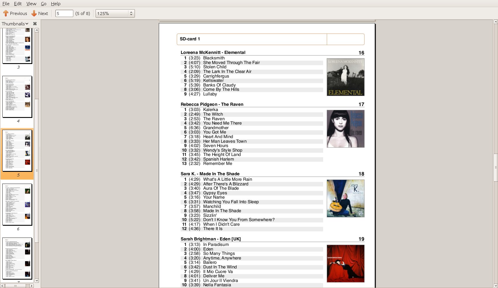

Last but not least. Operating the SD-Player ( as register a printed sheet of paper with album titles on it - not even tracks - were available ) was a pretty "cute" attempt to control your collection. In comparison to my iPad controlled iPeng/SB database
handling, the SD-card handling must be considered even worse compared to good old CDs.

The latest ECDSD utility prints album artwork, CD number, CD title, track number, track duration, and track name of all CDs stored on a SD-card. Like I mentioned before, the SD-transport was designed for ultimate performance, and a fancy user interface conflicts with this goal.

And I mentioned how the SD-user interface was implemented and that it included printed booklets of SD-card contents like attached picture shows. printed booklets have way higher resolution than LC displays and can offer a much better overview. The pdf or booklet shows CD artwork, CD number is right on top and track number, name and duration are on the left. browse the pdf or booklet, select desired CD, enter CD and track number and press play. This booklet is an essential part of the SD-player user interface.
We used a separate text file placed in the CD directory. It is a piece of cake to provide text on a display, however interference levels will rise as the processor now has to perform more tasks. This was verified by noise measurements. The other problem is the size of the display, if you are sitting few meters away from the player and you don't have hawk eye vision, you won't be able to read the information on flimsy LC display. I assume most people are able to read a booklet with printed text or a pdf file on an hand held computer.
When using an ipad or cellphone to control the player, WiFi needs to be used. Since the distance between EMI source and equipment is rather small (few meters) power levels are substantial and interference is accordingly. This fact alone (EMI) will prevent best performance unless every last piece of the audio equipment, interlinks and mains distribution are fully screened against EMI. In practice this is almost not possible.
