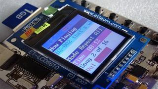

There are 3 threads on this forum on SD players, from EC, Koon, & Bunpei.
You posted one single picture without any technical details.
I found it a bit odd, if not rude.
If you wish to share details with other DIYer, I still suggest you start a new thread.
Currently only Bunpei's solution will do 24/192, but not USB.
Also none will do left adjusted, MSB first, left & right simultaneous.
Patrick

SD CARD PLAYER 24bit/192KHz FLAC support with SPDIF, I2S non over sampling output.
Next project are includes display and remote control, also USB data transfer rom computer.
