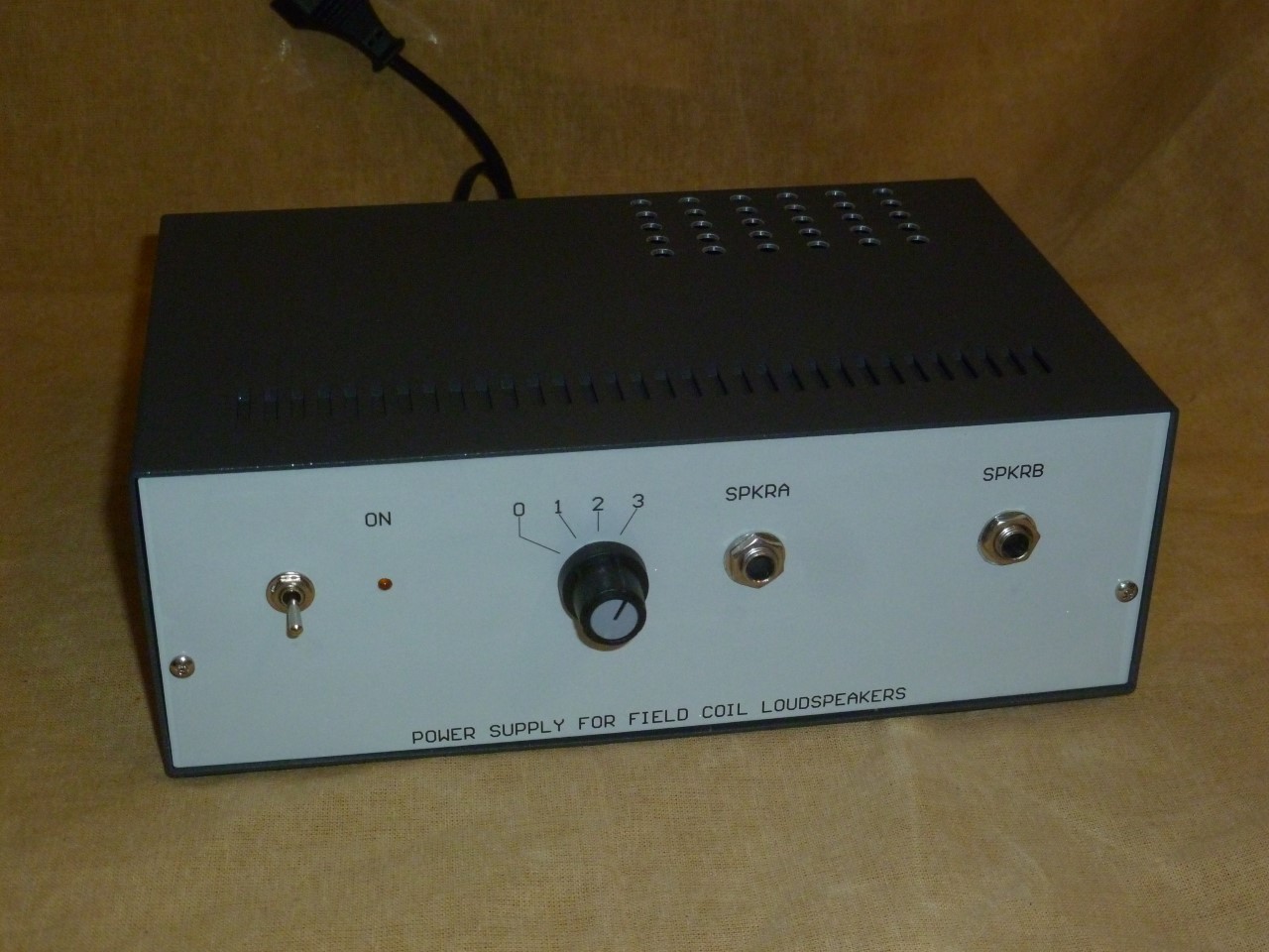

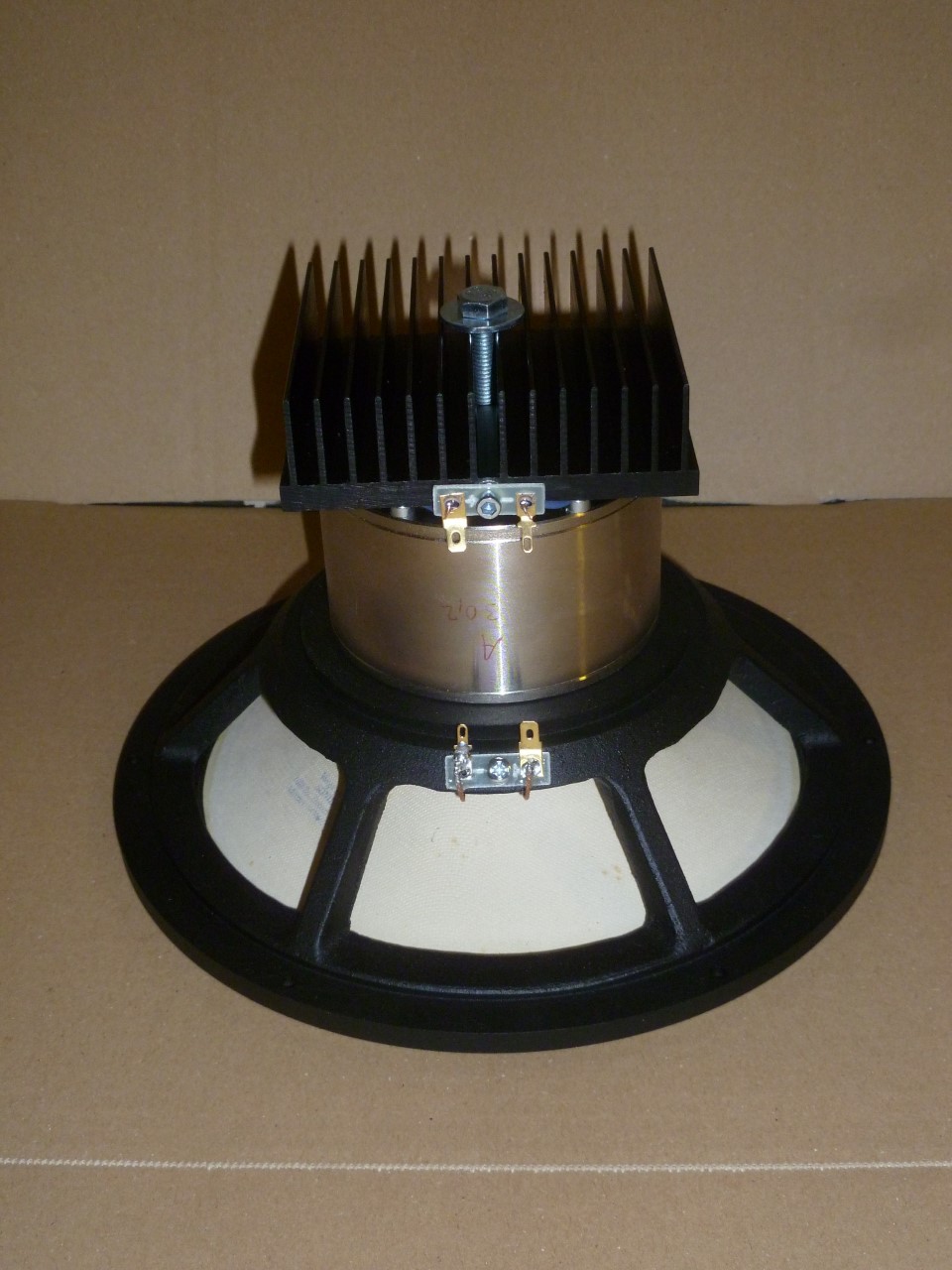

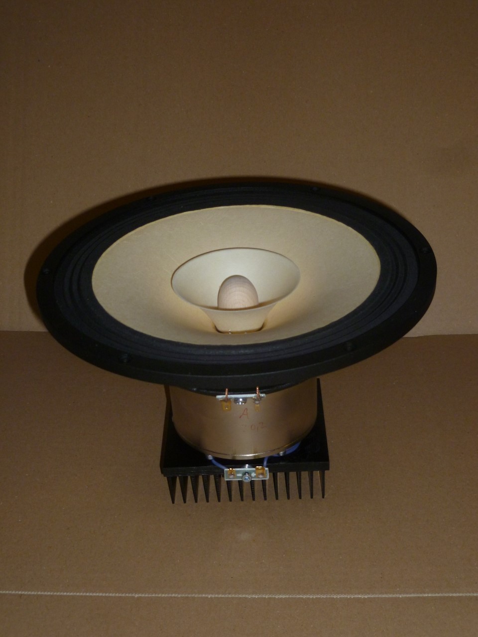

Here is an interesting full range speaker from Europe. They are Field Coil drivers. SONIDO SWR250FC 10"
Yes, I've been emailing Istvan. The 2 drivers and power supply and shipping the come in at $880.00 USD.
I'm really thinking hard about these field coils but what's your opinion about a 10" vs 8" drivers. I have subs so bottom end shouldn't be an issue.
