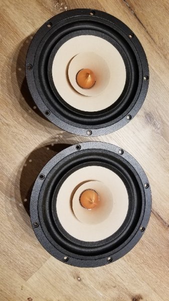

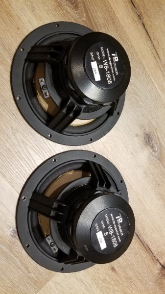

I found these for sale for $375 shipped. What do you all think of them. Tang Band W8-1808.
not sure about OB. Qts is only .44 so I couldn't push them very hard. I like sealed better than vented and the data shows they are at F3 of 87hz in a 1 cu ft cab. Supported by 4 or 2 subs, that would work well.
