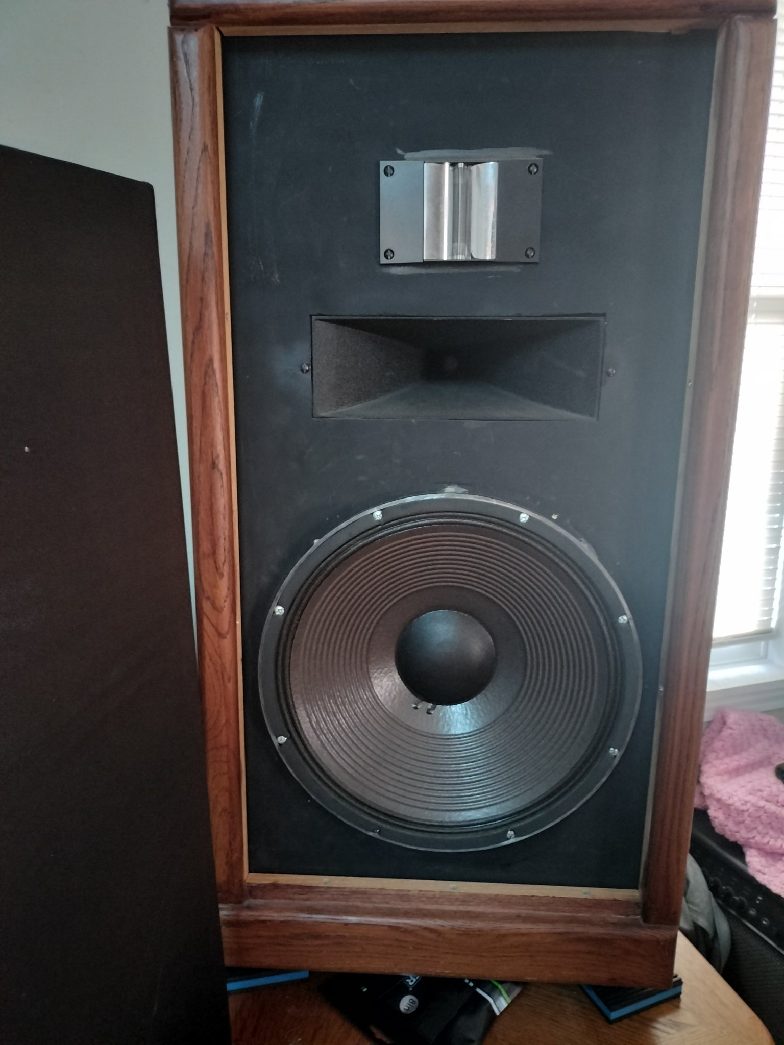

Very interesting, thank you! When I get the chance, hopefully tomorrow, I will open up the back of my cabinets (the entire back is just screwed on and has a gasket, but it's a lot of screws so it's a bit of a pain and I fear stripping the wood) and find out the compression driver model. I think I remember they were in some version of altec voice of the theater speakers... they're not rated for high power handling, and the horn is an exponential design with roughly an 11"x4" mouth, seems like cast or aluminum, they have no flange on the front but rather on the back, and you see a single screw on either side of the horn on the front baffle holding it in. I think the driver had 3 bolts. But I'll find out, and if I can upload pictures I'll do that.I just picked up a pair of Altec Vott speakers I am restoring for a song and I am putting the 2225's I have in them (I just listened to them roughed in last night). I played around with no crossover but a diy l-pad and only a few watts while listening to them with a SEOS 10, a JBL horn setup I have as well as the Altec 811's that they came with. While these are far from being done, the early playing around with them gave me some ideas on what they will sound like when completed (aka awesome - I could literally hear the difference between mp3s on the old ipod I was using - at first I thought something was wrong with the drivers until I switched songs and the problem went away).
From skimming your post, it would be really important for you to find out what horns and drivers you currently have or else everything would be speculation. One option would be to get your hands on a large wave guide like the SEOS 24 or maybe 15 and get them playing down to the 500hz area, where it would match the 2225 (811's would also work).
If you put up pictures of what you have maybe we could help deduce what the parts are so that you aren't just asking in the dark.
Hey I purchased the minidsp umik-1 btw, should have it within a week, and I'll get to learn a lot about my current speakers, crossovers, and EQ settings!I think there is something like Hofmann's Iron Law...except for DIY loudspeakers:

I think that you're mistaking the 2426H for the larger 2446H. The horn shown appears to be a JBL 2370 (or copy). The combination shown was once used with a 2225H in what was known as a JBL 4671, crossed over at about 800Hz.Or for $220 a piece plus shipping, I could get the JBL 2446h mounted on horns (it's not clear what the horns are)... https://reverb.com/item/67209443-jbl-2426h-hf-8-ohm-compression-driver-w-horn?bk=
Yes thank you, my mistake. Any of those stand out as great options for either a 500 or 800hz crossover? If I want the horn to extend relatively high and have decent HF dispersionI'm guessing I need to stick with a 1 or 1 3/8 or maybe 1.5" throat/driver, as opposed to the 2 inchers... that that also conflicts with playing low, although there are 1" options that should be just fine to 800 at least.

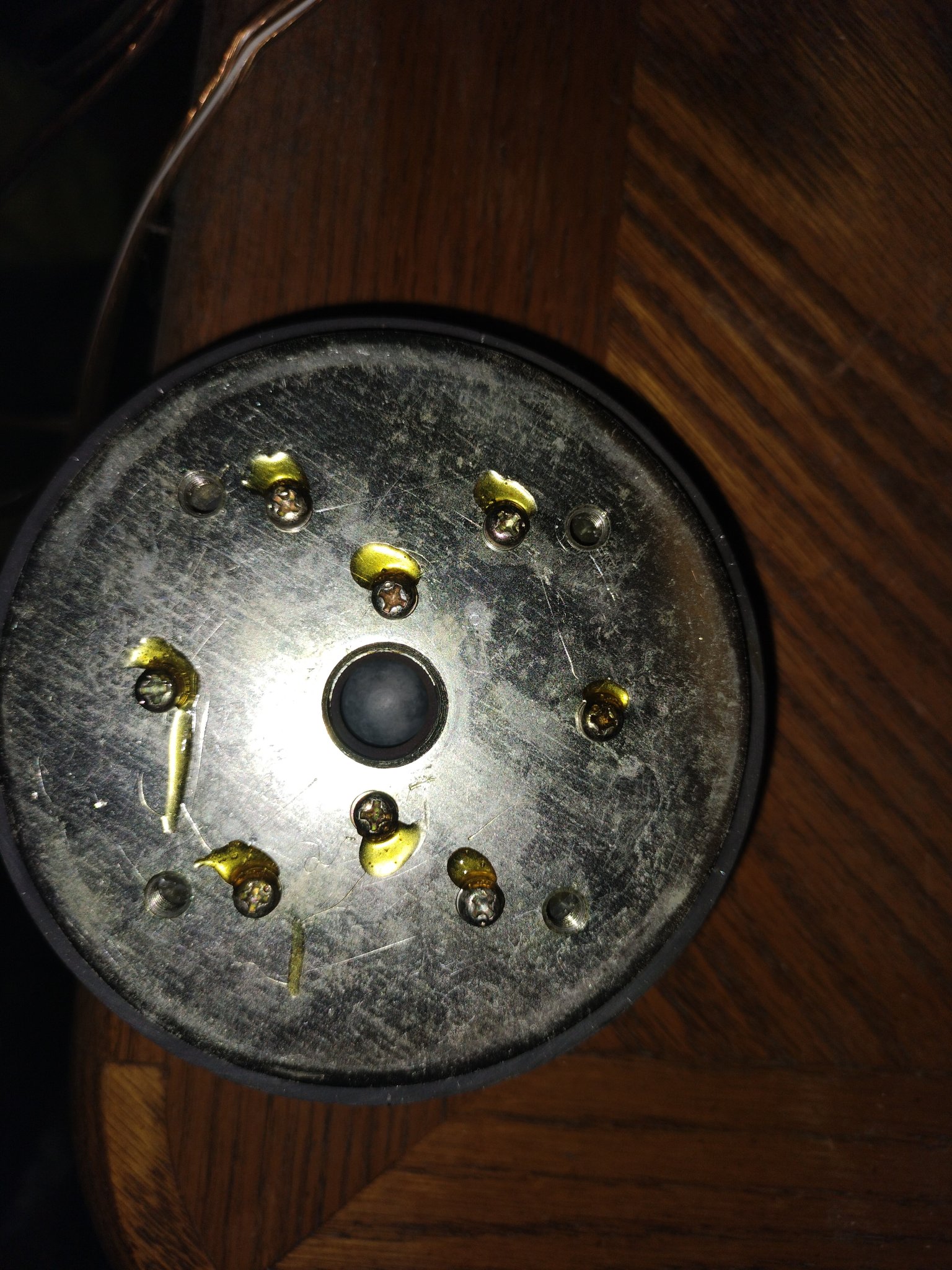

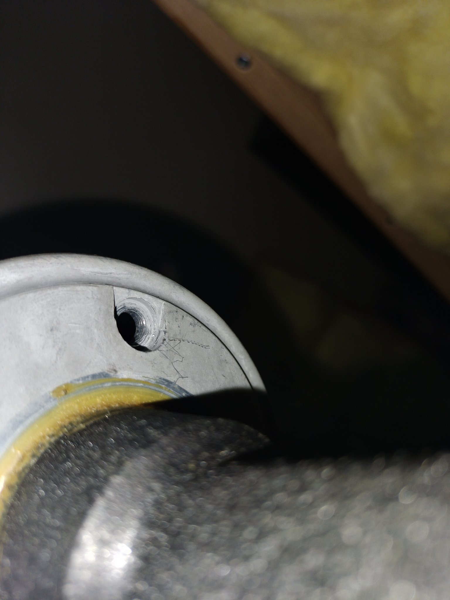

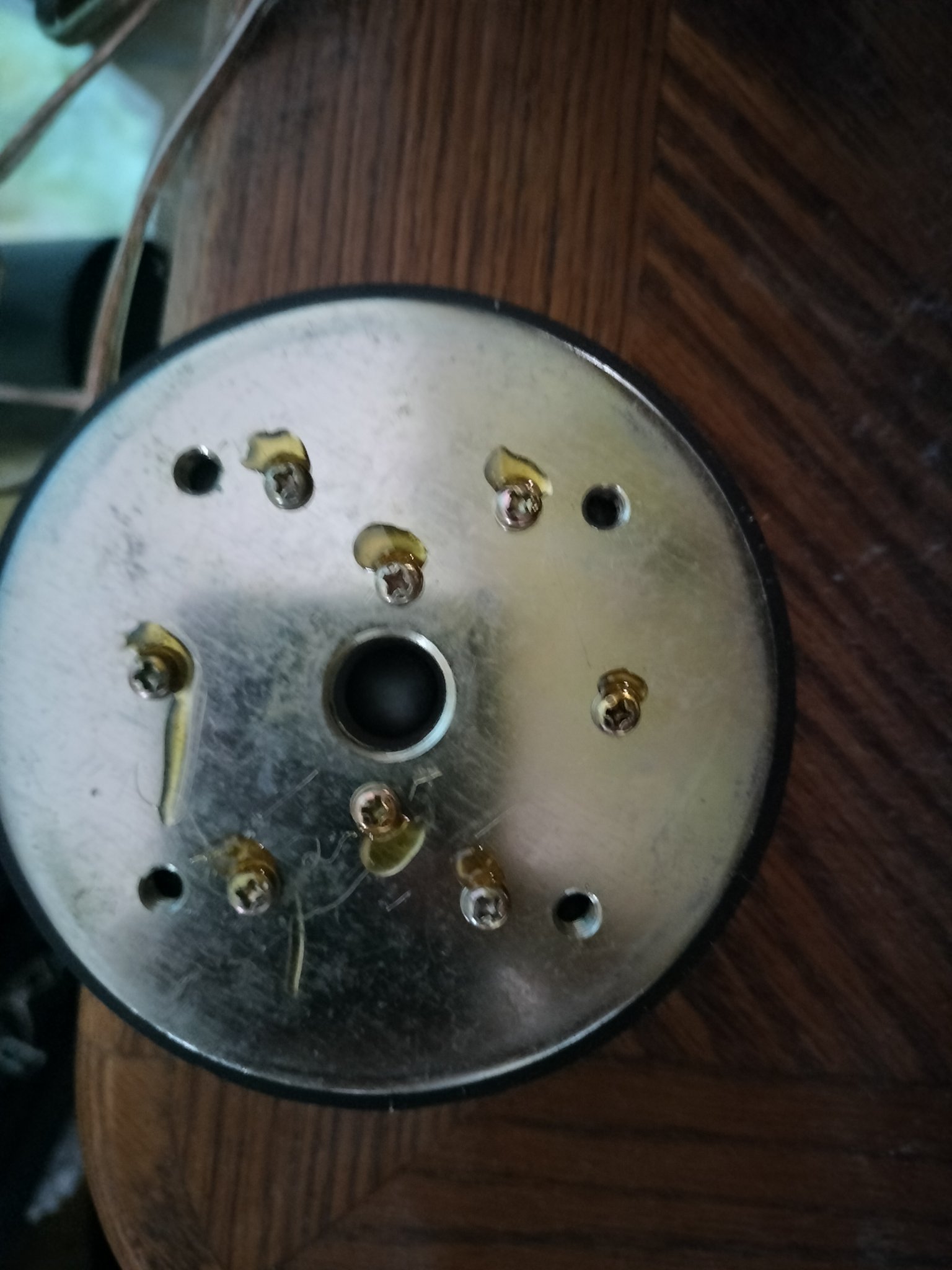

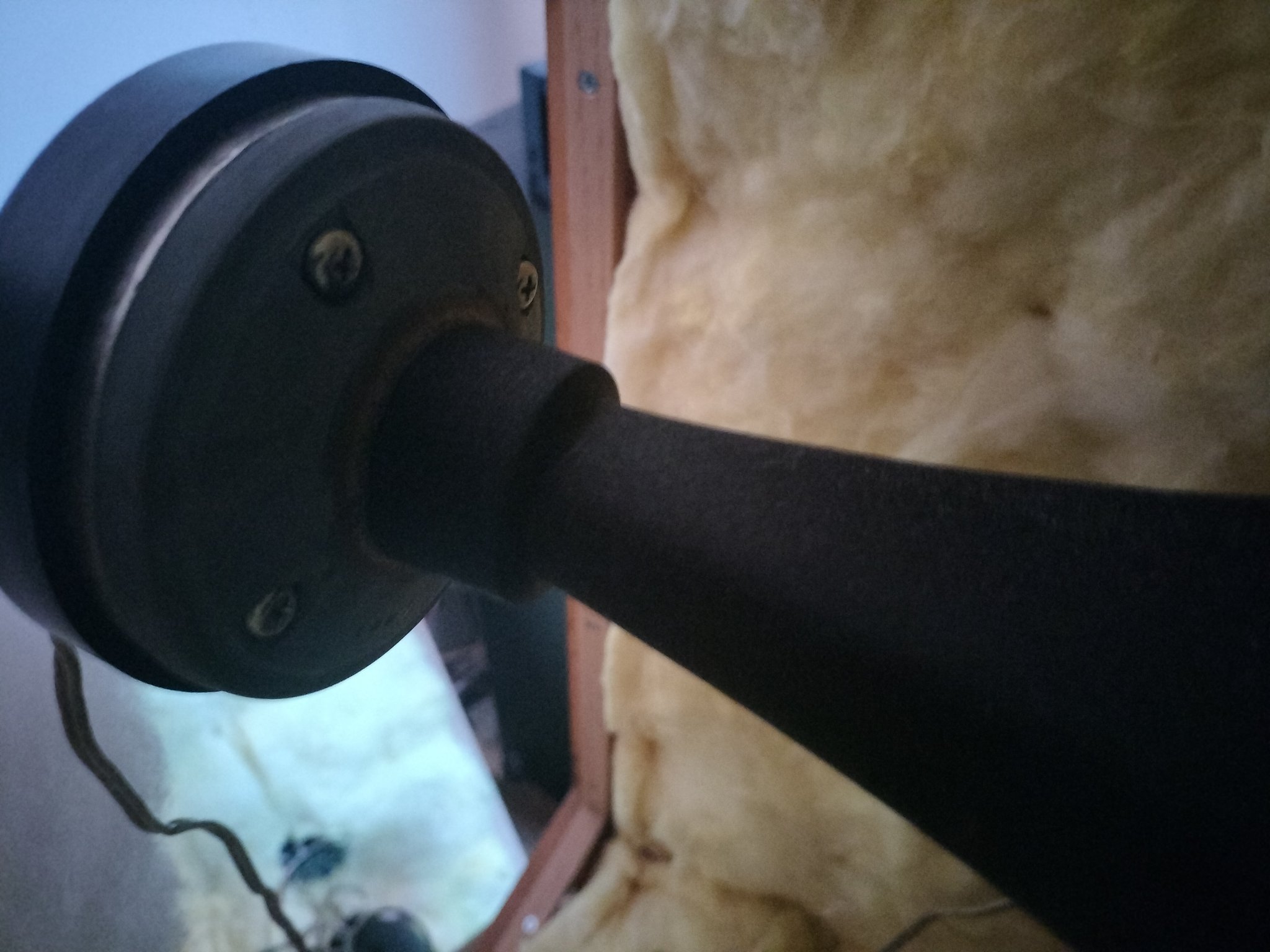

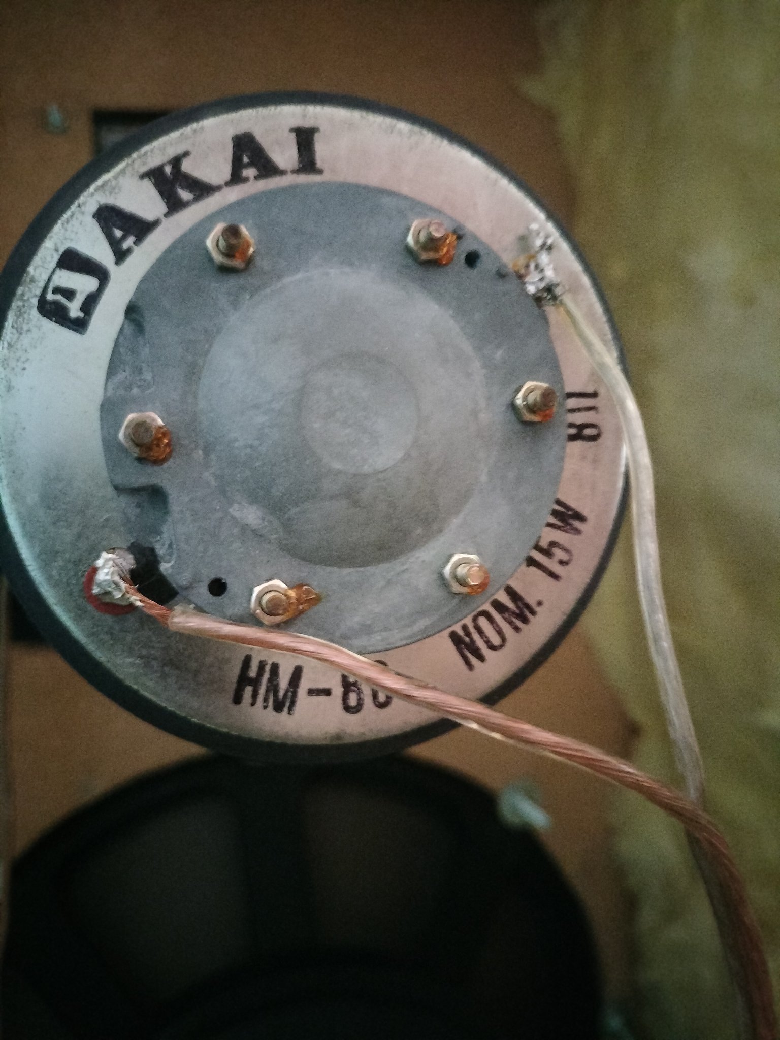

OK, my memory was totally wrong. I was told by the builder/seller that they were from SOME kind of theater speakers, but they are not Altecs. The CD's are Akai HM-80, 8 ohm, designated as only 15w. I'll also experiment with a small/thin or not-dense piece of foam in the back of the throat, just to see the effects.I just picked up a pair of Altec Vott speakers I am restoring for a song and I am putting the 2225's I have in them (I just listened to them roughed in last night). I played around with no crossover but a diy l-pad and only a few watts while listening to them with a SEOS 10, a JBL horn setup I have as well as the Altec 811's that they came with. While these are far from being done, the early playing around with them gave me some ideas on what they will sound like when completed (aka awesome - I could literally hear the difference between mp3s on the old ipod I was using - at first I thought something was wrong with the drivers until I switched songs and the problem went away).
Here's some pictures. It's a very odd and seemingly proprietary horn. There's a metal screen that I was going to remove as a mod that I thought would be on the compression driver over the opening, but it turns out it's in the throat of the horn itself, like 2" in, and the thing the CD mounts to seems to be glued in. The crossovers, which I forgot to picture here, are also smaller and simpler than I remember... probably not adequate for passing a ton of power, though I've never noticed any issues. But even just that could be a FR/SQ issue itself, outside of the drivers themselves. The hole in the CD, the little throat before the horn throat, is also not perfectly smooth, there's a lip/edge in there because it's multiple pieces of metal, I could probably putty that.

You could do a lot better than a 15 w akai 2" CD I'm sure. I was going to suggest measuring your system to see what is wrong, but first thing it is not really a JBL 2225, which is rather legendary. My SP2(2004) horn is 7"x14" with rounded edges, and that gets full frequency response 6 db down to 45 deg off axis, and +10 -40 deg from horizontal (SP2 are made to be mounted high on poles, where I have mine). Peavey are getting 1200-1800 hz out to 45 deg - 6db from a 15" woofer by pinching in the back of the case and doing tricks with the elastomer stuffing.
Another thing about these, the Harmonic distortion is 2nd harmonic 20 db down from 5 w response 60 hz to 12khz. Most speakers don't even measure HD. Where low HD shines in my system, piano all octaves, tinkly bells, cymbals, etc sound more real than anything else I've heard. That includes the Meyer sound speakers at Brown Theater over in downtown Louisville. I run mine at 1/4-50 w in my music room.

My woofers are indeed 2225h's, the cones may not appear the right color to you because I mod podged them primarily for aesthetics but also any extra weight and rigidity in my application I considered a good thing, to help the low bass. They look way better with the deep shiny black vs. the greyish color they are naturally. I could show you the back of the drivers, I know they're legendary, that's why I bought them myself for over 300 dollars on Ebay nearly 15 years ago. The speakers were originally designed with a 15" RTR woofer, which was not a pro driver, just a budget 15" driver from some commercial speakers. Obviously a coat or two of mod podge doesn't weigh much compared to the mass ring in the 2235, but you get the idea. I do not know the size of the Akai driver, perhaps you looked it up, I haven't yet... but the throat is around half an inch... surprisingly small, definitely a tweeter horn, not really a "mid-range" horn.You're in the USA. There are threads on multiway forum puffing the 1" CD Eminence PSD2002-8 which has a resonance of 550 hz. Eminence says it is usable 1.2khz to 20k. Response at 15k is down 5 db from 10 k. Response at 800 hz is 6 db down from 2200 hz. AES power is 80 w (in band) PSD2002-8 is $80 bolt on and $90 screw on.today at Parts-express.com https://www.diyaudio.com/community/threads/econowave-style-15.400662/latest

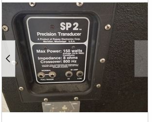

There are a pair of Peavey SP2 (1985) crossed over at 800 hz on ebay now for $300. Free pickup Rochester NY https://www.ebay.com/itm/295741844085?hash=item44db966a75:g:~EgAAOSw7-Vkfjqa&amdata=enc:AQAIAAAA8M34BV6OMl1BagAtDqL01CDTG6AKemYsPPkP2X/jGuJJTRvCcNfzMRLAqlLVuxfacnY5zHjQD26Pu7L/100/yOXiuOfgCCArC3mJLSC9dYYEarzIh7Caou2EJDksvZig4TrUbaXtEaPV8ZaStt67pZiLTZZXzdg8f8MitIUu91cjDJH/Mk8/vToHJWOz+5/NdMzamYBTAaoC8qNT9bzN2bISGL7PHDf1Om7Skg3y8bQ9znDtYkf2Z08tdMrlSz7WkxGvbhnrnIgBoXewBO39Dn07ffJ8qvie1qlpcAZTXs3gmZRQg7Rc1GjqPJe2RgkNyw==|tkp:Bk9SR-Tw-ZasYgI saw his (unrealistic IME) budget, hence use dual inexpensive drivers and a big horn to keep them from audibly distorting down low.
I've seen them as low as $200 the pair, in Iowa. You can tell they are crossed over at 800 hz because the rated wattage is 150 AES. Also the rounded horn. Anything that old will require new electrolytic caps in the crossover, and probably cleaning of the switching 1/4 phone jacks so they make contact.
