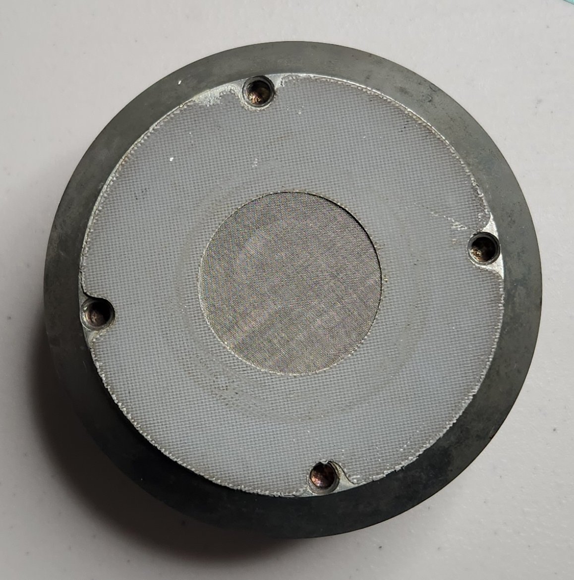

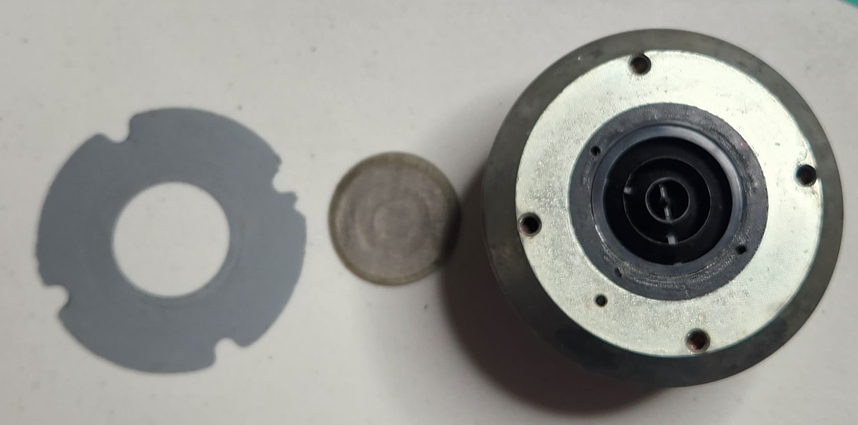

Do you think protective screens, like those that cover many compression drivers, or like the ones in the throat of my horns, can offer improvements if removed? I imagine it may vary from case to case, but I did read some reviews of one CD where it was claimed that removing the screen was helpful. I could figure out some tool to shove in my throats to cut out the screens and maybe file away any of the edges that remain. IDK if they add any additional physical impedance helping load the driver lower or not, or if they are truly acoustically transparent, or if they cause some diffraction or internal reflections (beyond what's inherent in an abruptly ending exponential horn).
Hello Lee
That is funny!!!! Auto correct strikes again!!!! Removing screens???? Might have to give it a try??? I never have and with some drivers I wouldn't even attempt it because the screen is in a ring that is pressed into the throat like the JBL 2426 as an example.
That said the JBL 1.5 drivers have their screens under the rubber gasket you can easily peel up and replace. In that situation you could try.
Here are a couple of pictures on the 2435 1.5 inch CD screen on and off. It's a risk with no screens so???
Also with HOM concerns have to wonder just how much energy is reflected back into the phase plug from the screen??
Rob 🙂
