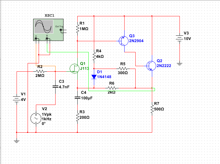

Jfet Q1是在极低电流下工作的高阻抗输入级。Q2和Q3通过R6和R7向源提供输出和反馈。D1、R7和R8在二次谐波产生的过零点附近提供了圆形削波。R7的值决定削波的积极程度。没有限幅网络时,放大器增益为(R6/R1)+1,失真约为0.05%,对于吉他和麦克风应用来说已经足够好了
:cop: Translated:
Jfet Q1 is a high impedance input stage operating at very low current. Q2 and Q3 provide output and feedback to the source through R6 and R7. D1, R7, and R8 provide circular clipping near the zero-crossing point where the second harmonic occurs. The value of R7 determines how aggressively the clipping is. Without the limiting network, the amplifier gain is (R6/R1) 1 and the distortion is about 0.05, which is good enough for guitar and microphone applications.

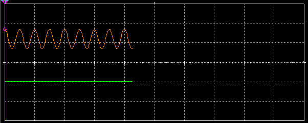

Why can't I see the wave pattern at the output?

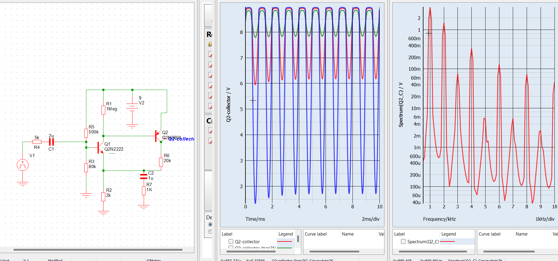

One possibly significant aspect is the thermal stability. I used to think "bad sounding 0.0000x% THD" was just folklore, but now I see it's probably real. DSP with triode curves won't fix issues in the analogue design, like driver BJTs swinging too much power, where the heat dissipated in the junction modulates the gain parameters, causing hidden IMD that totally bypasses the simulator's THD estimates.
Unless you force the simulator to include dynamic heating effects, which nobody ever does.

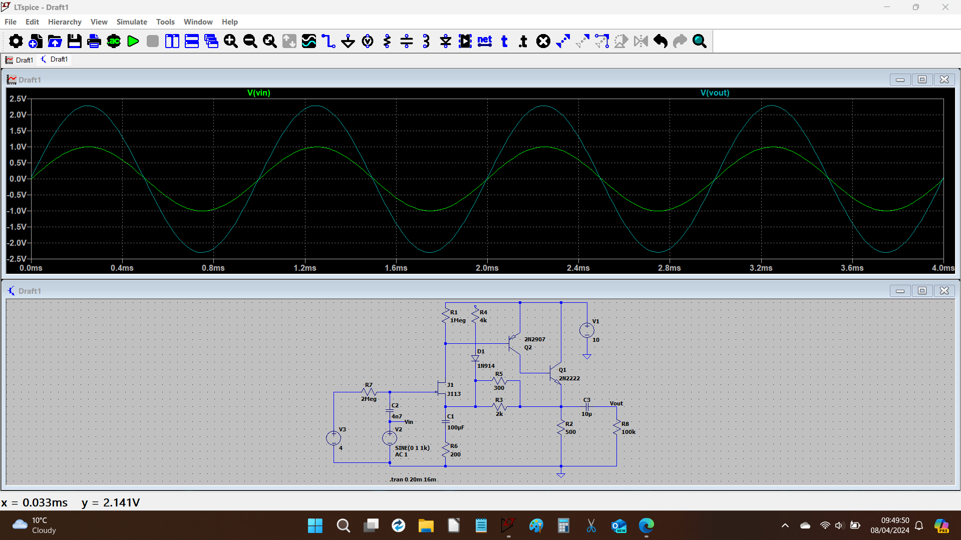

The Jfet may sound good but it is way to exaggerated.

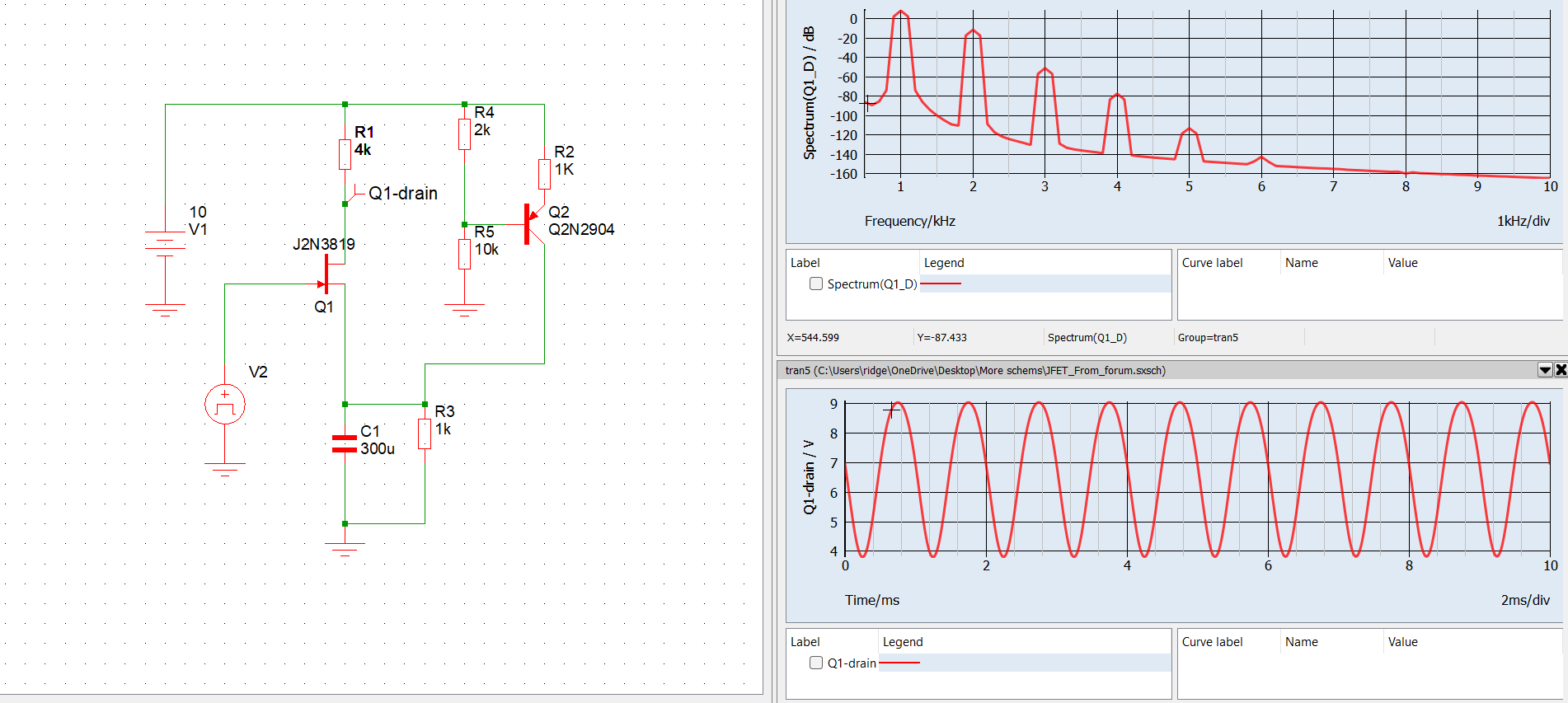

Just want wanted to see how harmonics are at high overdrive for guitar -- can easily be adjusted back. That circuit gives distortion on saturation side of Jfet.

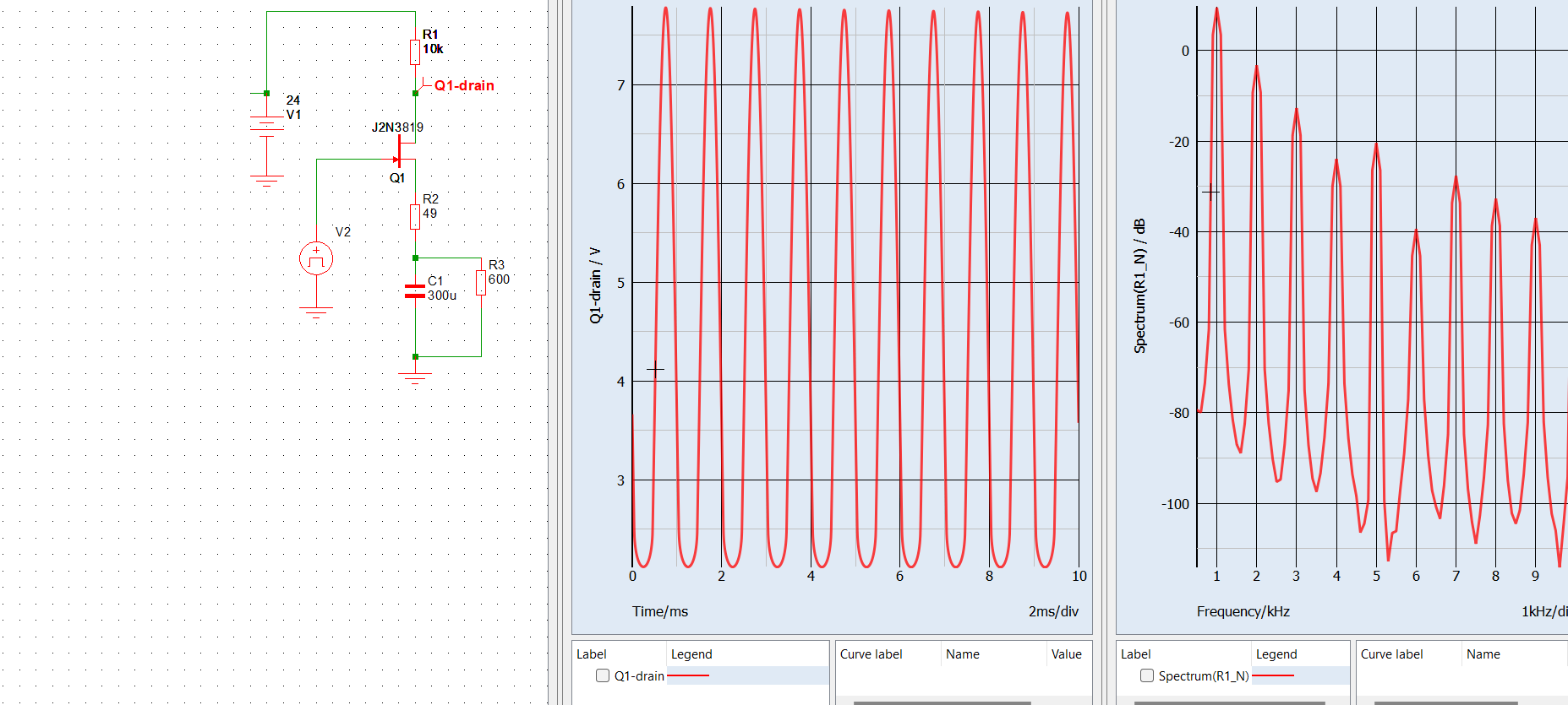

I tried putting distortion on pinch off side and looks really clean -- high order harmonics greatly suppressed which is good. Also -- just checking range side adjusted high . Easy enough to build and try on Les Paul later
