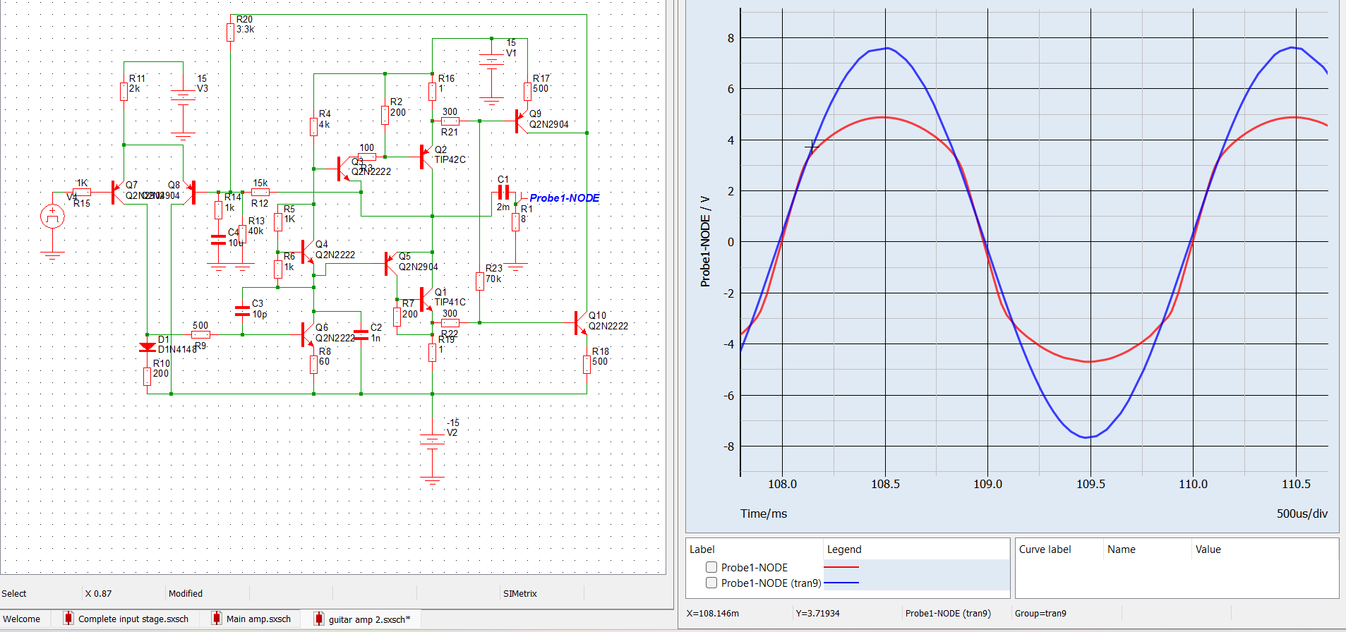

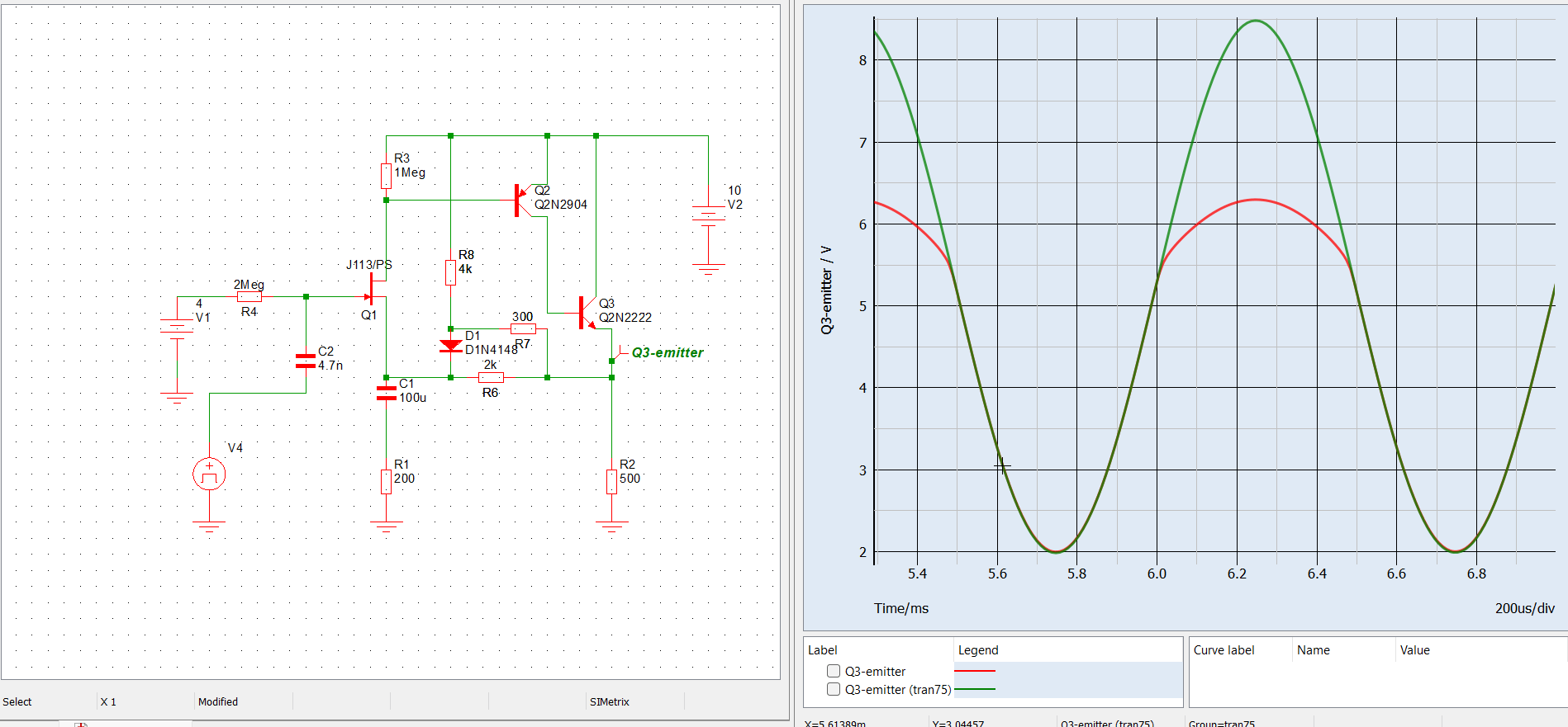

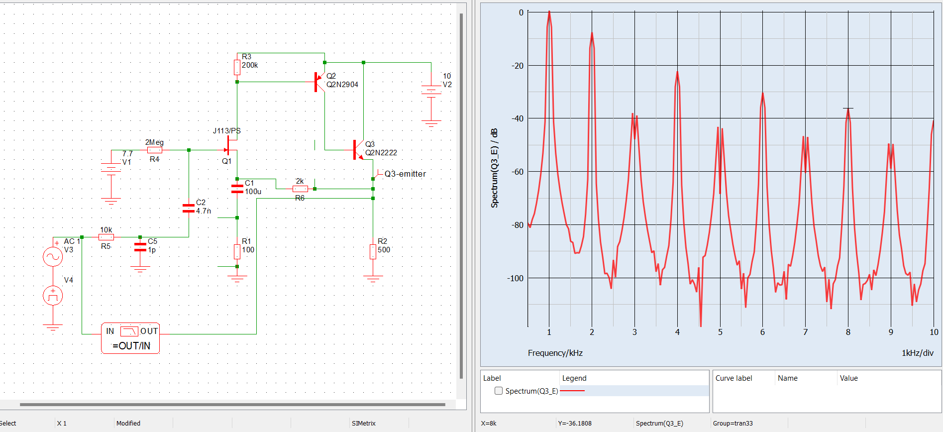

Can introduce the circuit and installation in detail.
Jfet Q1 is high impedance input stage that operates at very low current. Q2 and Q3 provide output and feedback to source of through R6 and R7. D1, R7 and R8 gives rounded clipping at about the zero crossing for second harmonic generation. Value of R7 determines how aggressive the clipping. Without clipping network the amplifier gain is( R6/R1) +1 and has about 0.05% distortion -- plenty good enough for guitar and microphone application
