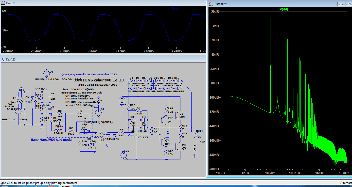

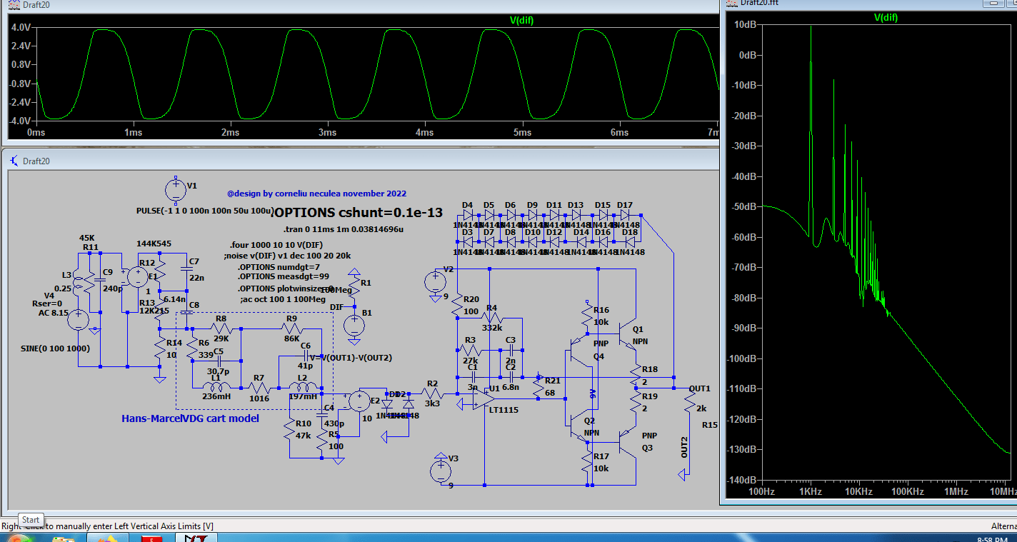

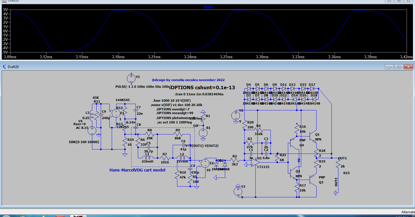

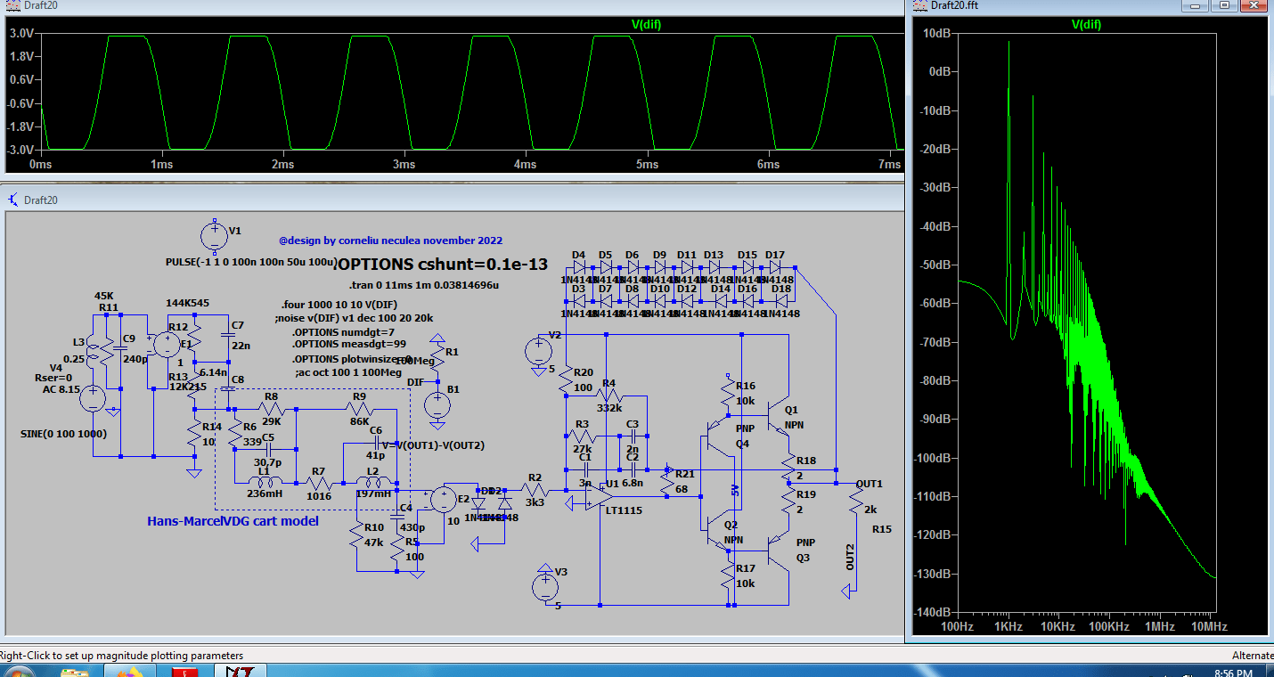

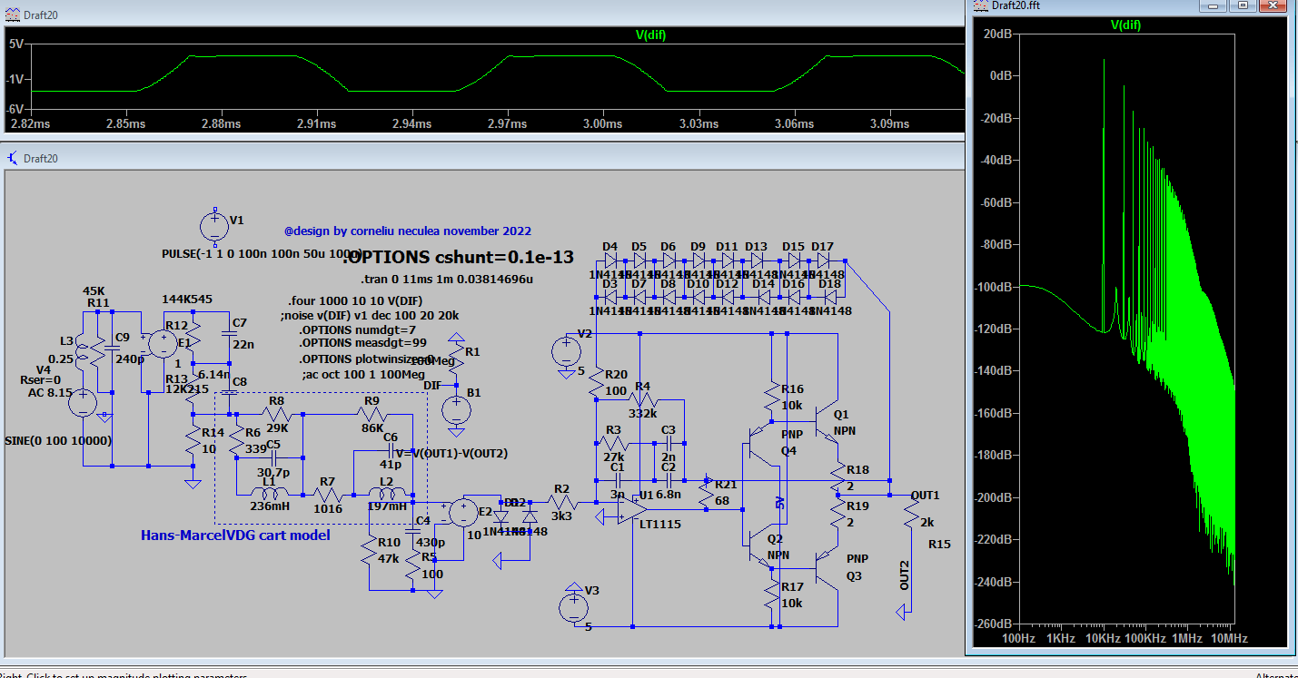

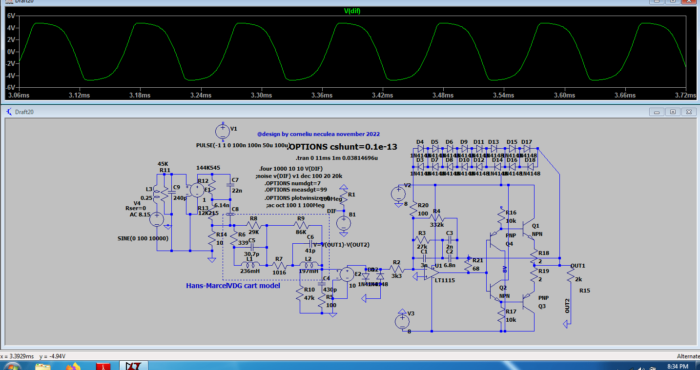

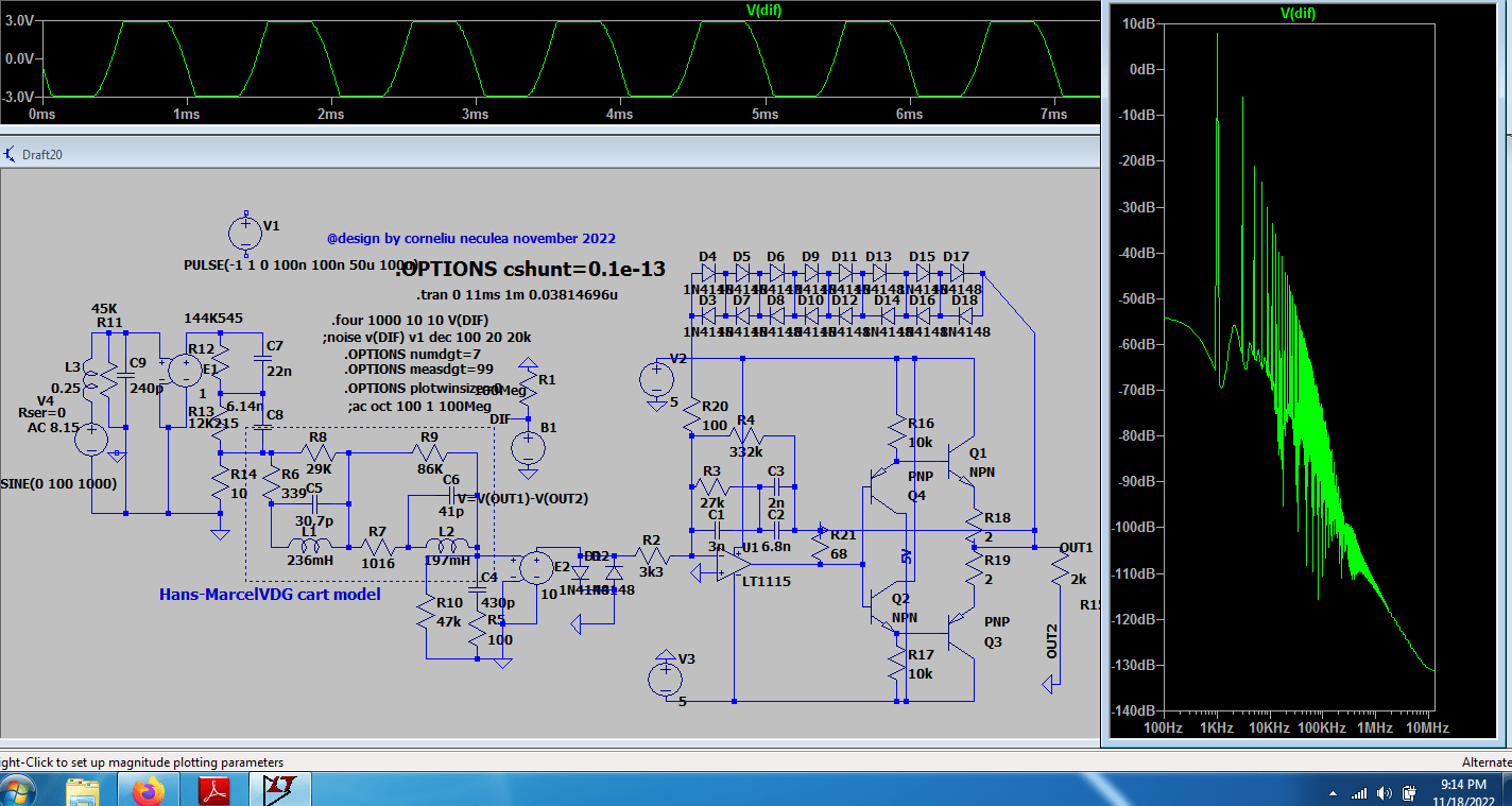

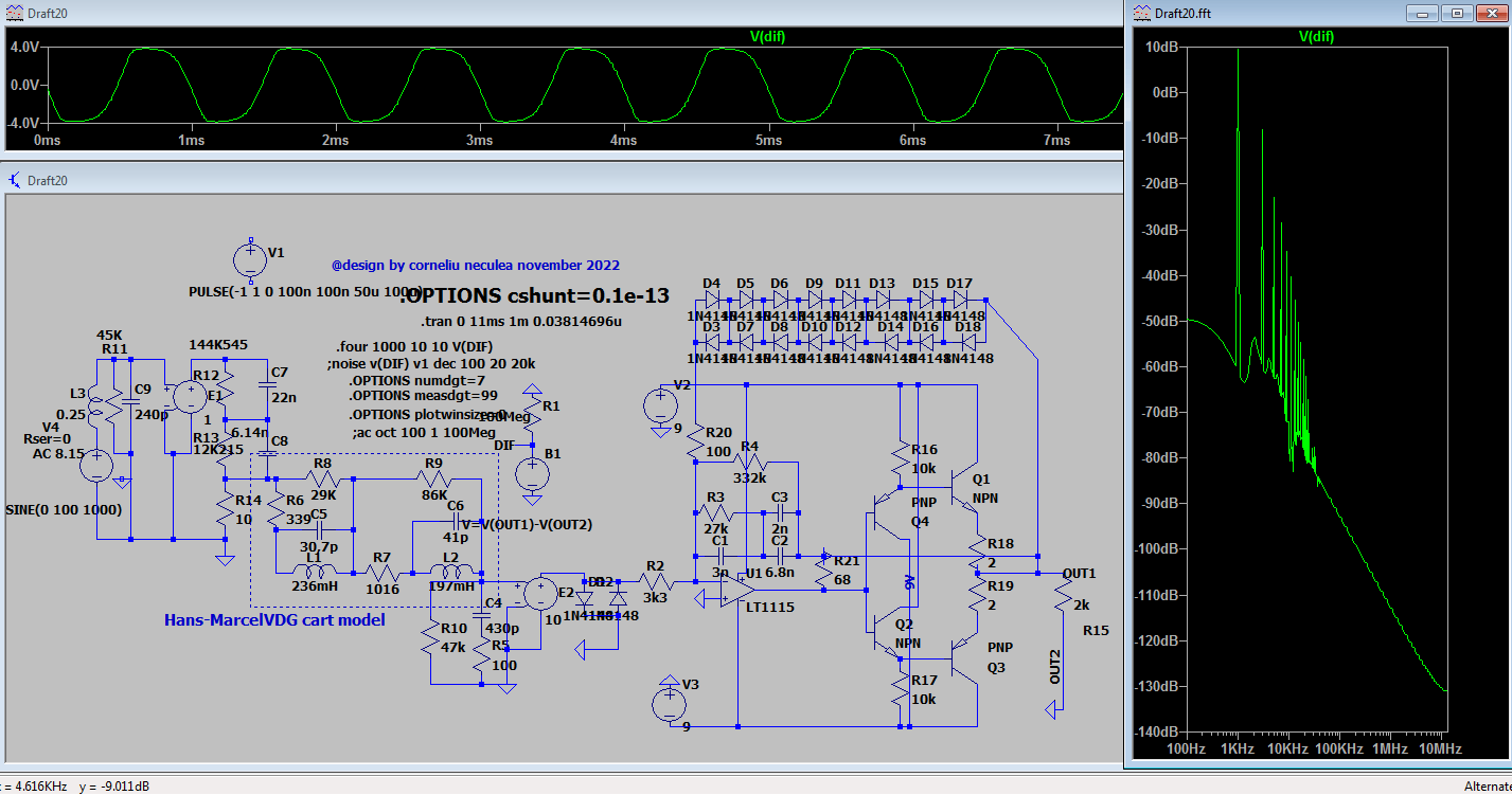

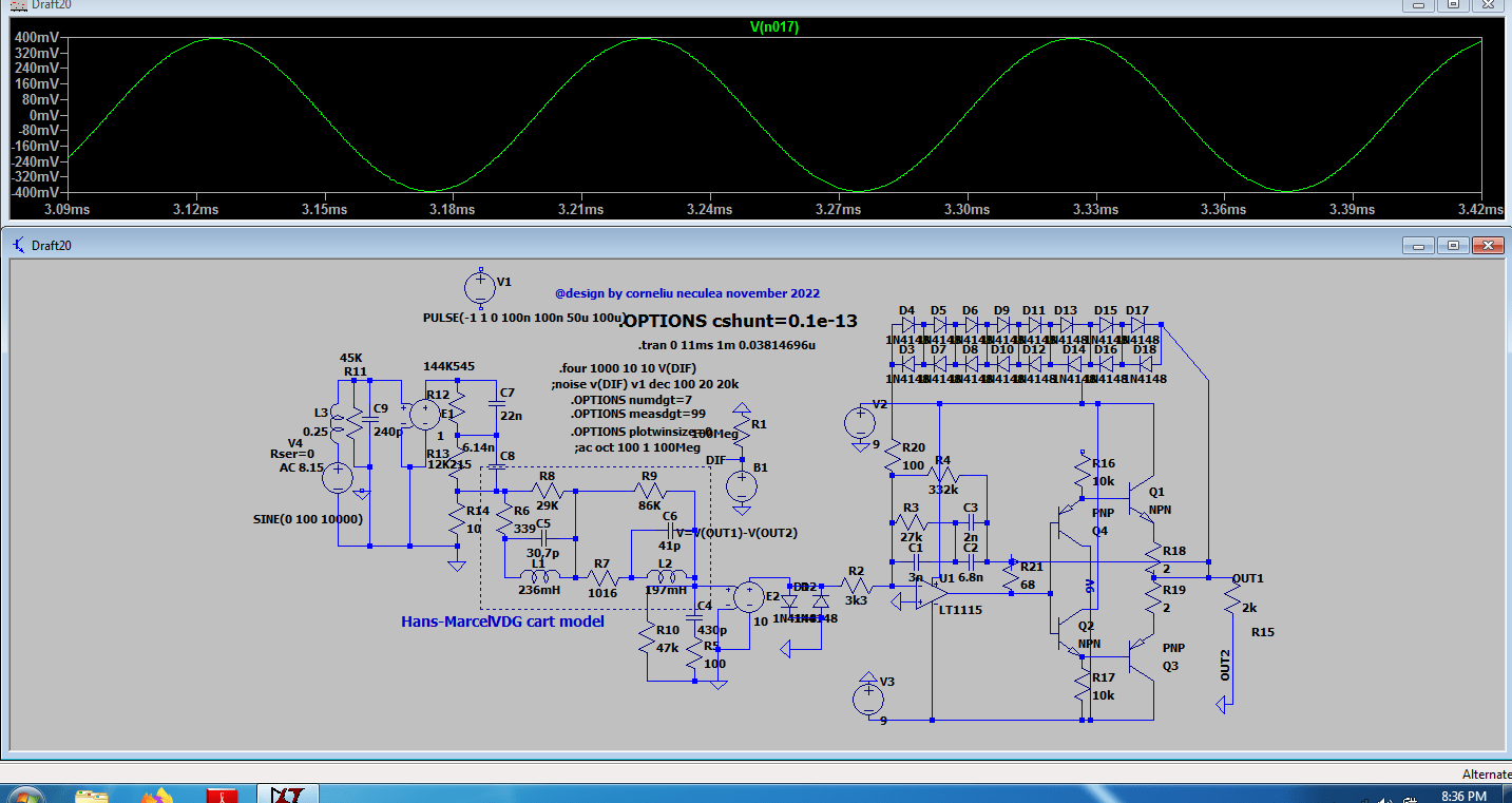

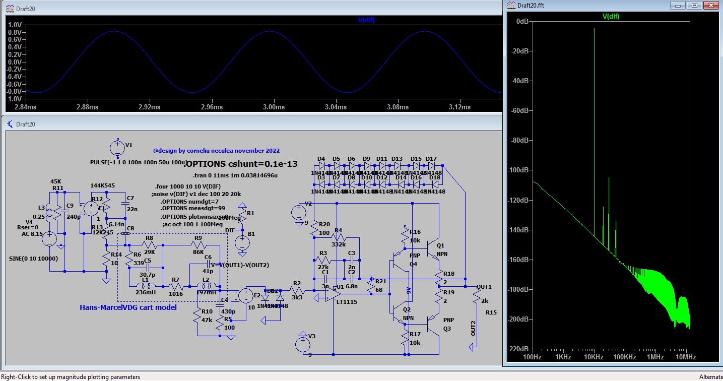

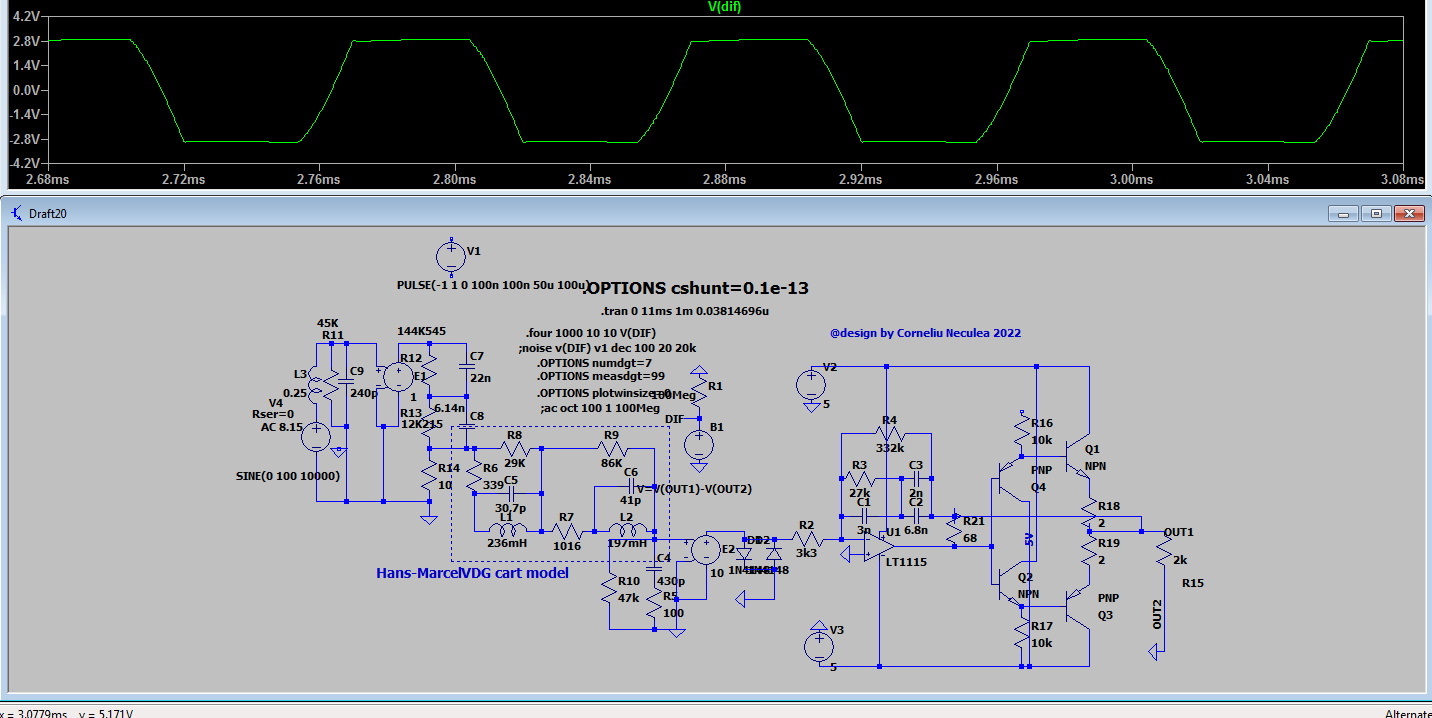

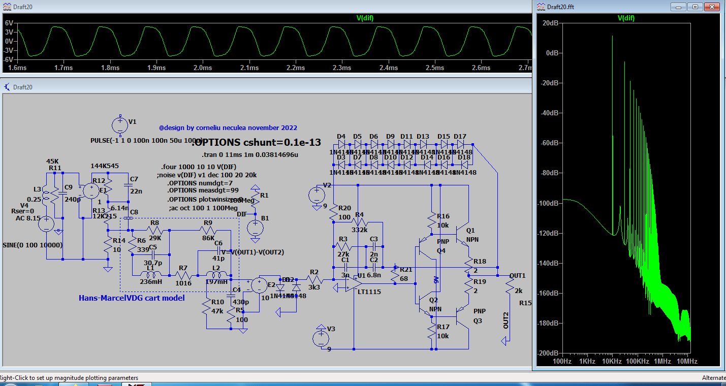

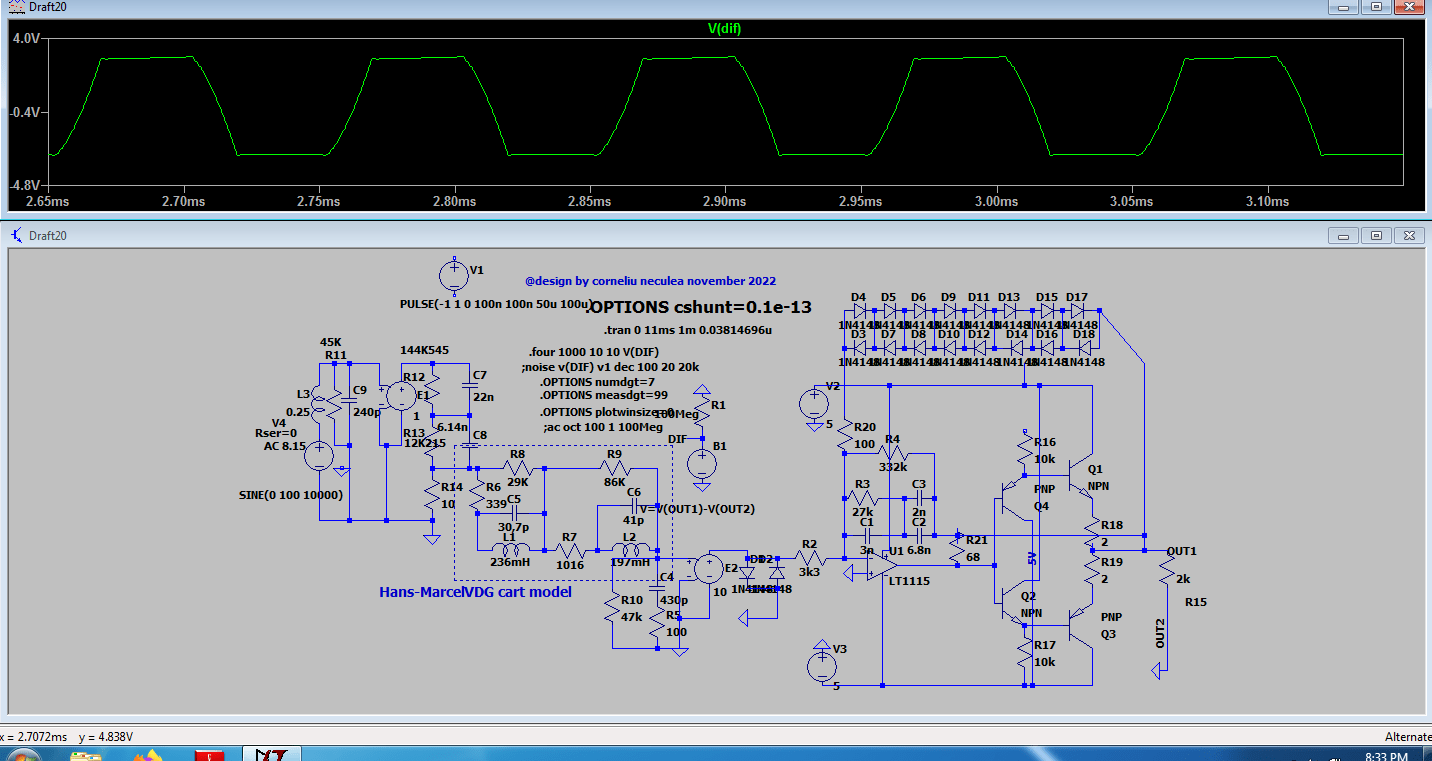

Although I ran most of the sims at 10khz, the behavior at 1khz is very similar as you can see in the last 2 printscreens.You can see a clear difference between a "marshall-esque" type of soft clipping and bare hardclipping caused by 20db higher input signals:Maybe, but not necessarily. If signal clipping cause some sort of instability of the preamp, produced artefacts might be more objectionable than the pop itself. This question needs some experimenting and research.
Further, spectral content of unclipped pop may be mostly in the ultrasonic region, hence inaudible. But again, this takes more analysis
It's not at all interesting how the clip looks - it never happens with good LPs. And with the bad - does it matter how it sounds?
Well...ask an electric guitar player about the types of distortions...And hard clipping does happen a lot with dust on records .Some op amps come back faster from saturation...others not that fast, but all suffer of hard clipping with the right signal on the input.
Just realized one trz in the previous simulations was in the air, but the op amp was doing all the job anyway...ignore the diamond buffer...it's there for a different circuit.I'm working right now on such a circuit so I'm tuned to the subject...

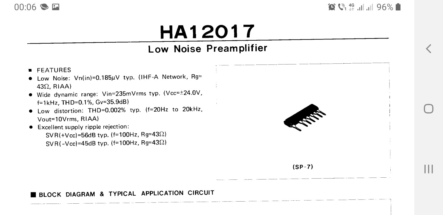

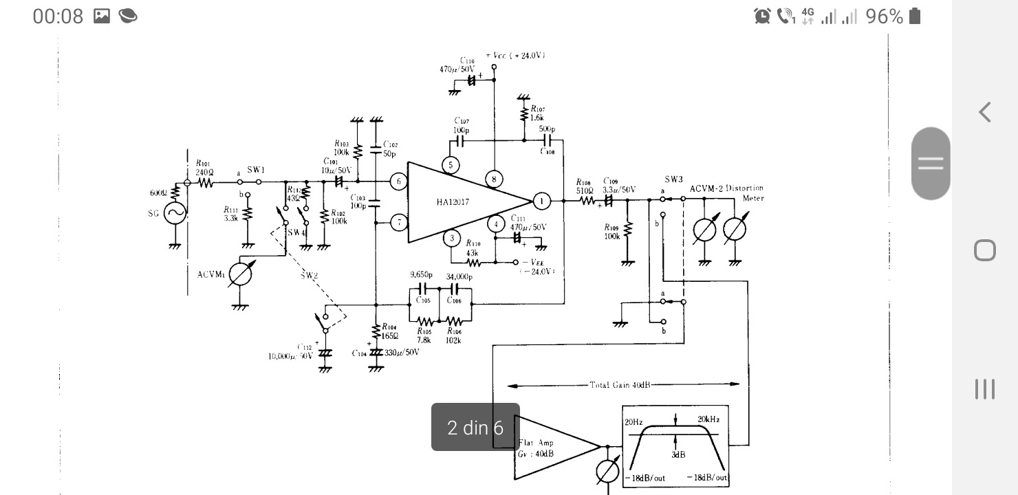

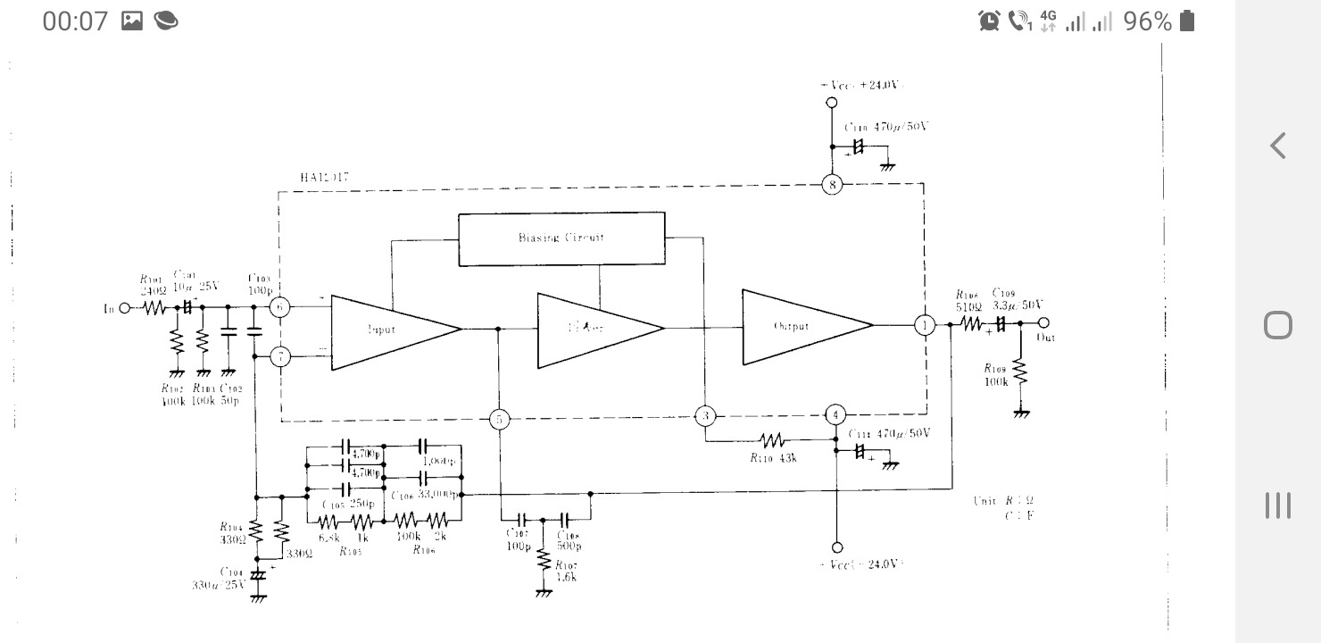

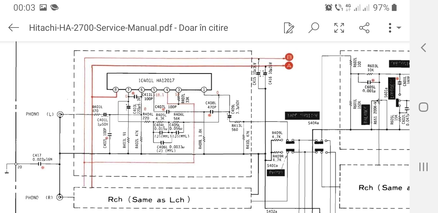

Then I wish you good luck with explaining the reason for this datasheet:
