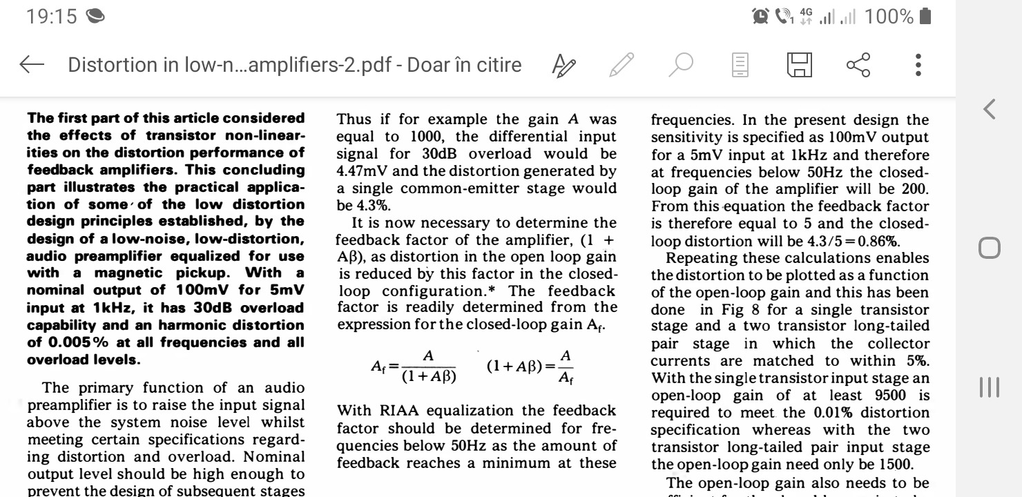

I want to explain how I got to take this guy seriously even before reading Taylor's article for which I am forever thankfull to KCP to have pointed me to:
https://www.keith-snook.info/wirele...d-1977/Distortion in low-noise amplifiers.pdf
My first three phono preamps were based on tubes: ecc83 then d3a so I had no ideea what the maximum real world headroom needs would be.But then I listened a low noise j-fet one in Marantz PM 66 which was later reworked to the original design in Technics SU-V6 and tried with all sorts of op amps.That had +-17.5V supplies and it was the first time I realised I was bothered by the dust on vinyls at 33.3rpm. Yet it didn't bothered me at 45 rpm probably because of the higher vinyl SNR and the higher kinetic energy that the needle can use to remove the dust or just glide over it faster.Not sure if this is the right analogy but when you get over a hole in the ground at a higher speed in your car you glide over it and you don't feel it as hard as at a lower speed.At 45 rpm any phono preamp sounds wonderful. Ask a DJ...
Then I read about DENON poa 1100 harsh scratches on dusty vinyls reported by one user.
Then a friend of mine got a fancy SONY using jfets at the input and reported the same thing.
One day I listened an AIWA C22 which was supplied at +-15V , put out about 300mV at 5mv input yet the dust noise on vinyl became once again unnoticeable...So i looked into it and it was using a bipolar transistor on the input...Then asked my friend with the Sony to accompany me in this assesement of mine and we both realized that all the phono preamps employing bipolar transistors at the input that we tried don't have that annoying sound when playing a dusty record.The germanium ones behaved even better, but had audible noise...
We might be just too lazy with washing vinyls all day...
JLH with his Liniacs also had some very good insights on phono .
I've never been bothered by a phono preamp's own SNR unless it had too bad parts...If some pretends they can hear through the vinyl's own groove noise I can only envy them for having such a great noise reducing system in their brains.I don't...
I'm not saying there aren't jfets preamps that are imune to this thing apparently there are a few who have no such problems, just that they are well thought.
