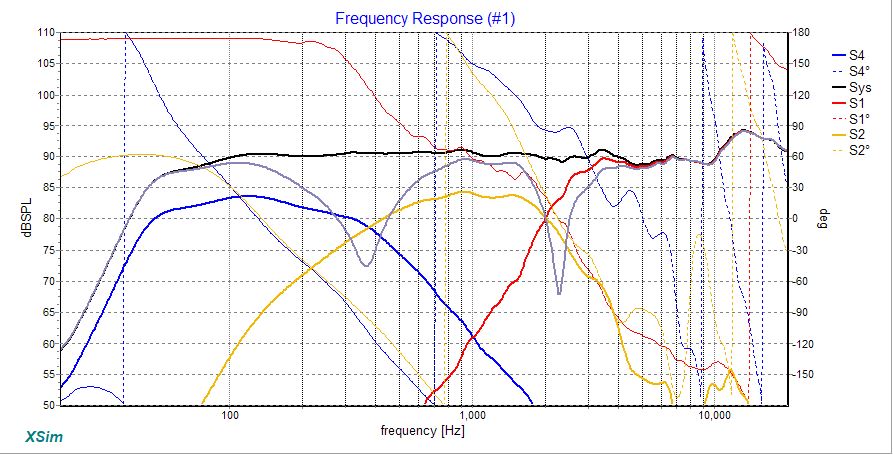

Looking for opinions on my first passive crossover

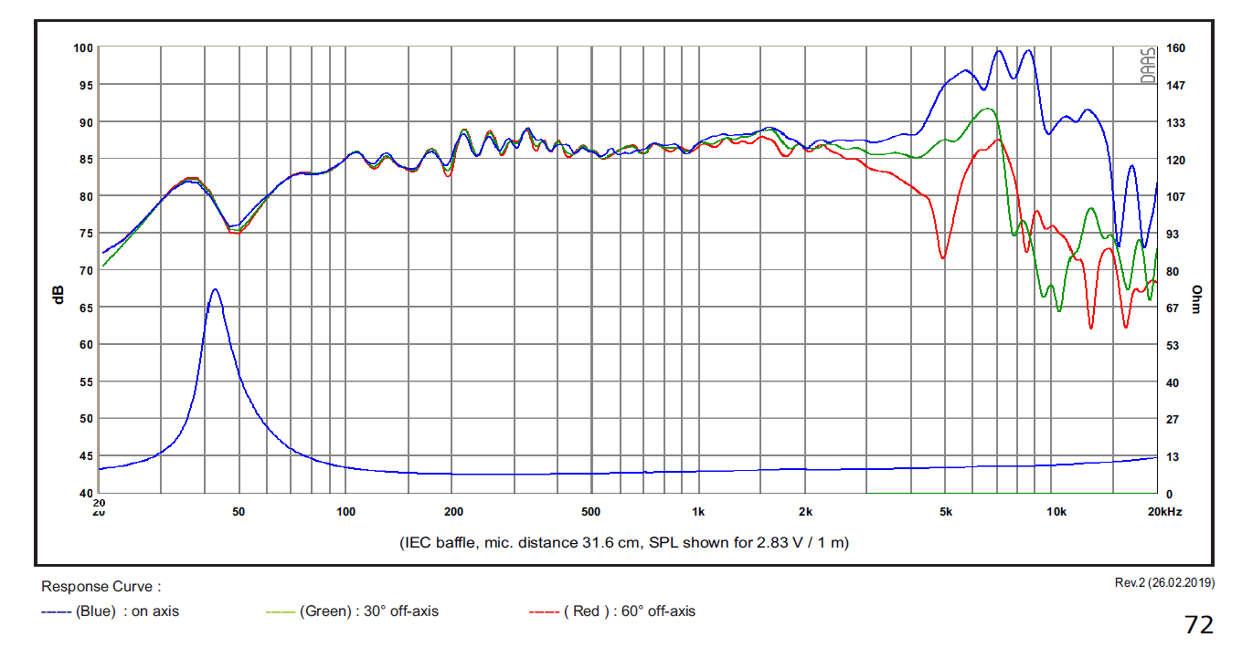

I've not purchased drivers, so really anything is on the table. However, these 3 are what I'm currently focused on.
Overall concept is solid. I would reduce mid driver to 4" or even good 3" for better off-axis response.

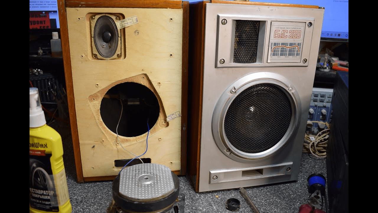

However, the drivers themselves make me slighly mad. How come that ancient mass-produced Soviet 5" mid-woofer is wastly more linear than new SB Acoustics offering, backed by decades of research and (supposedly) hundreds of FEM simulations? In a suboptimal enclosure, no less.
SB15NRX2C30

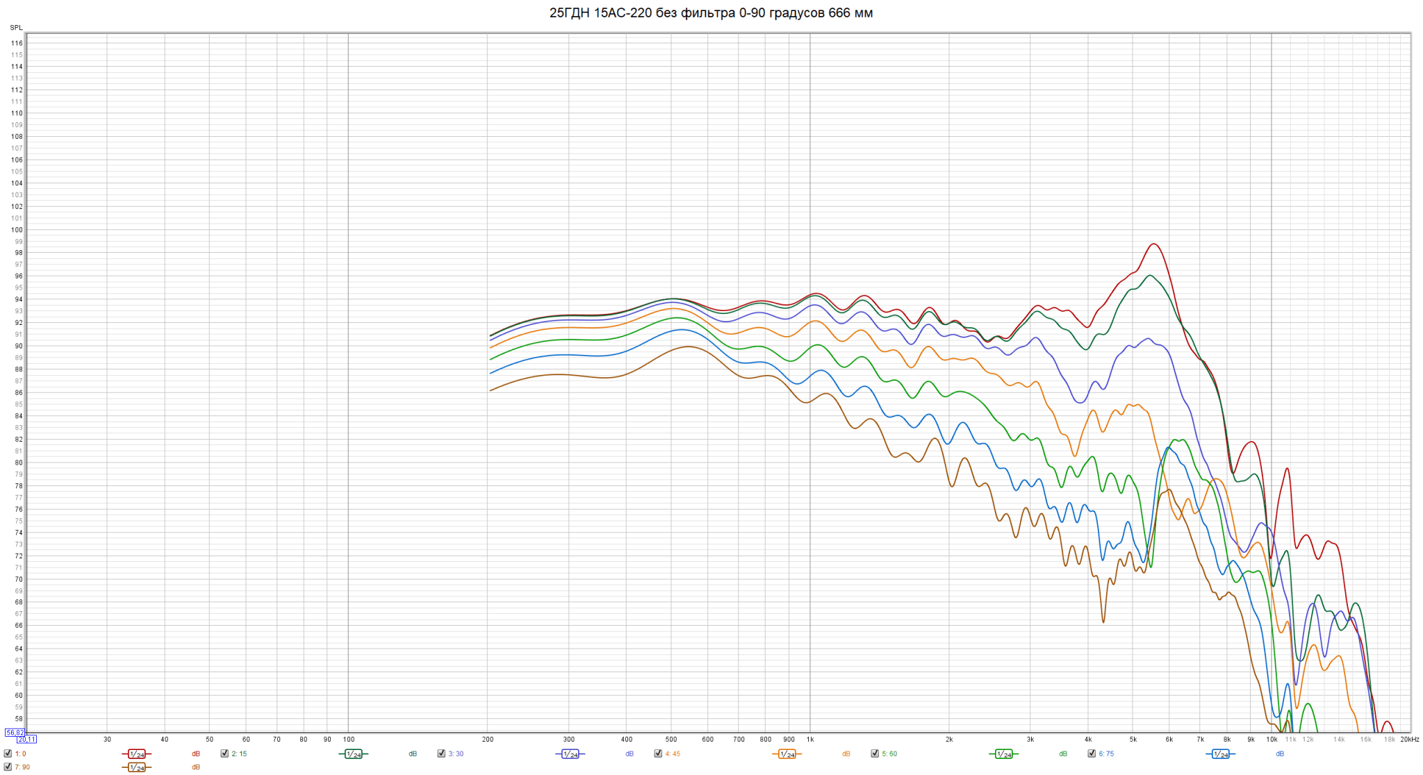

25GDN in 15AC-220, 70 cm, 4.5 ms gate, no crossover
15AC-220

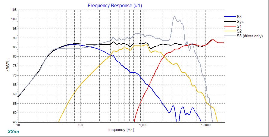

Note the 2 dB per division scale. Even that 5.5 khz peak is not from the driver itself, but from the plastic decorative baffe.

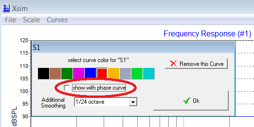

Besides individual driver phase (in XSim on the Frequency Graph, click "Curves", then select each driver displayed and check the "show with phase curve" box and uncheck it for the System curve), we also need to see each driver response to know what the xo points and xo slopes look like and if they are appropriate or not for the drivers chosen.

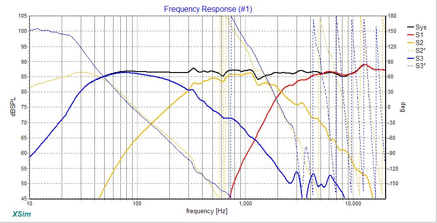

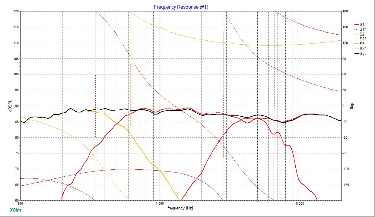

Lots to take in here, but I've attached the FR chart with phase shown (I think). As for your question about the caps, I spent a lot of time searching for single caps and wasn't able to find the necessary values. Since I've redesigned it about 5 times, I'm not going to spend a lot of time doing that again. Once I'm confident that I'm ready to purchase, I'll do some trade off study's on cost versus accuracy and see if single caps can be "close enough".

Looking at the new Response graph:
- use different colors for each driver's response. You can select them in the curve" drop down menu. Better yet always choose the same colors for the drivers, it'll make it easier to read each time.
- yes, you have the correct phase now displayed but it shows that the phase alignment in the 2 xo regions is not too good. They should overlap, line up together, etc, around the xo frequencies, such that when you reverse the polarity on the mid, you should get wide and deep nulls in the summed response at the xo points. As a learning exercise, change your xo electrical order, change some values and/or change the mod delay and observe the results on phase.
- Those aren't terrible xo frequency choices but I think the mid/tweeter and perhaps the mid/woofer xo's are too high. That's a robust tweeter so it can handle a lower xo frequency and that's good because you want to stay away from that rising breakup that you get with that mid starting at about 4kHz. Keep it much lower in SPL in other words. I'd select a xo point closer to 2000-2500Hz and a lower point closer to 300-400Hz.
Just got to so disagree with this statement. Every time someone is working up a xo regardless of whether or not the files are accurate, you are learning how to use XSim and how to design a xo from scratch. That is extremely worthwhile for a beginner.

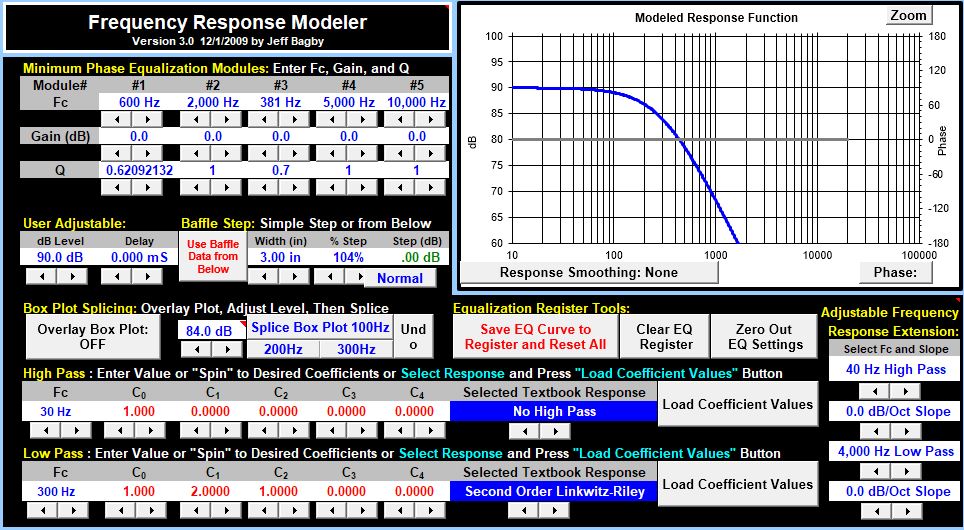

Okay, I downloaded the response modeler. I must say it's a bit intimidating. If I understand correctly, one goal is to take my existing FRD/ZMA files and modify with the baffle effects based on my enclosure design. I then import back into xSIM to see the impact on the system and (If necessary) modify to get decent FR and phase plots. Is that correct?
My problem is that my baffle isn't able to be modeled with the standard rectangular speaker box. I didn't see an option for significantly changing the baffle. Did I miss it or is the standard speaker box the only real option?

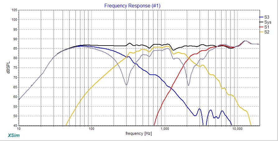

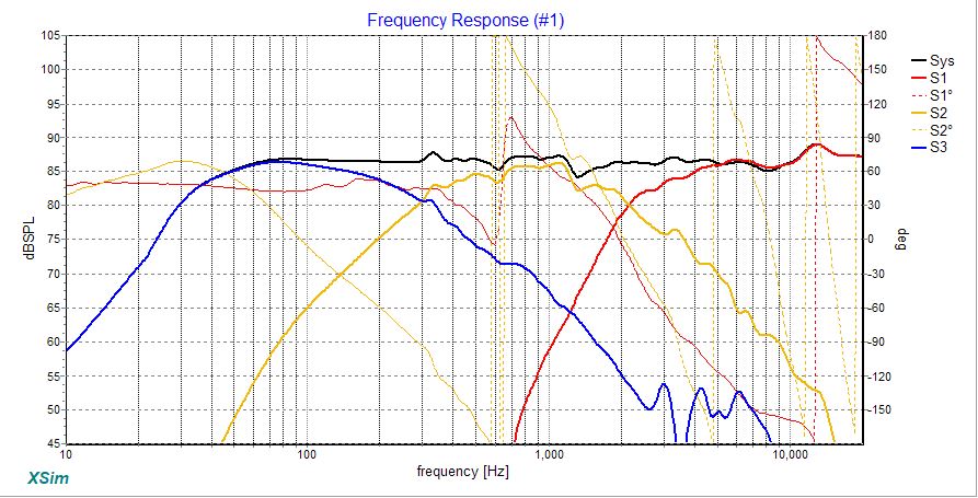

Here's an 3-way example with decent phase alignment in the xo regions (3 graphs presented for clarity):
Woofer/Mid (quite excellent alignment both above and below the xo frequency):
Mid/Tweeter (very good above the xo frequency; not quite as good below):
Mid with Reverse Polarity:
Sim is with spec sheet responses using the SB WO24P-8, Satori MW16P-8 and the SB 29SDAC with all baffle and box effects included. Electrically, the tweeter is 3rd order with everything else 2nd order, plus a few little eq and phase adjustment filters as well.

Here's the SB WO24P-8 in a 3-way sim. Grey is the raw response with box and baffle effects included and blue is what you get when you add in the xo filter. Granted this is just a sim with spec sheet info and not with measurements, but my expectation is that this is probably what's happening with the Salk speaker.

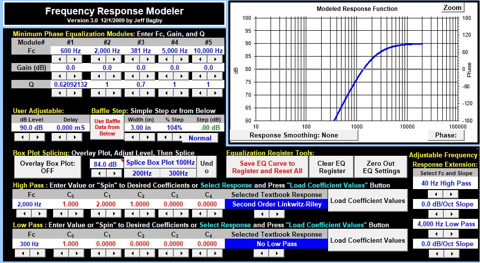

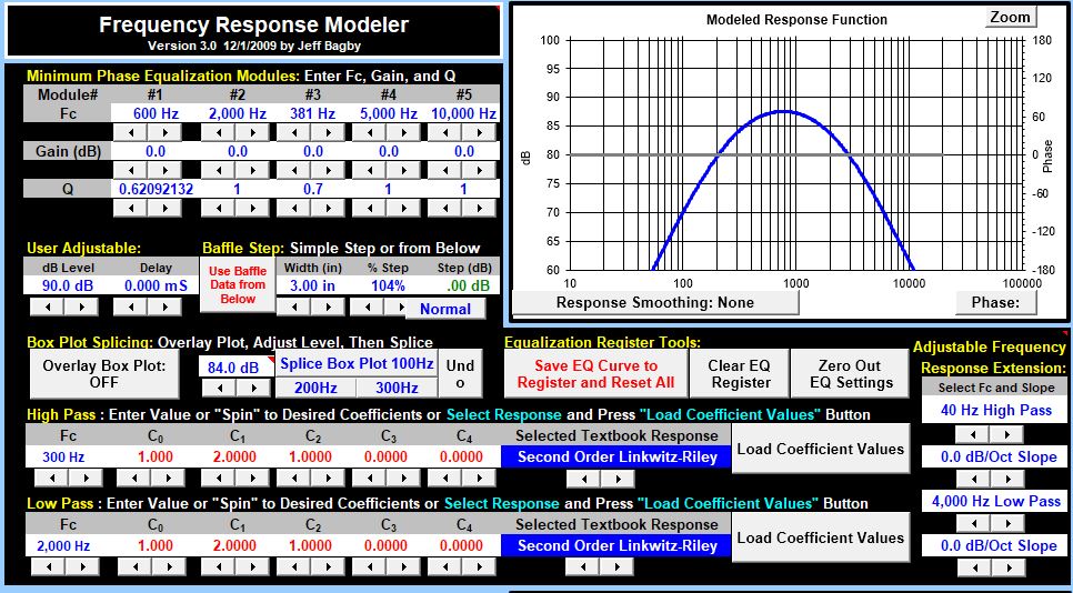

Yes, the program is loaded with utility that can overwhelm at first but unfortunately the diffraction modeling doesn't allow for very complex designs. Like motokok suggested, the Edge offers more flexibility with shapes but ironically doesn't allow for edge modifications. So you might try the baffle diffraction module in VituixCAD which allows for both. It's another quite intimidating program for beginners though but you have the option of just using that particular model and nothing else.
Response Modeler does however also offer box impedance manipulation which is often overlooked in the process. The upper left EQ module along with the User Adjustable baffle effects module can also be very useful for adjusting for different speaker placement options.
For target filter creation, use the High Pass and Low Pass functions in the upper box. First make sure that both the FRD Data and EQ Response modules are clear such that you have a single flat line in the Modeled Response Function graph. Then you do something similar to the pics below for a 3-way, saving the responses each time. Then in XSim, create 3 other new drivers that remain electrically unattached to anything and then import the target filters as those drivers' frequency responses. Lastly, display them in XSim by selecting the 'driver only' option under 'Curves".
Given your goals, I wonder if you might be able to achieve both your aesthetic preferences and minimize baffle edge effects with a design something along the lines of speakers by Avalon.
