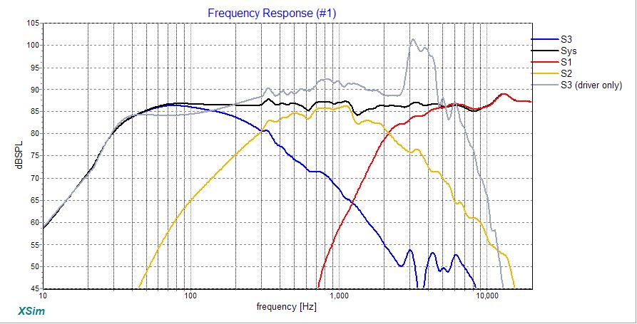

Thanks JReave, this is exactly what I was looking for. Now I'll just have to learn to manipulate the crossover to achieve results like these and I'll be golden.For Dave Bullet, here's a little trick that can sometimes work to gain you a couple dB of sensitivity in a 3-way:
- tune the woofer box response so you are quite flat right to the roll-off or even with a little boost right before it
- now when you insert the woofer filter and you happen to get a couple of dB boost right before the roll-off due to the interaction of the filter and the driver's impedance peaks (doesn't happen with every driver and can certainly depend on your chosen xo frequency), you don't need to compensate for it but instead can use it to raise the overall sensitivity of the design and to create a more gradual LF roll-off at the same time (which is usually more desirable but that can depend on room size and speaker placement).
Here's the SB WO24P-8 in a 3-way sim. Grey is the raw response with box and baffle effects included and blue is what you get when you add in the xo filter. Granted this is just a sim with spec sheet info and not with measurements, but my expectation is that this is probably what's happening with the Salk speaker.

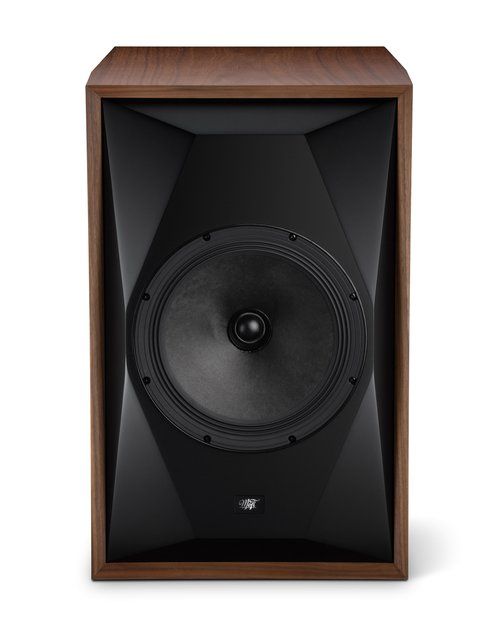

Given your goals, I wonder if you might be able to achieve both your aesthetic preferences and minimize baffle edge effects with a design something along the lines of speakers by Avalon.
- how to model complex 3D baffles? I don't know; not sure any hobbyist software can do this; hence, just build and measure - compare responses vs a rectangular test baffle; probably the easiest and only way to determine viability - maybe you can just buy dirt cheap drivers of similar diameters for this purpose (e.g. Parts Express buyouts or ebay fare - $10 or so)Thanks motokok, this is some very good information. I downloaded edge and was able to do some quick modeling of very simplistic baffles, which brought up several questions. 1) it appears all you can model are 2D baffle designs. There are a few 3D designs I'd like to look at. For example, the F117 inspired design would have 3D Facets positioned around a circular driver that stands off the baffle a bit. Each facet would have height, length, and width. I don't see how that could be modeled. Another example would be a driver mounted in a bezel causing it to stand off the baffle an inch or so. How does that compare to a driver flange mounted in a recess (Most common design) or one that stands off the baffle by the thickness of the driver flange (That's the way my Thiel drivers are mounted)? 2) Is the compensation circuit real? Even the default baffle on a new file shows an inductor value in the 1000s of mH. Seems a bit unrealistic. 3) Once modeled, what do you do with it? I know you can save it as and edge file, but I couldn't find any other ways of using it. What am I missing? Anyway, thanks again for all the info.
- something to be aware of, e.g. on a tweeter with high frequencies (shorter wavelengths than the woofer) - every single nearby edge will diffract the sound to some degree - this is why complex, many angled baffle shapes are thought to be undesirable, or rather, avoided cause they are difficult to predict - empirical results will close debate

Yes you are right. Either use a higher Q sealed box or higher tuned vented to create a peak at the cost of possible F3/6/10 extension, which some might prefer depending on listening environment and low end support (subwoofers).For Dave Bullet, here's a little trick that can sometimes work to gain you a couple dB of sensitivity in a 3-way:

Faceted baffles work. They reduce diffraction and improve off-axis consistency. For a simple design you can copy DXT-monitor:Think of a front baffle full of facets mimicking those of the stealth bomber.
https://heissmann-acoustics.de/en/dxt-mon-182/
Complex shapes benefit from BEM modeling.
You need AKABAK/ABEC or Comsol for 3D acoustic baffle simulations. Quite a high bar for novice, leave it alone for now.Could that be modeled with this tool (or any other tool for that matter)?

Also, Mofi's faceted design -- note that it's still basically a box. I don't know how closely this matches the mention of drivers "standing off the baffle"
Heissmann also has a short article on baffle designs that may be of interest

The stealth bomber tries to limit angular coverage from spectral reflections. Not at all the same as a baffle.Think of a front baffle full of facets mimicking those of the stealth bomber.
The main benefit of facets as used here is that they're easy to cut. Roundovers are the ideal in this situation.. However there is a special case use of facets called a 'secondary flare'.
