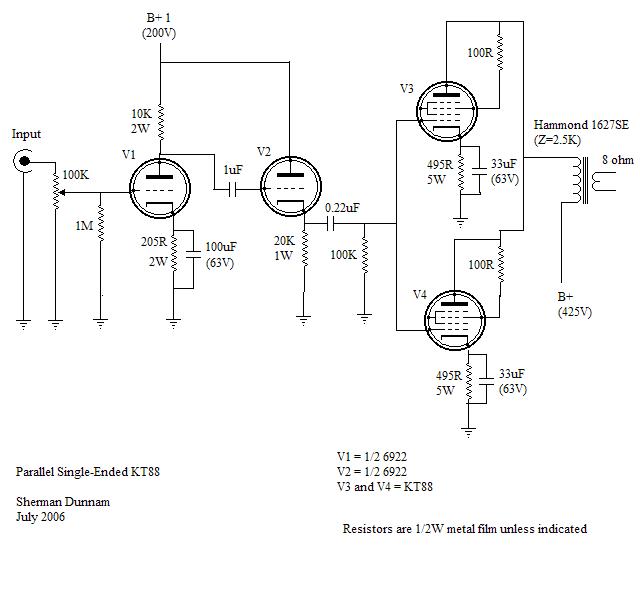

Next, you need to consider Miller capacitance of two KT88s in parallel. A 6N1P or equivalent might have a hard time driving paralleled KT88 tubes so that would mean adding a driver stage that could handle it. I think (though I haven't tried it) that a simple cathode follower buffer between the 6N1P and the KT88s would do the trick.
In the end you would be adding another tube, possibly another 6N1P or maybe a 6922 to act as the buffer/driver. A single tube would do it since the ones I mentioned are dual triodes. Consider the current draw of your buffer (should be low but there will be current) and the current draw of your buffer's heater when planing the PSU.
I was in the planning stages of a Parallel Single Ended KT88 amp and drew a few schematics that I think would work but in the end decided that if I was going to go through that effort I'd go with a push-pull KT88 setup. Basically the same effort, double the output (in triode, more in UL and even more as a tetrode).
any chance of a revised schematic with PSE KT88? 🙂
thank you.
thank you.
Here is what I came up with. Keep in mind that I never built this circuit but I believe it should work.
