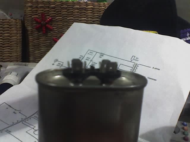

I am working with some oval ASC oil caps for a 300b project, which I believe I see on your chassis. Can you tell me:
1. How did you polish them (or did you)?
2. How did you mount them?
Sorry-- I know this is a hijack with some basic, newbie questions, but I gotta, gotta know.

Kofi,
Polished the oil caps using 400 grit, then 1000 grit sand paper, then I used very fine steel wool.
I cut the holes on the aluminum plate the size of the oil cap, then mount it from underneath going up until the lip catches the underside of the aluminum plate (you will notice that there is some sort of a lip on the end of the cap towards the connectors, see picture below). Then I fashion a pieces of angle bar that pushes the caps upwards and then I bolted it to the wood plinth. (I got the idea from one of the posts here.) I will take picture of how I mounted during the day so I will have enough light and post it here.
