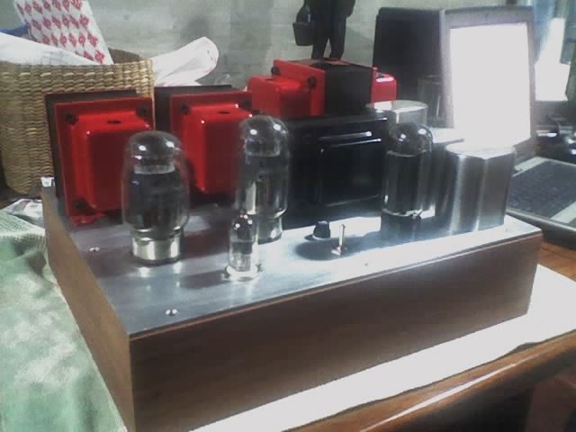

I started building this amp, all iron was custom wound by a local company here in the Philippines (those with red endbells), except for the hammond 193J choke, here is a picture of the amp with the topside populated, but I have not done any connection yet:
