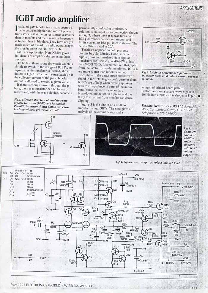

The IGBT can be pressed into service as an analog amplifier output stage. Question is, why bother, beyond just trying to make a point? MOSFETs and BJTs have that territory well covered.

I think the Toshiba IGBT parts went away due to the difficulty in using them.
I think only a couple of manufacturers got product to market. Forte and Threshold under Mike B and maybe Counterpoint.
The oscillation proclivities of Mosfets and the thermal runaway of bipolars.
The market spoke and they went away for linear use.

I don't have experiences especially with IGBT for an audio amplifier but as far as I know about IGBT's there's also a problem with the current tail when "switching off" the IGBT, eg. their switching off capability is far from ideal which is the reason that they haven't been used even for SMPS at 100 kHz.
Those I have worked with are proportionately huge 6 or 7 pack for inverters and were switched with a frequency of 5 kHz.
Moreover these IGBT's in switching application do also need a dead-time generator in some applications just because of the current tail phenomenon otherwise the start to "burn".
I checked up those Toshiba IGBT's mentioned in this thread and I can't say I'm thrilled over when reading the datasheet, IGBT's are known for their current tail and not specifying it is IMO like hiding a disadvantage!
I found a datasheet over GT20G101 which I dont know how close it is to GT20D101 besides from difference of the letters D and G, but this IGBT have a typical fall time of 4 uS and turn off of 4,5 uS and it don't "sound" good to me.
Eg. I suspect the current tail phenomenon with IGBT's can give some crossover distortion at higher audio frequencies and more else warm up IGBT's, but this should be checked wheter it could be so I don't want to make any 100% claim here at present before the issue is investigated further.
I think it would be much better to mimic an IGBT by using discrete BJT's and FET's and thereby controlling the built-in FET's drain connected to the base inside the IGBT etc if IGBT's is a must...
Anyhow here's an article of another IGBT amp with also a simple latch-up protection circuit: https://web.archive.org/web/20070223121523/http://www.audiodesignguide.com:80/tra/igbtsch.jpg
