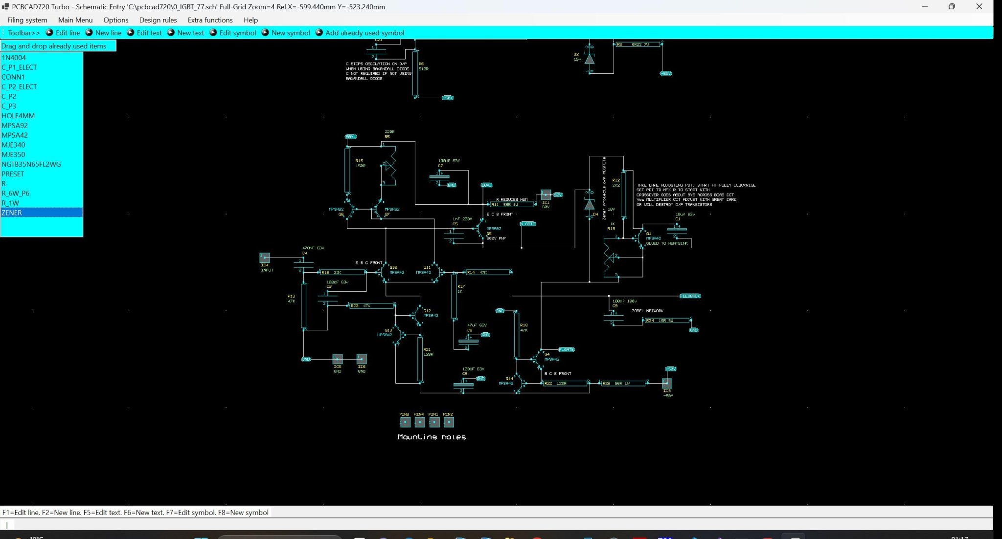

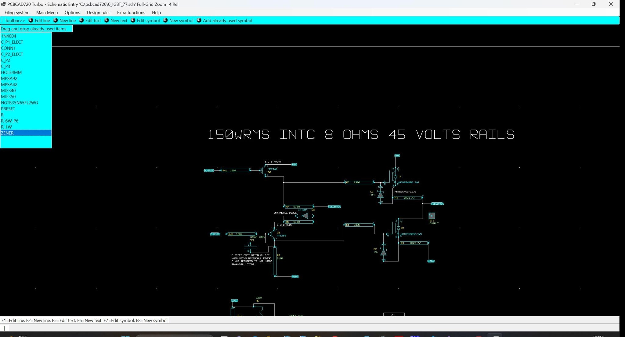

It peaked curiosity , but they are common for 600 volt and up fast switching.
all there is now days is n channel.
Agree rather just build normal bipolar amplifier.
But the thought is what counted.
I checked a few feasible devices. but all 3 had models that didnt even work.
and be stuck doing a Quasi. which dont do well with mosfet type behavior
So yep, reminds me of lateral stuff , not really fun.
but it did sound cool for a min
