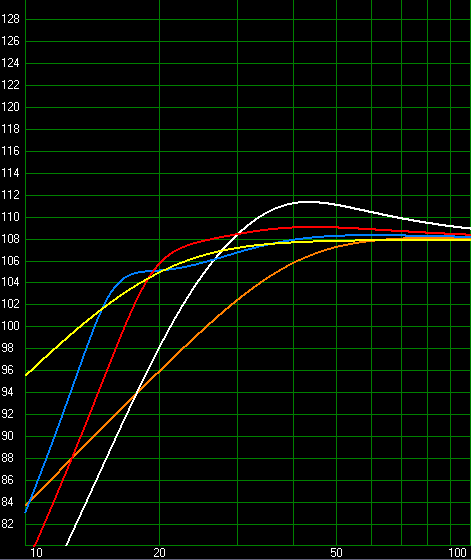

After modelling Simon's suggestion with the 150L box, I found some other alignments.
The chart shows your current box 72L tuned @ 29 Hz with an ugly looking response - shown in white. Orange - your current box sealed F3 @ 36 Hz - not bad but the Q is a bit high at 0.79. Use a LT for this box - yellow. You can now make the box smaller 28L, if desired and get the same response with a bit more eq - I haven't shown this as it will be essentially the same.
Now for some vented alignments. Red - 120L tuned @ 22 Hz gets F3 @ 20 Hz - almost identical to the Linkwitz transform. You could in fact make the box smaller with the same tuning and the result will be the response will roll off to to tuning point, which may in fact integrate with room gain better, depending on your room. 90L >>> -5 db @ 20 Hz which is similar to room gain in a lot of rooms.
Blue shows an EBS alignment for ultra deep bass - 140L with 18 Hz tuning. This may in fact get an inroom F3 as low as 15 Hz!
Now for max SPL. What you have now will sound the loudest as it's tuned in the midbass. The sealed box has the least SPL as you can see. The 120L vented box actually looks the best of them all from an output point of view. Note: max SPL here is based on the alignment and driver excursion limits. Getting this output depends on the amp as well, and the driver being able to handle the power thermally.

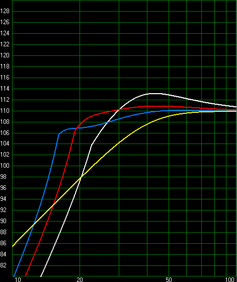

Now let's get a bit more real-world. Put in 200w and lets see what we get. Down to 40 Hz, there is barely an audible difference from a frequency response point of view. (excluding what you have now).
For music this is quite adequate. But what comes next will be telling (cone excursion) ...
The LT box now finds its limits about about 33 Hz. Below this you run out of excursion. This won't happen on much music however. Most will be above 40 Hz. Without the LT you won't run out of excursion with this much power (200w) at any point. The two vented boxes will run out of excursion below tuning, as expected. However this will only happen below 20 Hz, where you can use a rumble filter if desired. A 2nd order highpass at 15/16 Hz will prevent either from overexcursion.
So what's the conclusion?
For home theatre the big vented boxes are impressive. For music, however, there isn't much reason to choose a 150L vented box when you can get a 28L box with a barely a noticeable difference in output and extension.

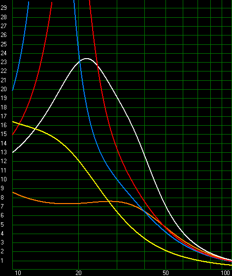

One more chart - group delay. There is debate about whether this is audible. I believe that GD is most critical above 40 Hz, however excessive levels below this are probably not a good sign. If you take GD to be an indicator of "tightness" and control, then the LT version is clearly superior.
I've shown a LT with a Q of 0.707, but if you make it 0.5 for the 28L box you get a bit more rolloff which might match room gain a bit better. The GD is also even lower than the LT box shown (although in the less critical sub 40 Hz range) and the transient response might be slightly better, or at least in theory it should be. This would be my choice for music.
