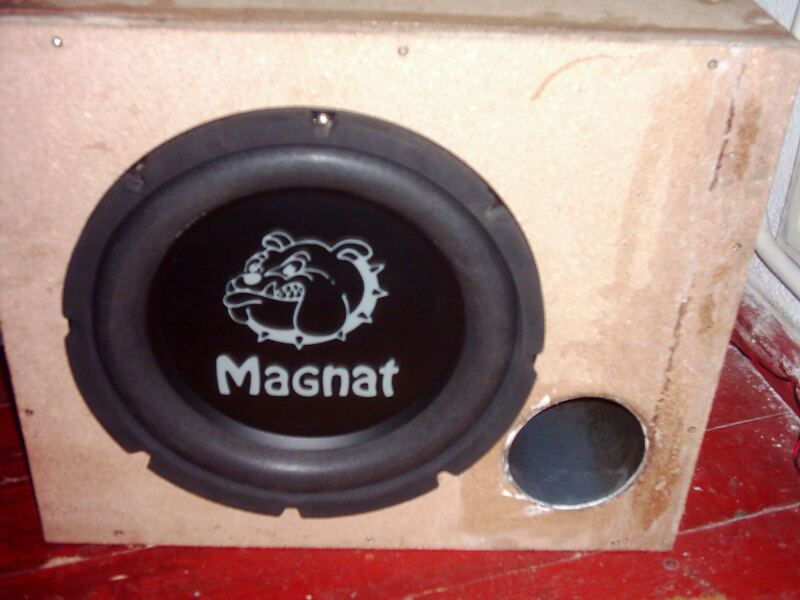

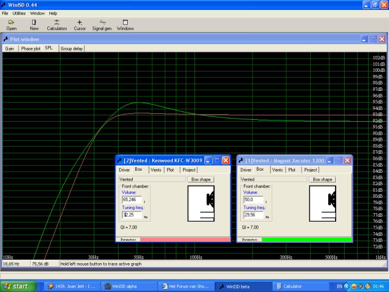

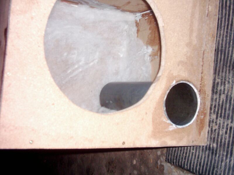

red said:Hy guys the version of winisd I used was the last and i had those problem...
Anyway I finally had the money, and the nerve to buy the Magnat. I made a box just for test(i got prety much equivalent for mdf), that is very close to what the producer recommends and to tell u the truth i was a bit disapointed.It has indeed a very powerful kick (every thing rattles) but i think it lacks something I have no ideea what to call it...perhaps delay...
I mean it makes boom instead of booooooom.
Here is a pic of my mad dog how I call it. Remember that it is just a test box that disapointed me and I'll try to figure out what to do...
That sub of yours is made for a sealed box. If you put it in a sealed box, and put it in the corner of the room, it will have good bass.
My home subwoofer is a 12" 4 ohm car subwoofer.
Audio X 350WRMS/700 peak with an FS of 25hz
This woofer is designed for a 1 cubic ft box.
My amp is an old stereo Sharp chipamp (STK4231-2) that puts out over 100w/channel x 2 in 8 ohms, and I paralleled the channels to make it drive a single 4 ohm load with 200W. It's connected to the subwoofer out jack on my Receiver.
Since my amplifier is smaller in RMS than that sub, I wasn't worried about max excursion, so I put it in a 1.25 cu ft box instead of just 1 cu ft to give it some extra bottom end. When I play 20 hz test tracks, I can feel it.
I put the sub in the corner of my room with the woofer facing the wall, and the phase is reversed so it doesn't cancel out the bass from my main speakers, but instead accents the bass and also adds the needed bottom end that my 4 8" front speakers lack below 40 hz.
Car subs make great home subwoofers, you just have to give them the box they need. (They are designed to play in small boxes)

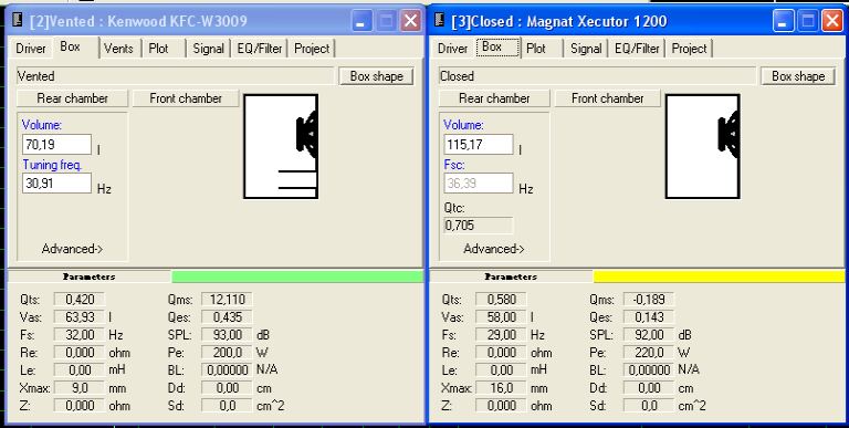

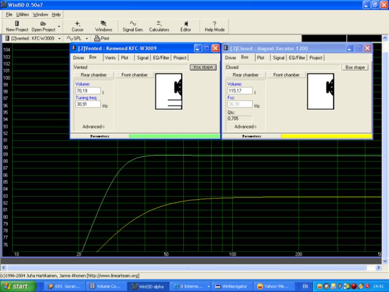

EWorkshop1708 , You are wrong!
See:
http://altor.sytes.net/xlam/maxpower.gif
you reach your 200W at ~60Hz, and below - maximun allowed power is rather smaller!
