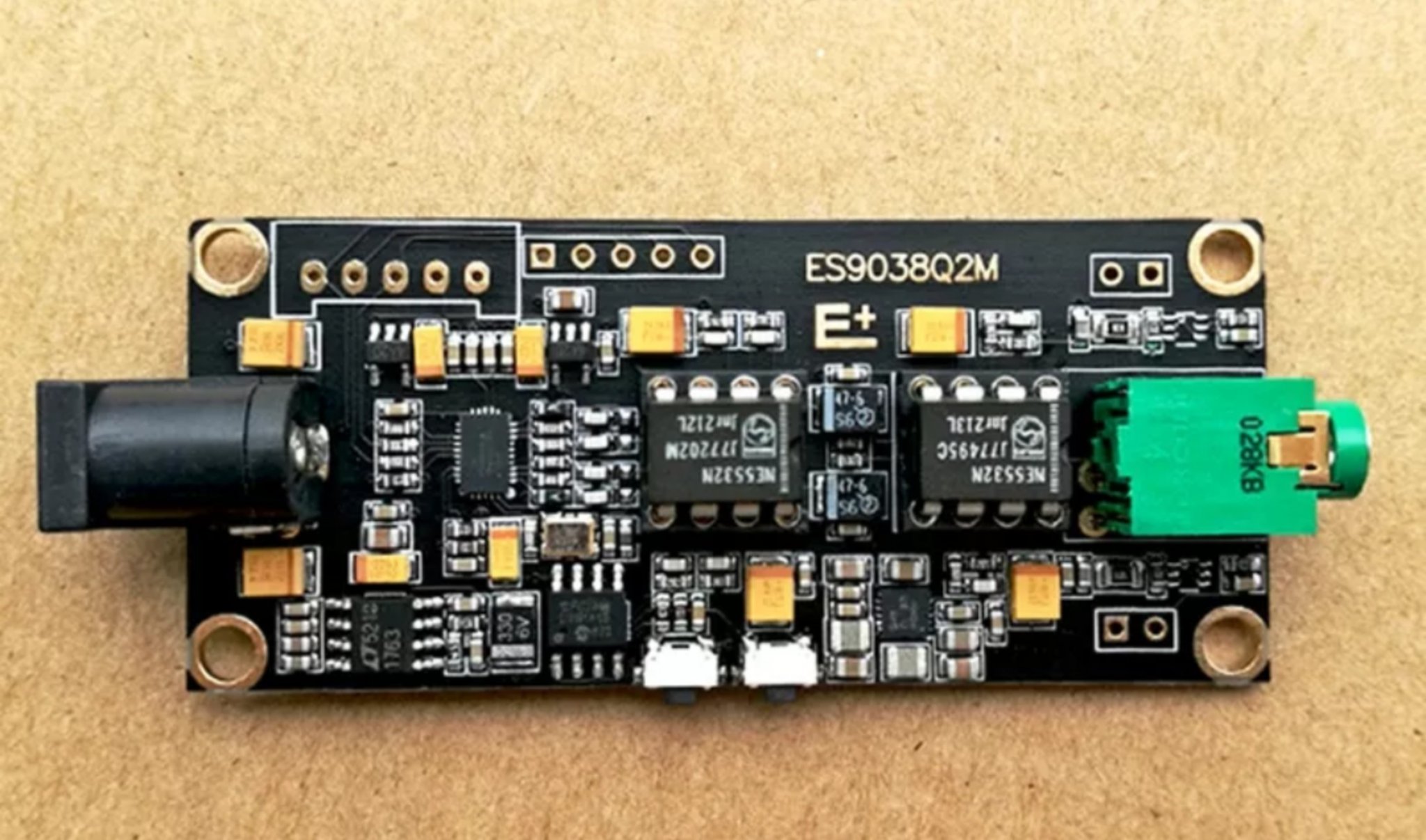

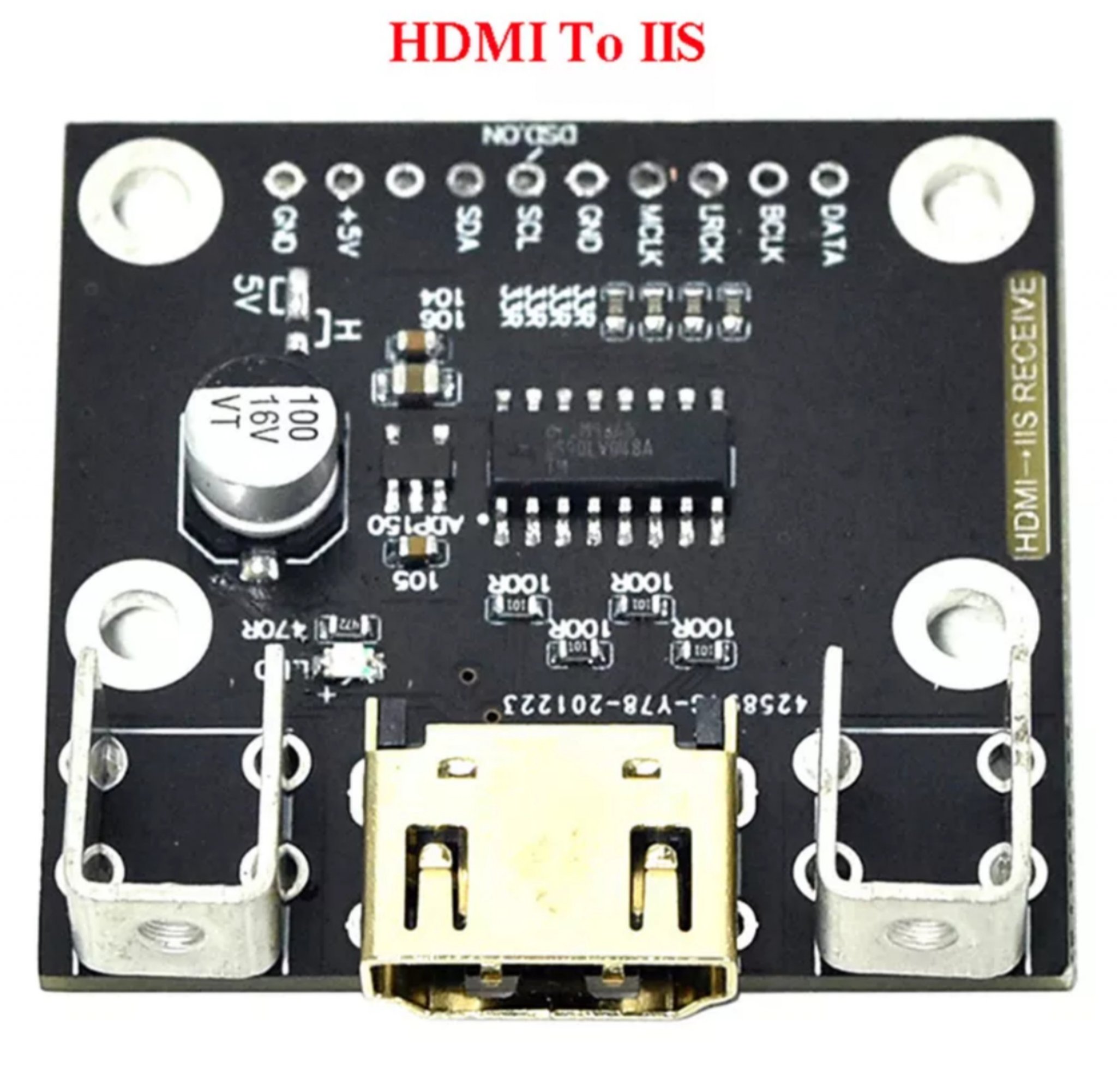

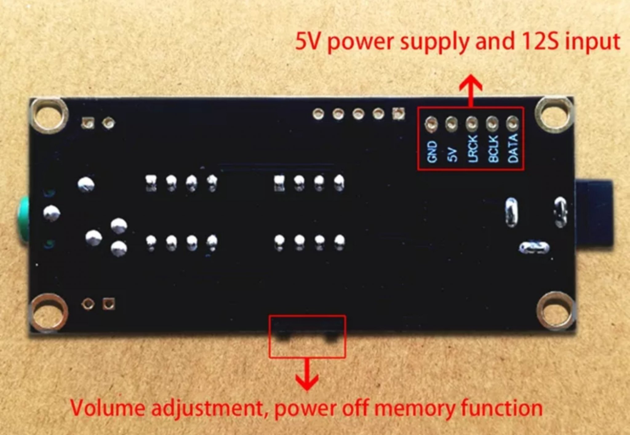

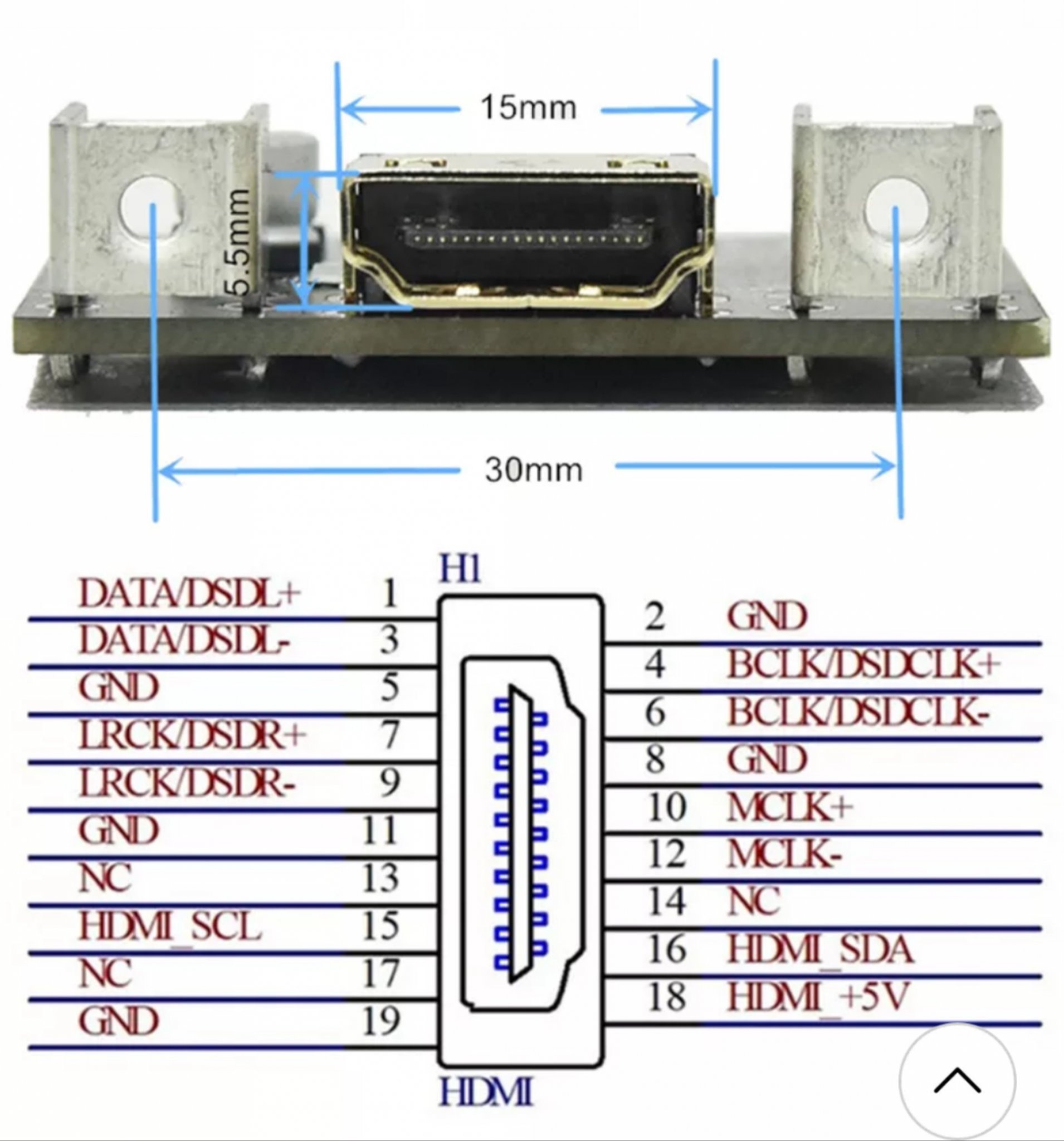

Trying to make strimer fumes about chromecast 3.0, HDMI extractor to i2s, and daca es9038q2m.
The DAC I wanted to use does not have an MCLK input, so I did not make this connection.
Unfortunately, my configóracja does not work, complete silence.
All suggestions welcome.
-Chromecast checked.
-Dac works with RPi.
-The extractor used for the first time.

yogilla62, you need an HDMI audio extractor, such as this -
https://www.ebay.com.au/itm/164374099879
I cannont find a board-only version, probably because the fully cased versions are so cheap. I think if you open up the unit you will be able to tap into the I2S lines between HDMI decoder chip and DAC chip, to feed off to your own DAC's I2S inputs.

Thank you very much for any suggestions. After thinking about my mistake, I started looking for a real extractor and I think I found the right one :
https://www.audiophonics.fr/en/interface-modules/hdmi-to-i2s-spdif-digital-interface-p-13415.html
