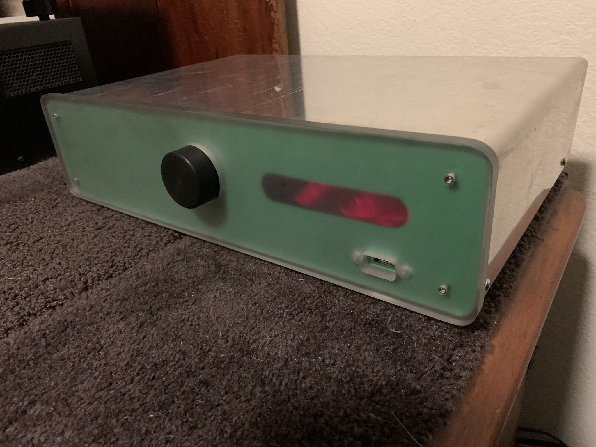

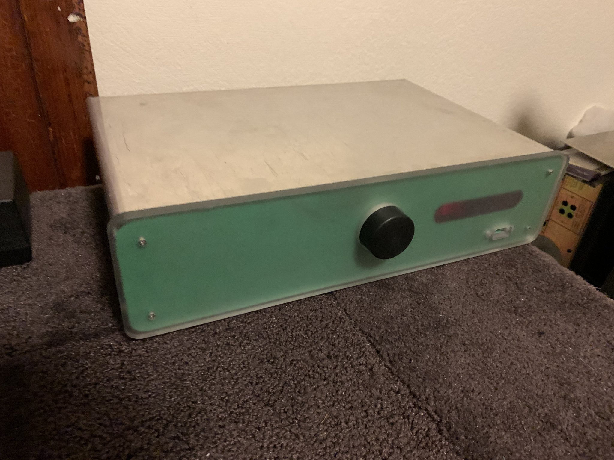

These devices are about the least involving as far as DIY goes. My setup is just a bunch of stuff arranged inside a box, plugged into each other. If I ever make a faceplate for the cabinet, that’ll be the DIY.

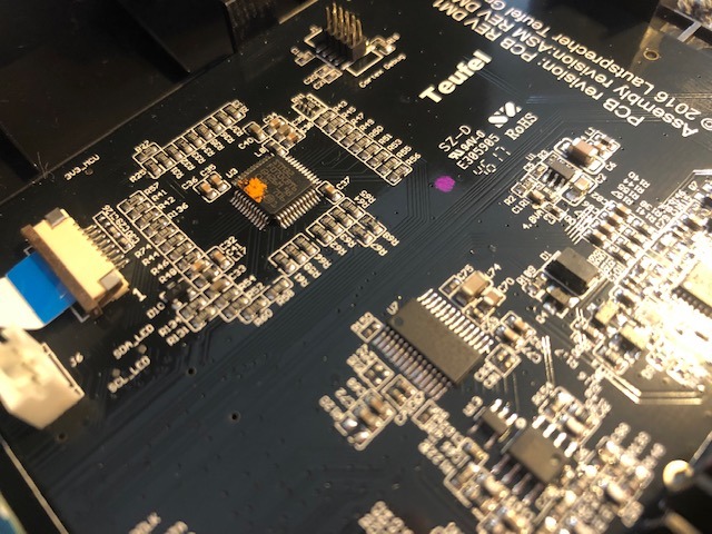

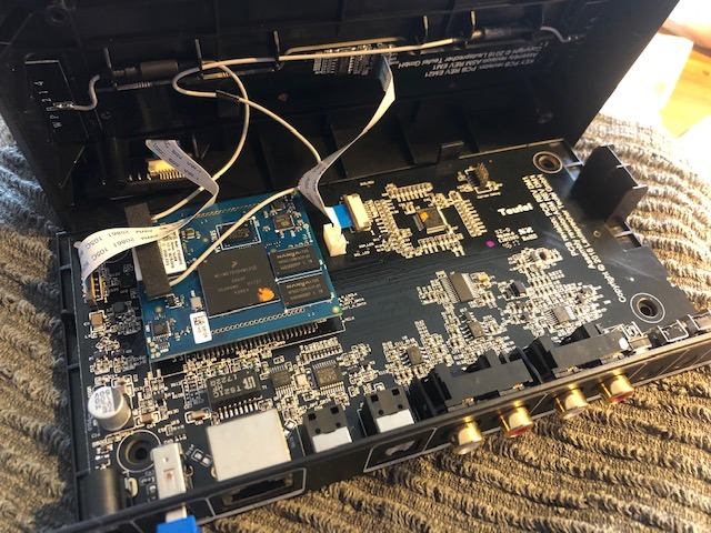

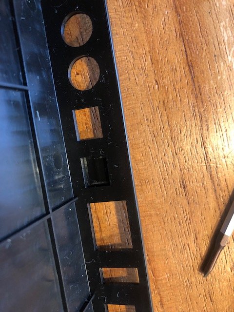

The Teufel was listened to both with original PSU and with a DIY linear PSU and only via ethernet. It sounded way better with the linear PSU as usual despite all unbelievable magical properties of SMPS and all the drawbacks of those terrible old fashioned transformers that really should be recycled to parts for green electric cars. Although it sounds OK it is no competition for the Elac DS-S101-G. Not a surprise when one looks at the price tag.
Since not a single photo can be found on the web I attached some pictures. Maybe the reason is this: the PCB indicates the device being designed/produced in 2016/2017. It seems it is the Connector 2 with added touch buttons and bluetooth because of the updated iMX7 module. The codec/DAC chip is CS4271 just like the Connector 2 has. Strange is the Toslink input that is covered and can not be used. Since I see confusion on weekly basis regarding inputs and outputs: this is an input to connect a source device to besides the also available Toslink output to connect a DAC to. The device get reasonably warm during use but there is no heatsink and no space for a standard heatsink.
Retail price is below 300 Euro so it is value for money for the average user. The software being stable and user friendly adds to that. Costs for a linear PSU should be added as it makes too much of a difference.

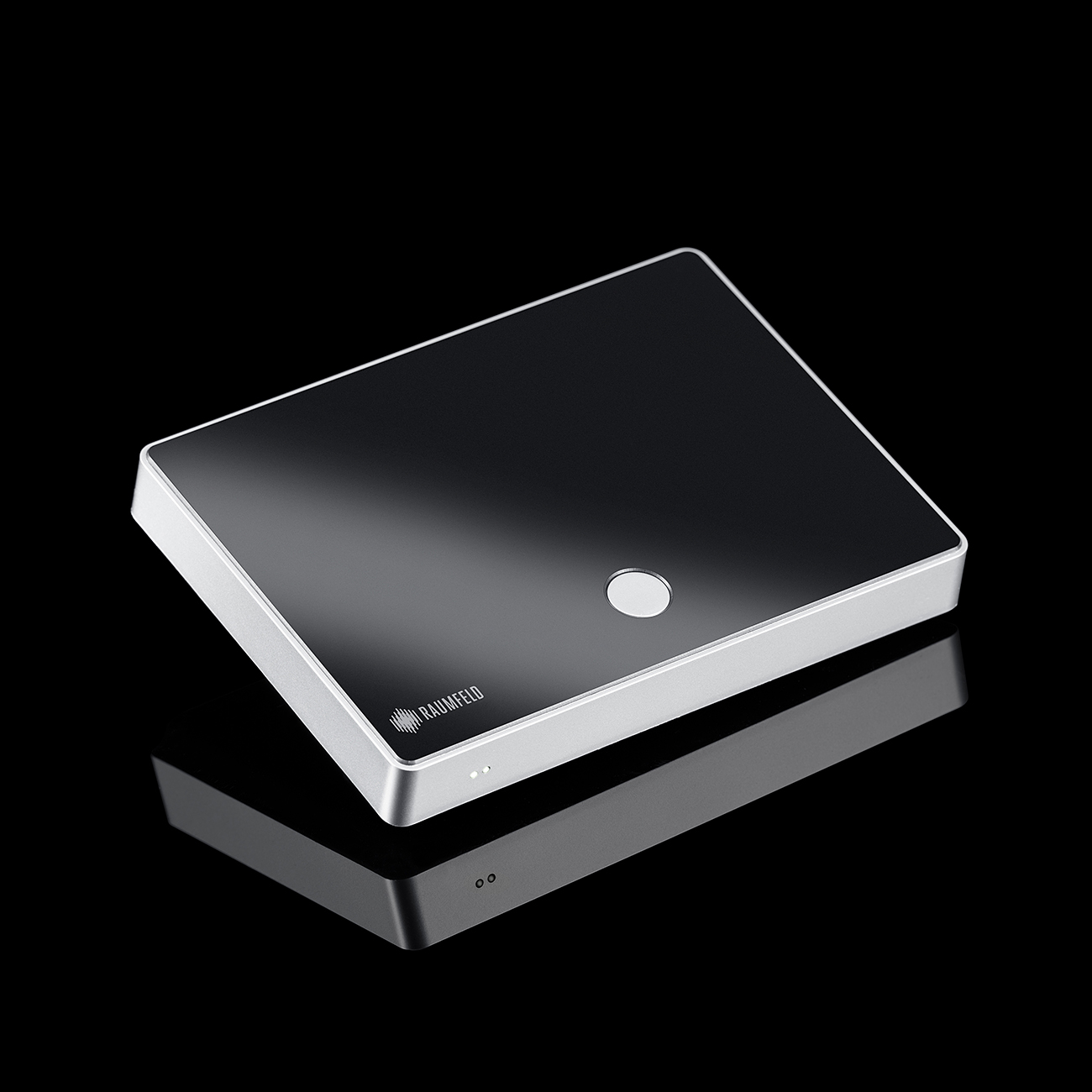

Received a Teufel Raumfeld Connector 2 for a short test. It is slower than its newer brother the Streamer. This particular device was built in 2013 but sold years later. The rubberized bottom cover had started to "melt" which is a very annoying phenomenon of that rubberized plastic. Soundwise it is just OK (over ethernet). Operation is a joy as the app is very good. Considering these can be found for 50 to 60 Euro (used) and that it is not the worst of devices and since many have DACs this device can be useful. Forgot to take some pictures but it is a nice build, better than the Streamer I think. It fortunately lacks Bluetooth and touch buttons. It support Chromecast but only if one registers, something that is normally not needed with this device. This particular device had difficulties connecting with the app when doing the setup, cause was probably the 10V 2.5A PSU that was dying as is the destiny and meaning of life for an SMPS. Add the cost of a linear PSU to the devices price and you'll end up with around 100 to 150 Euro. Make sure to find a S2.1 version which has a 10V 2.5A PSU and not one of the first versions with a 12V PSU.
The codec chip is the CS4271. The device plays 24/192 without issues. Cheap, does the job, stable operation, simple looks, excellent app but soundwise not one of the best.
