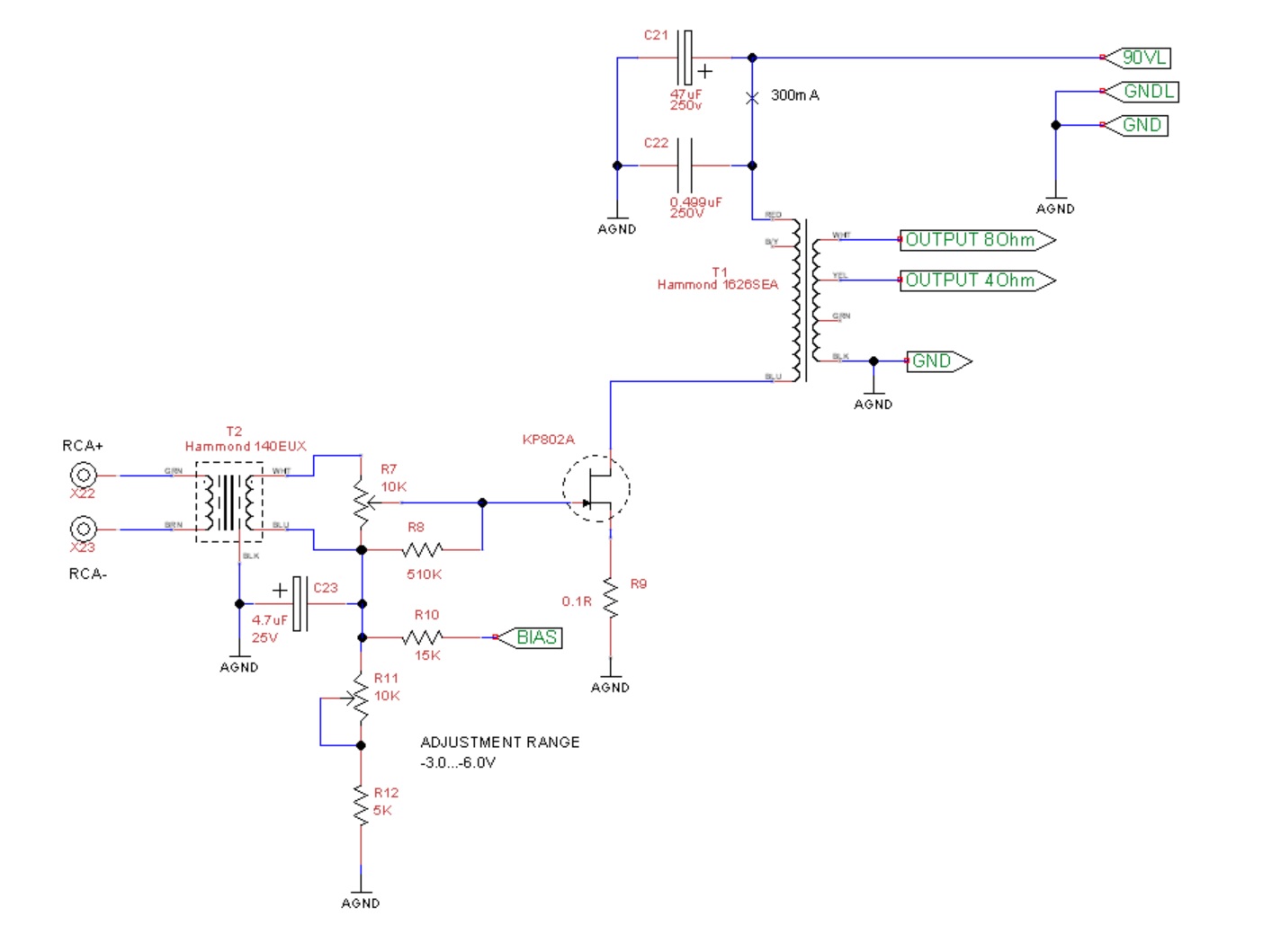

Look, Ma, No Coupling Caps! A Transformer Coupled VFET/SIT Amp Design
Then that capacitor is in the audio signal path as well as any series cap, isnt it?
You circuit is how you would simulate it and the practical circuit will have a few more parts to it.
I always drive SITs with a transformer and the circuit from Zen Mod captures almost precisely how I do it as well, including the value of the DC resistance. Your SIT requires some examination, I believe, before you could finalize your own circuit. If I were in your shoes, I would mount the SIT on a heatsink, connect them to lab power supplies and measure things you need to know to design the circuit. Again, the key one is the leakage current, in my opinion. And then heat it up externally and measure. Heat it by power produced by transistor itself and measure. And then take a different transistor and measure it again...
It happened to be the beginning of the pandemic for my PP project, so I was stuck at home anyway and I used this time to do a lot of measurements. I had app 40 devices at that time, so it took me a few weeks before I understood how it should look.
And then the amplifier was built and it was working great and then my stupidity pushed my hand where it should not have been. And I lost my best pair of SITs. After I replaced it, I started blowing a fuse on B+ after 10-20 minutes of operation and that brought me back to measurements and I found that the dynamics of thermally induced gate leakage current increase has much wider spread than I originally thought. Some keep climbing steadily, some got a hockey stick increase at some temperature.
SITs are absolutely great for sound but they are like people - every one is somehow different even if it looks the same...

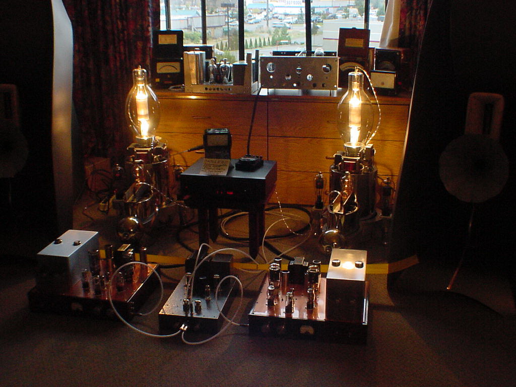

I am one of SIT people too. No SIT people should be scared of the GM100, we love them cute triodes instead.
About your question on the distortion, I can not say from experience, need to complete the prototype first, which will not be soon due to my budgetary condition. However, looking at the datasheets, I'm pretty sure it can deliver 2% @7W into 8 ohm when setup as output stage appropriately in a schematic similar to he one you posted. But it would probably be easier to setup 2% @ 100W and 10% @ 200W into 8 ohm, and not directly from DAC output. As a preamp it has a mu of ~18, enough to drive F4 full tilt from DAC output at miniscule ppm THD.

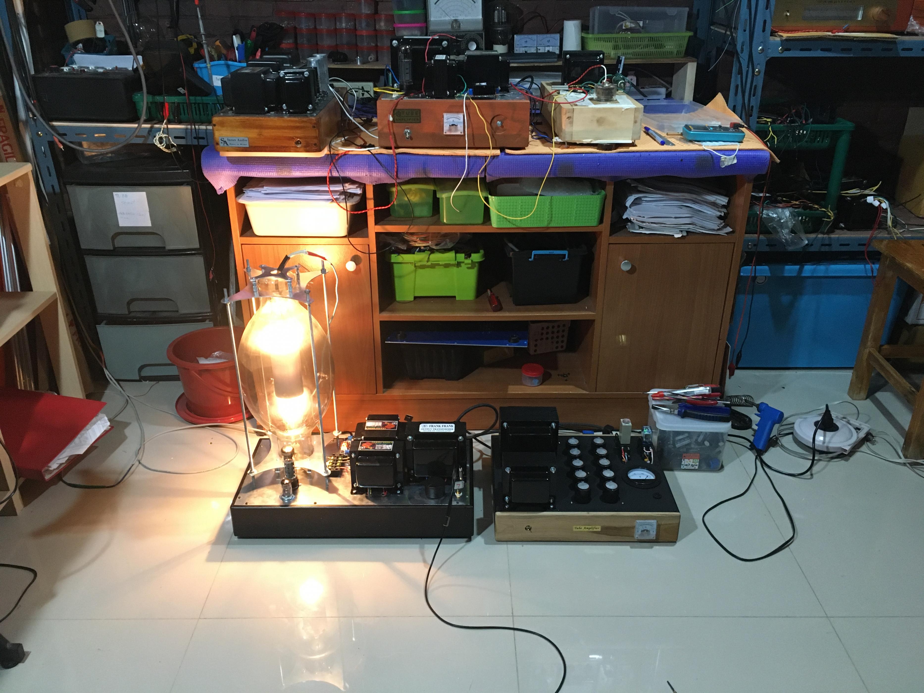

Ain't they cute? I'd encourage SIT guys to use them, probably as preamp (or simpler as audio gear lighting or room decoration) to rectify the issue of our gears being called sissy. I know ZM loves them so much he'll have a hard time calling them sissies. And remember what Papa said .... while they last. 😀
Reactions: ozorfis
Ehhhm Radiola, those are not mine, I borrowed the pics from the GM100 thread I linked on my prev post. 🙂
Them GM100 are 1000W triodes, almost 200W achievable with adequate input drive.
