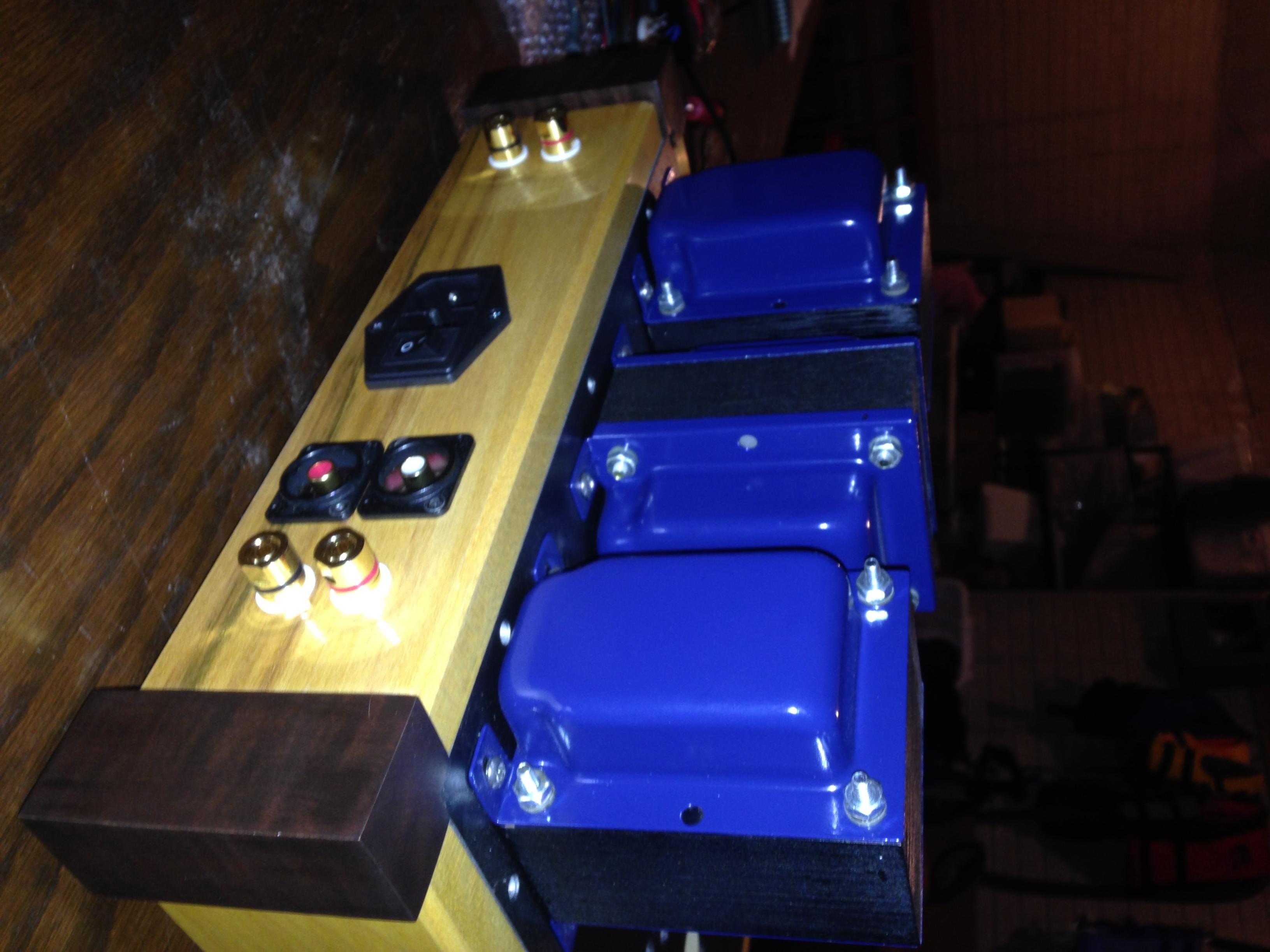

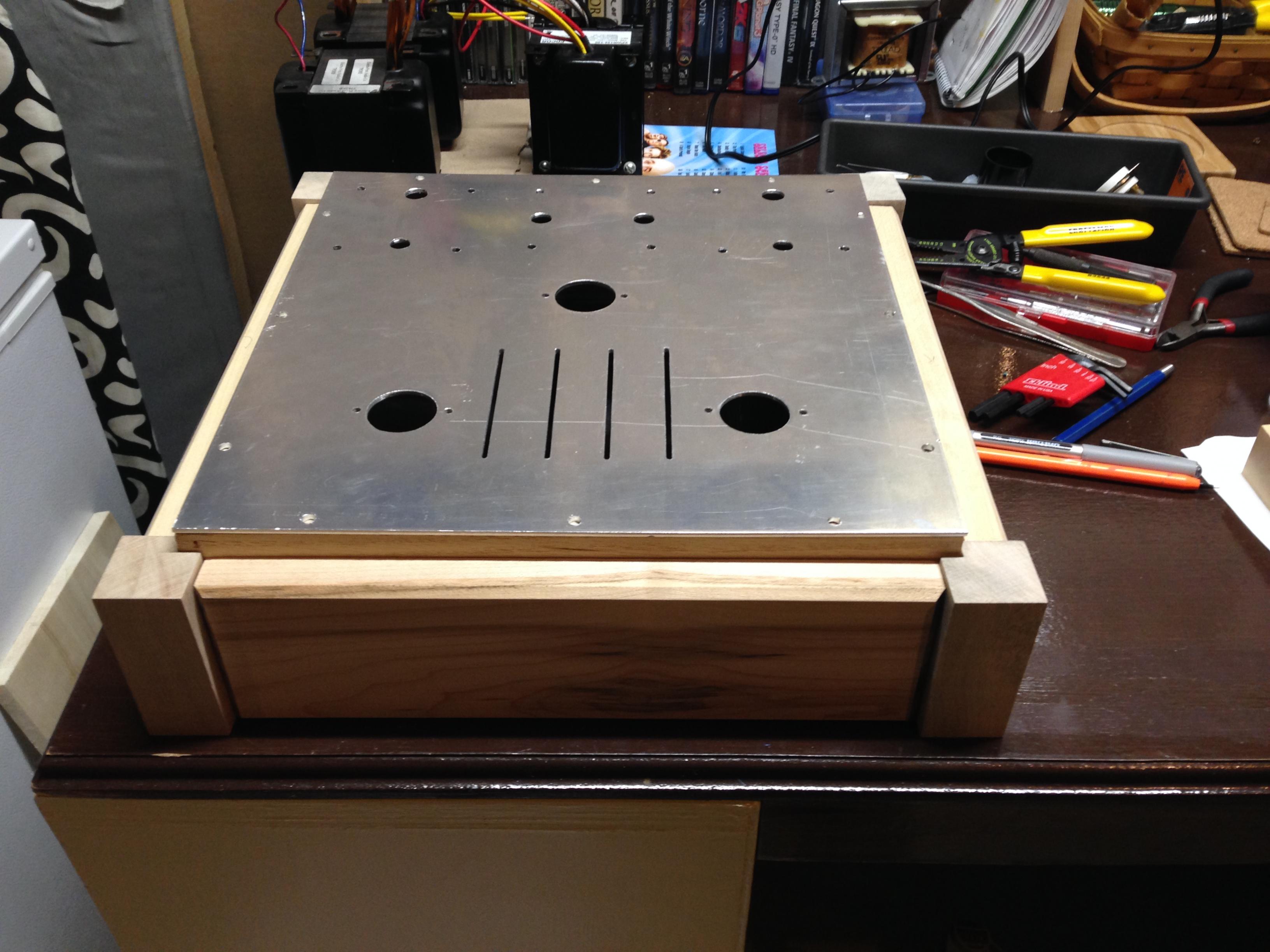

So this is about 10 years in the making. This was a 2A3 that is about 10 years old.
Edcore Power
Electraprint TM3Kb outputs
Maple/Walnut base
Aluminum top plate

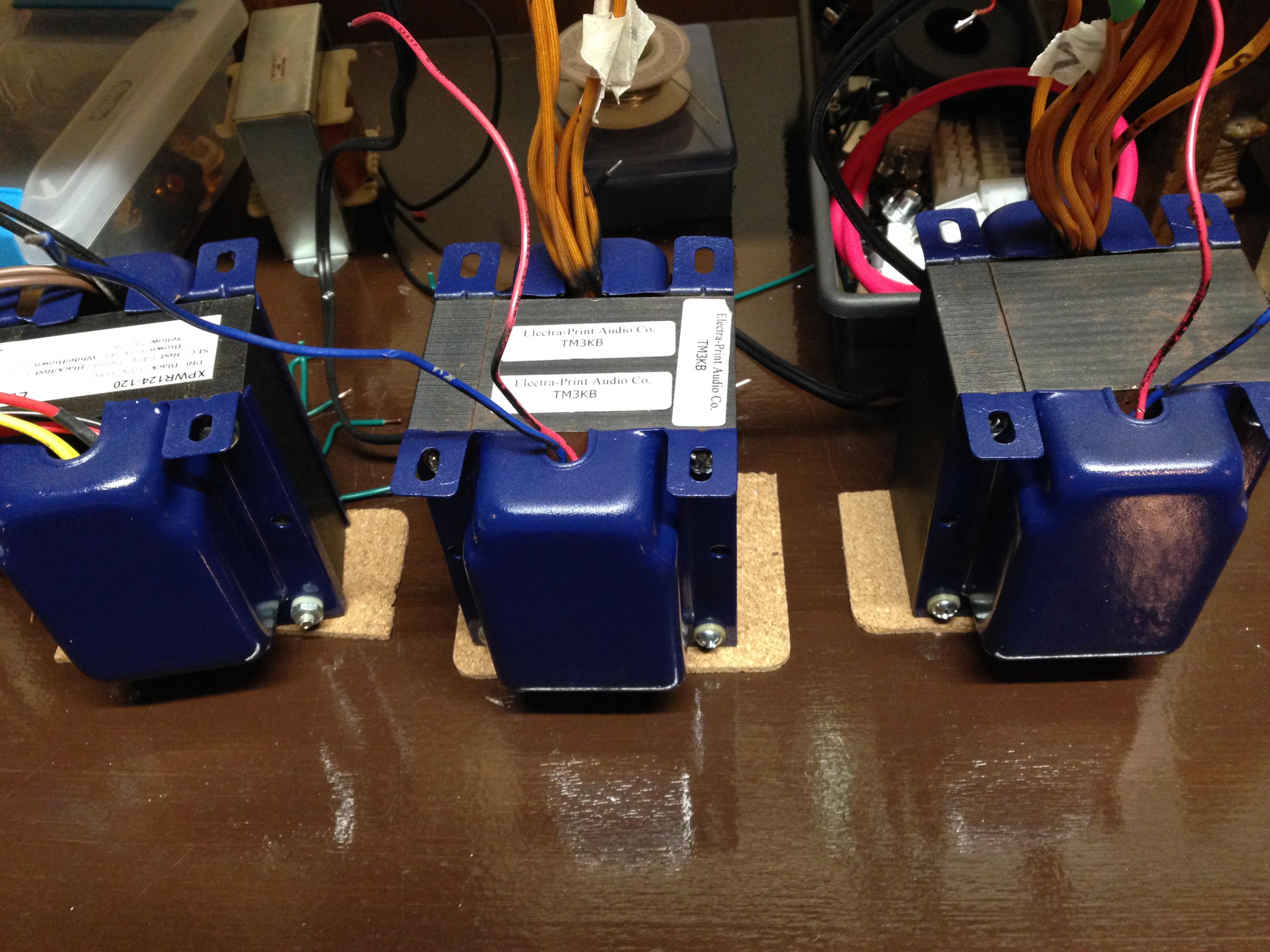

The wife picked out the blue color for me on the trannies. Hoping to have this done in a couple months.
Painted w/spay cans.
Thanks,
Jeremy

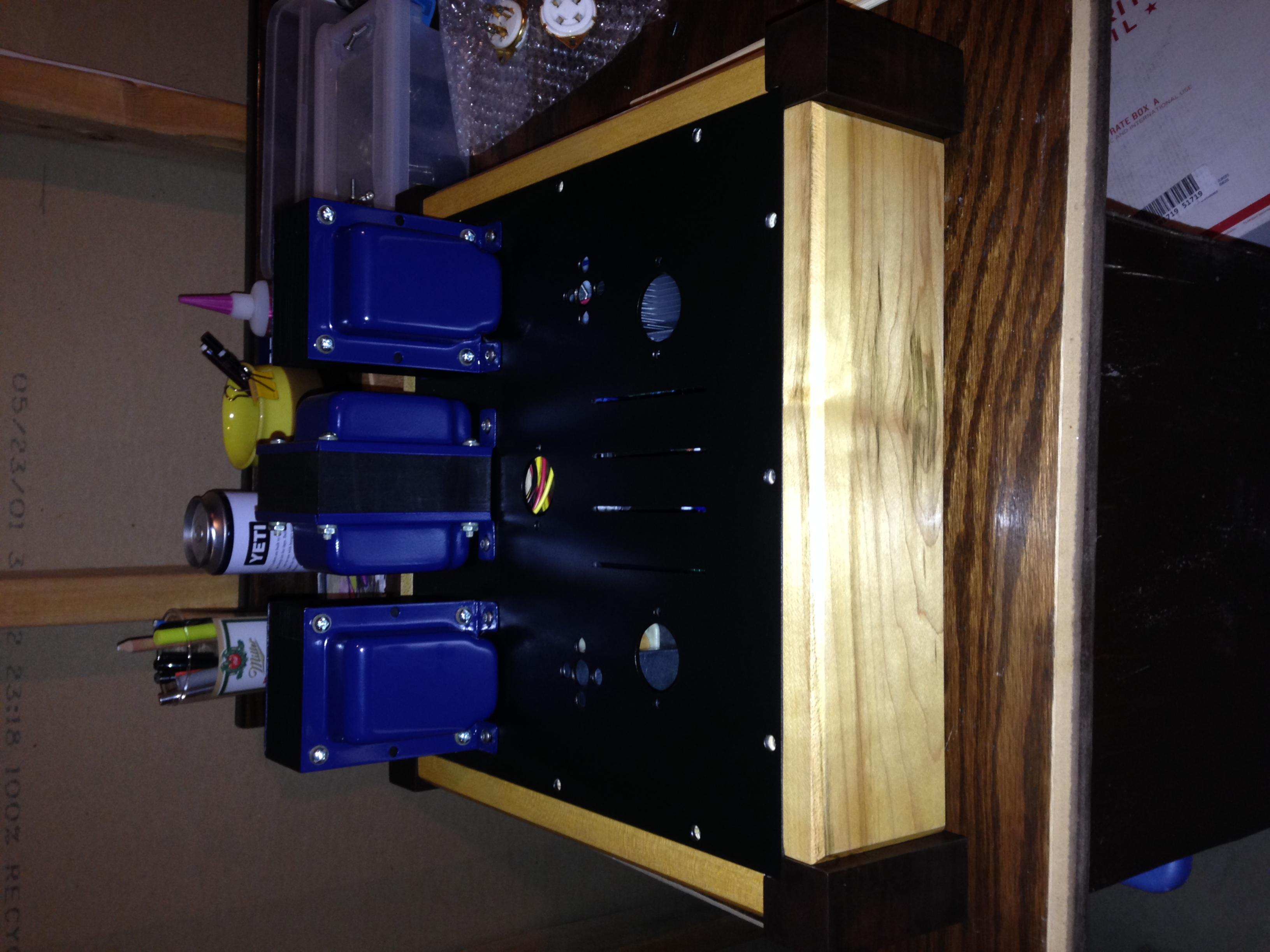

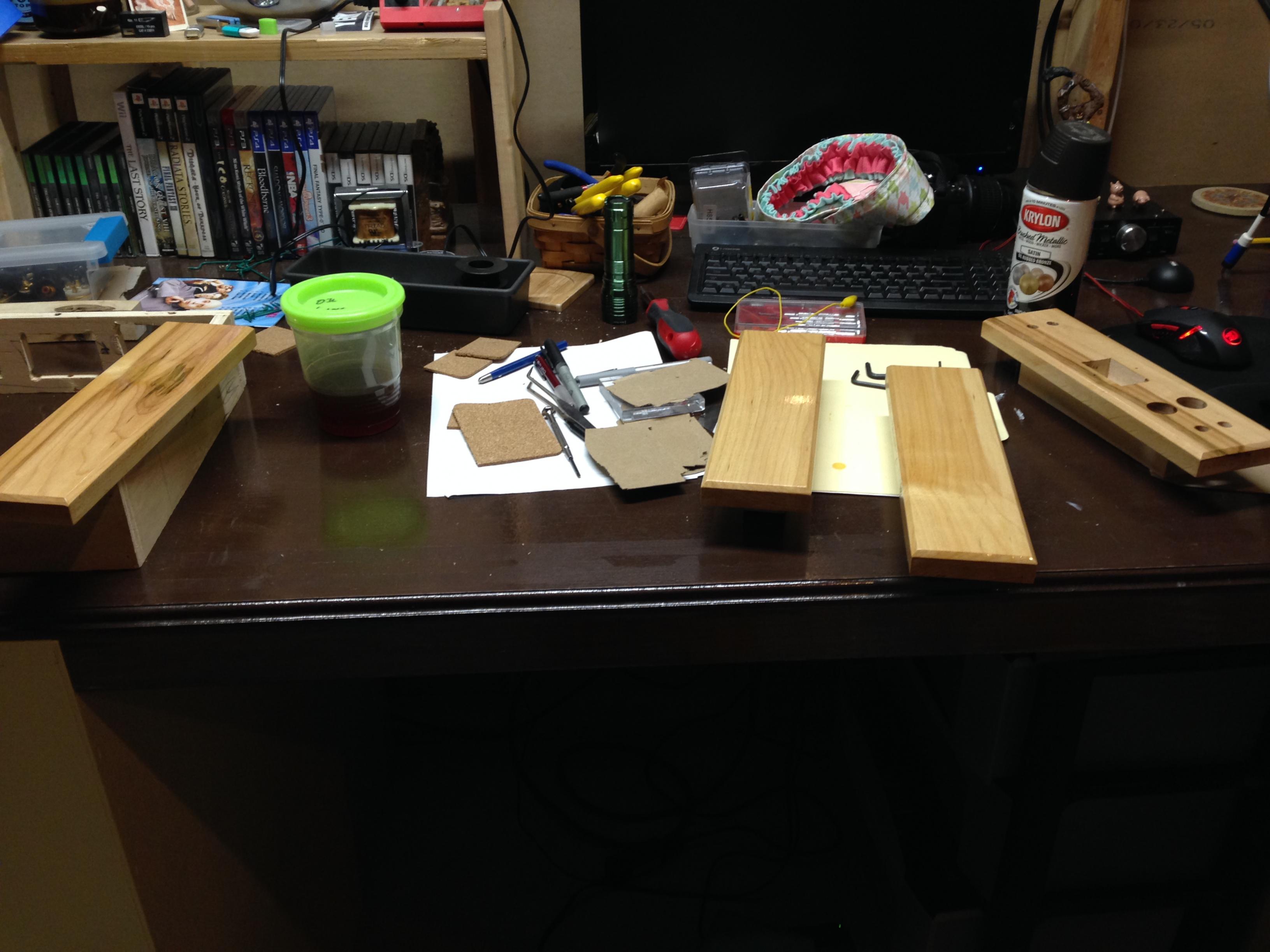

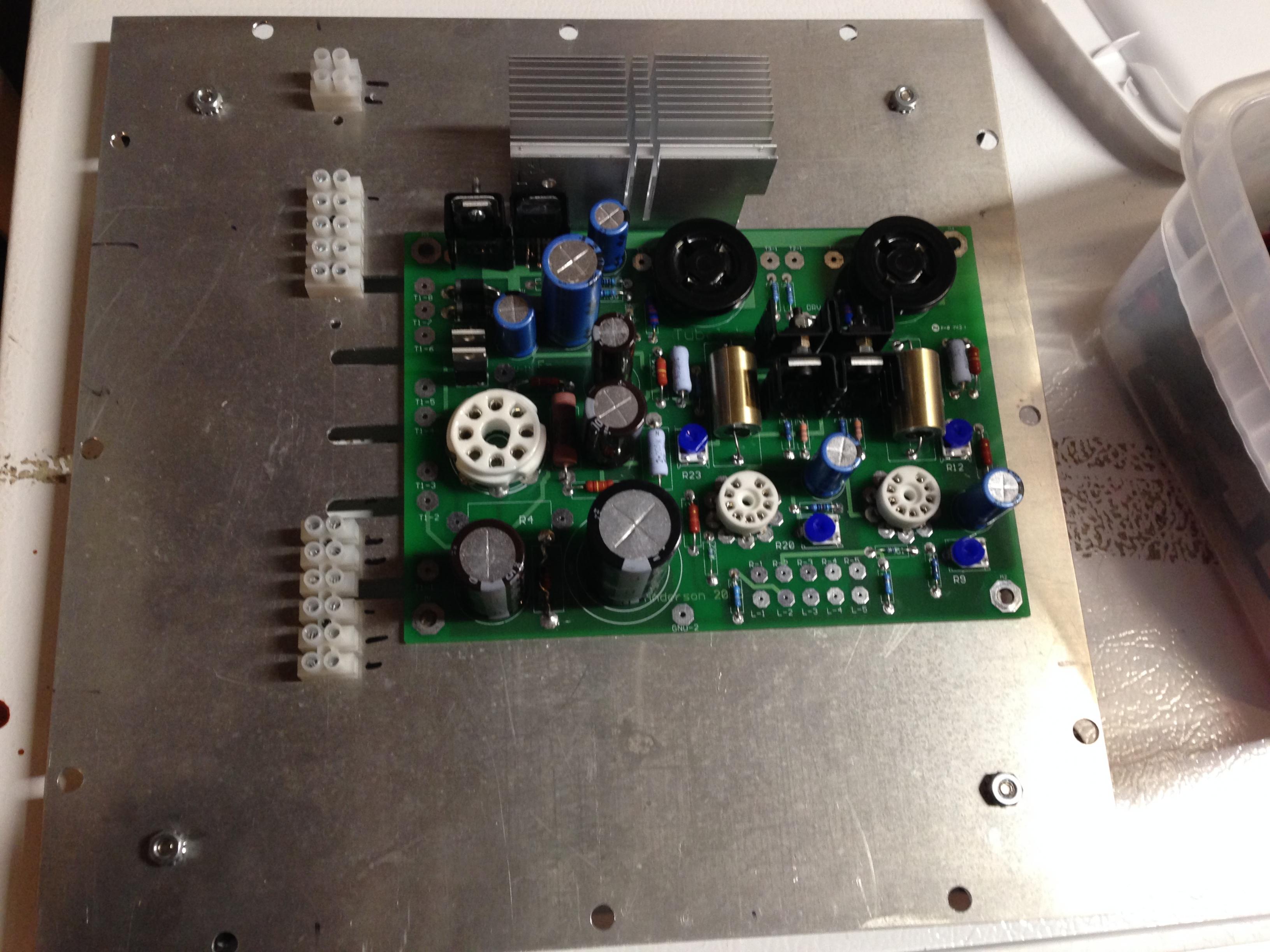

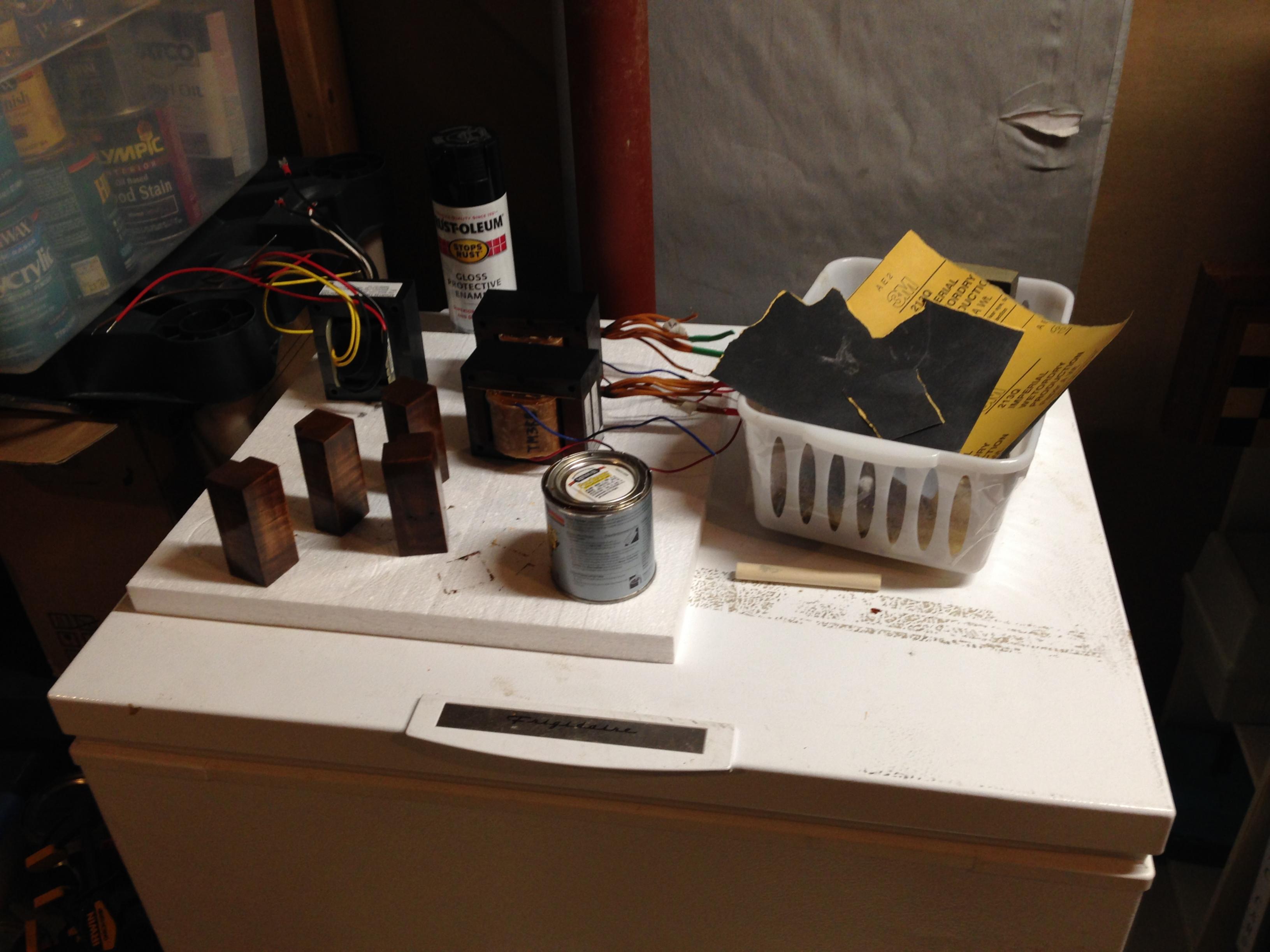

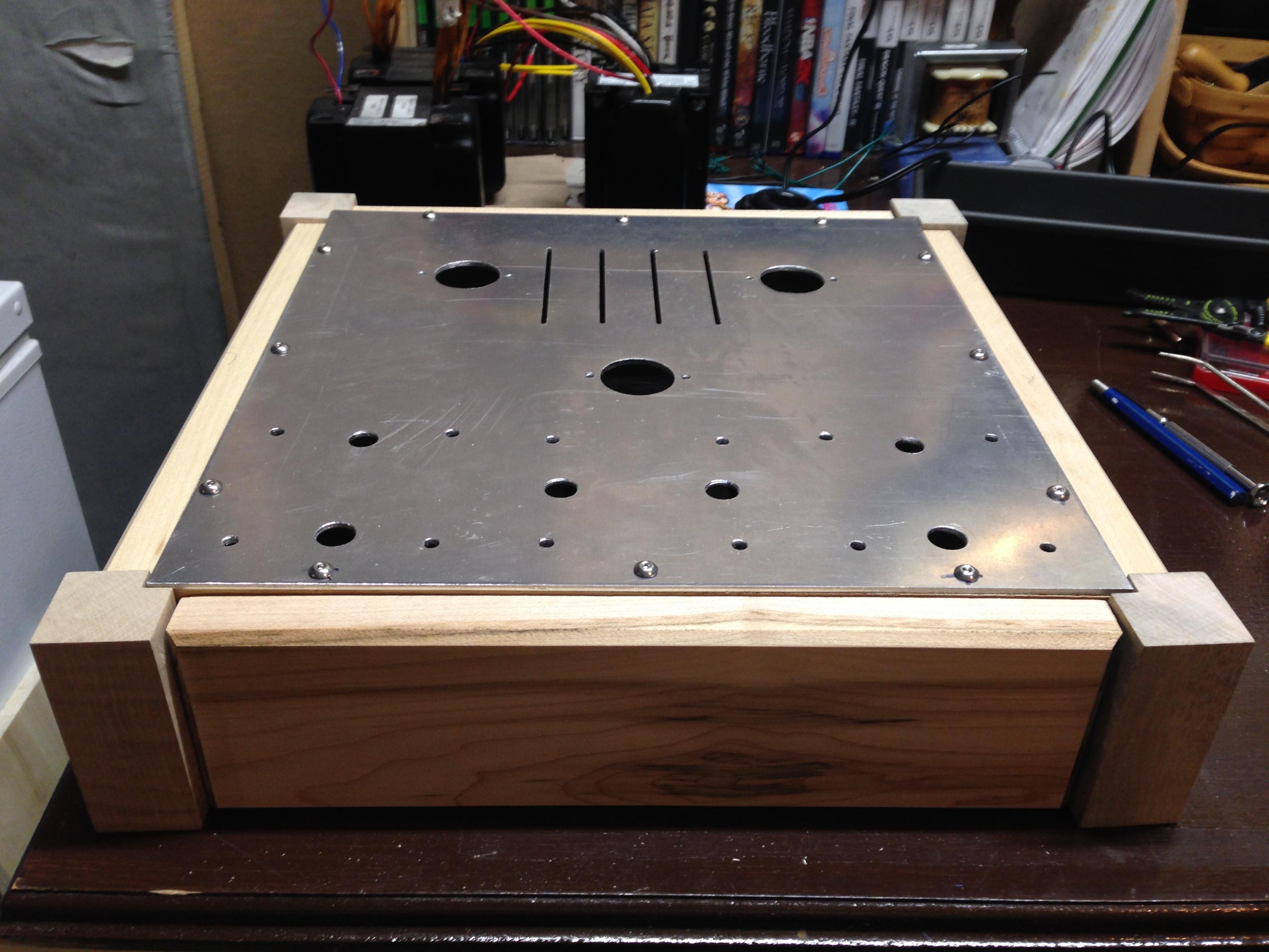

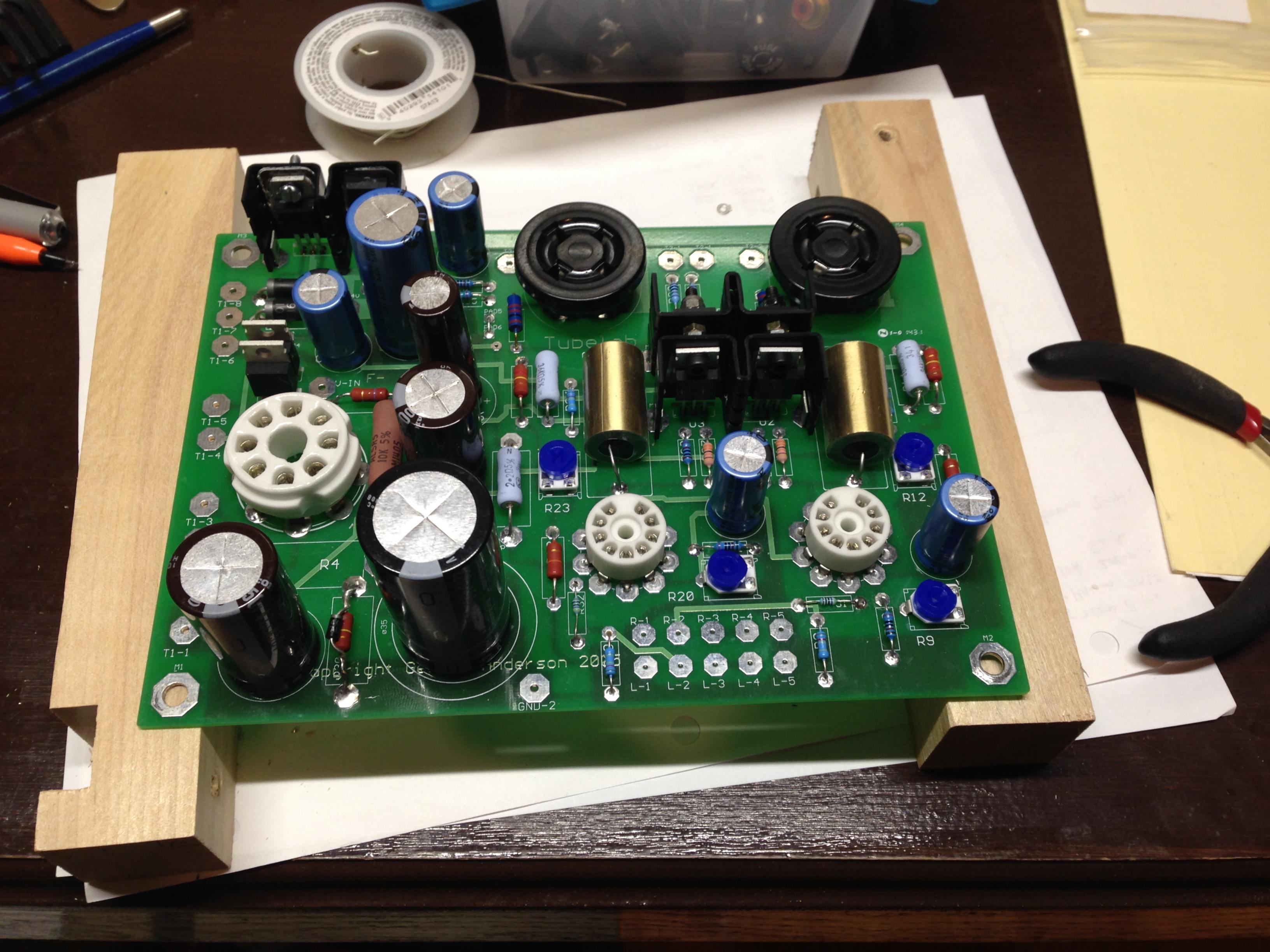

More pics....
Need to attach, fine sand and rub the mirror finish on the base.
Install the board
run my wires and wire the jumpers.
I am running jumpers to the main top plate since I want the rectifier and 300B tubes mounted to the top plate.
Install the board

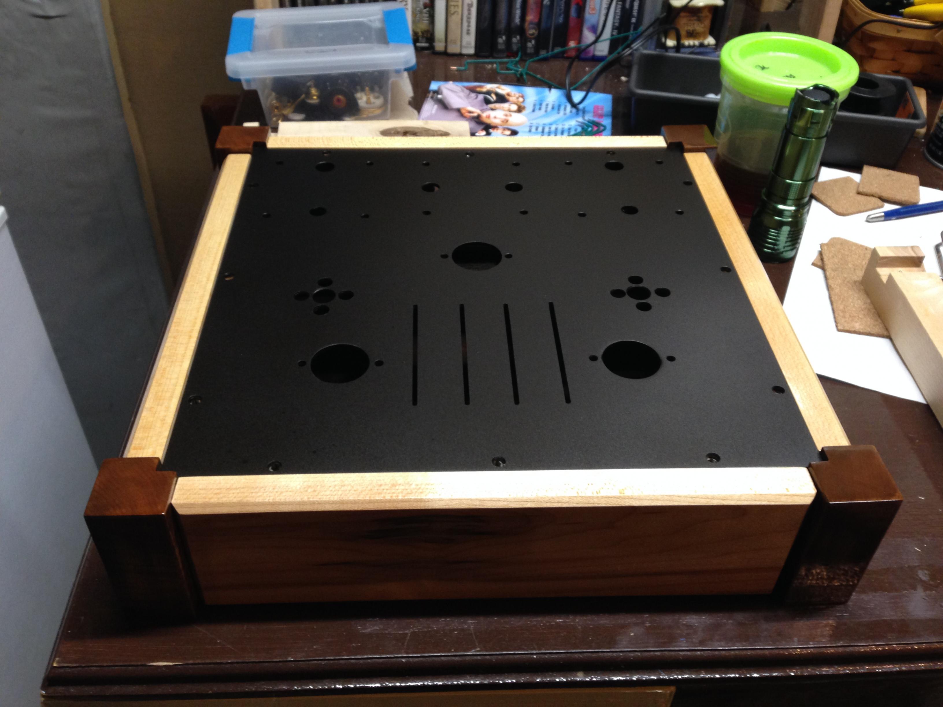

So after 2 years I started work on this again. 1st step is refreshing my memory and my notes on where I left off. I’m almost ready for initial checkout.
Coming soon!

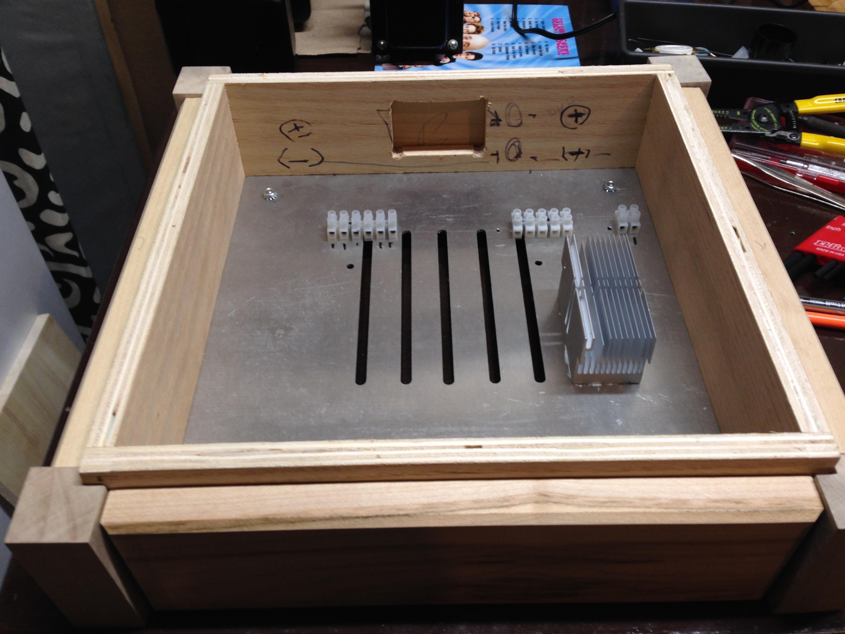

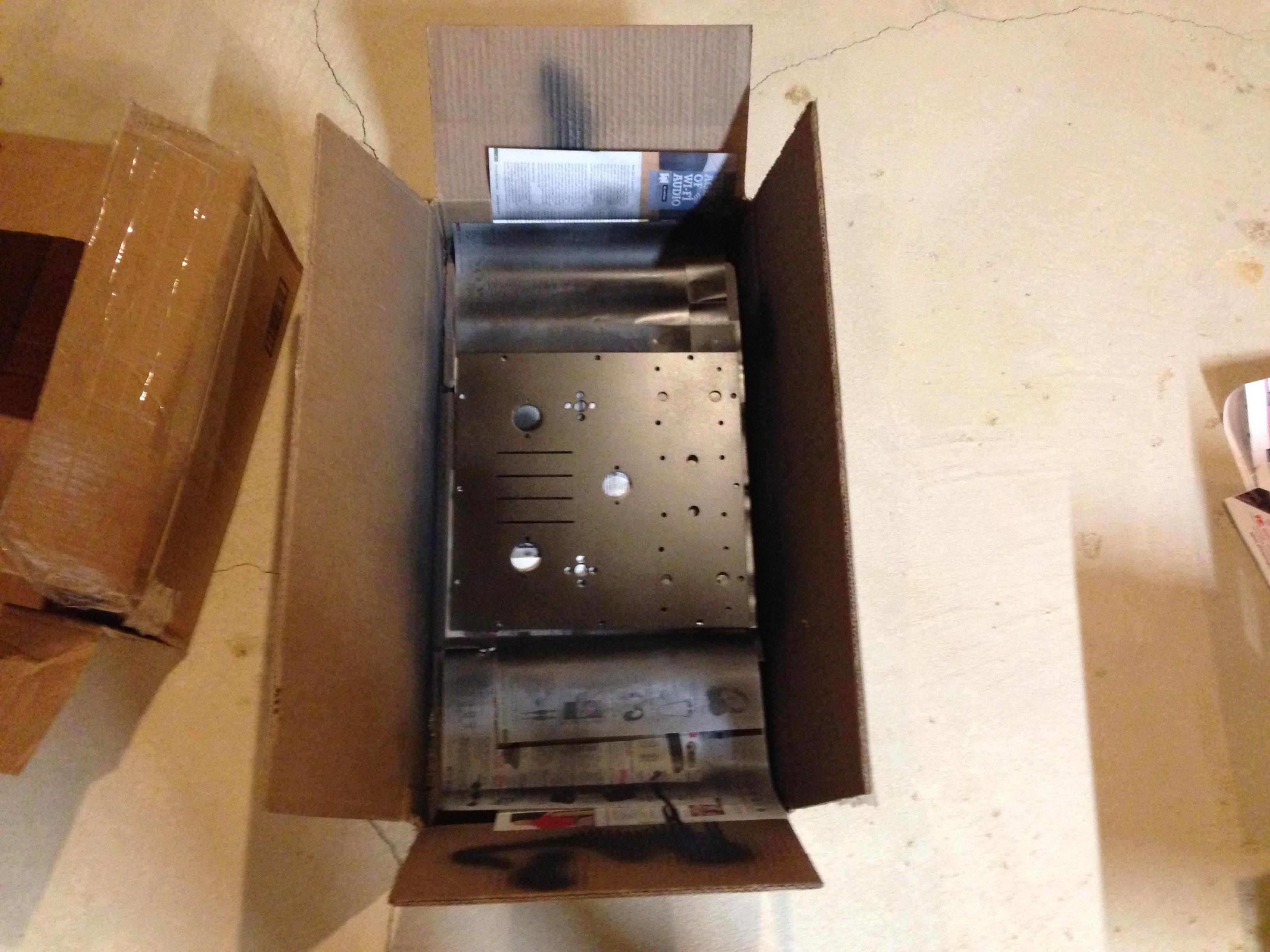

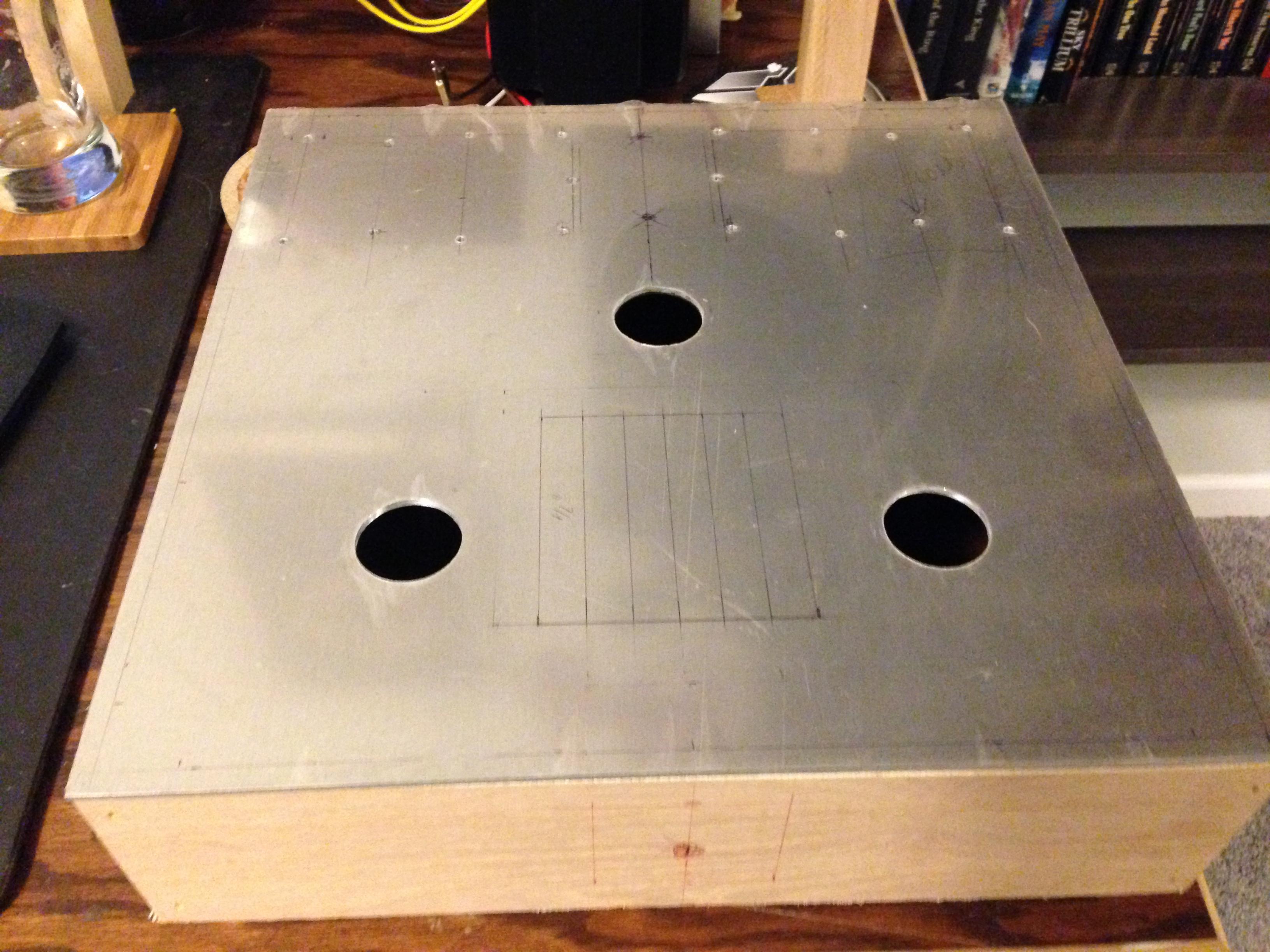

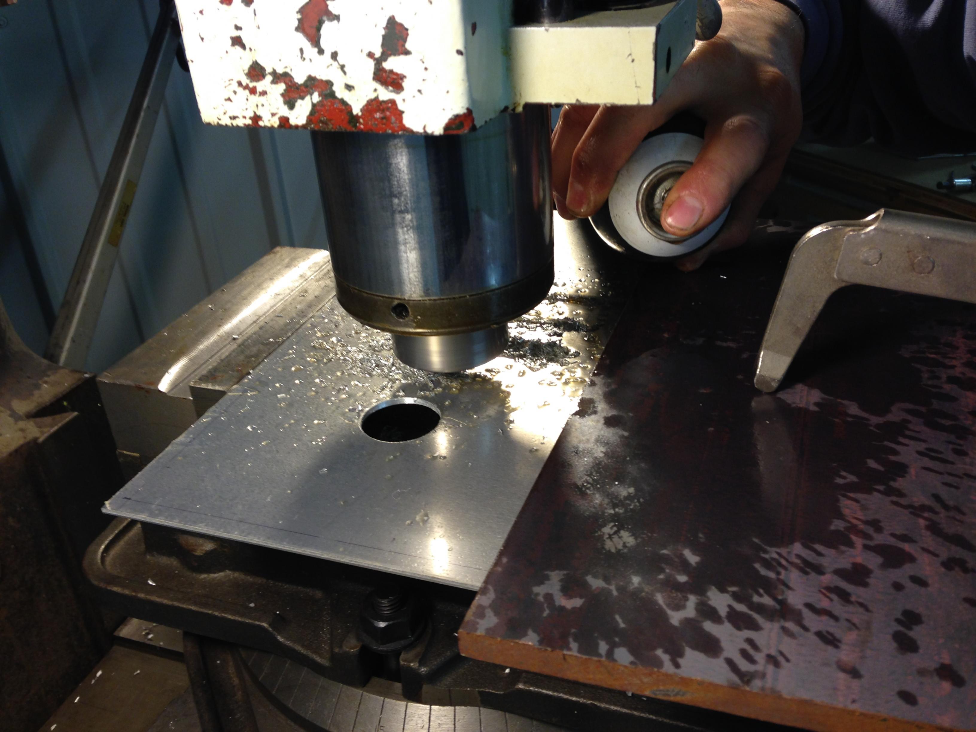

Thanks for the kind words.

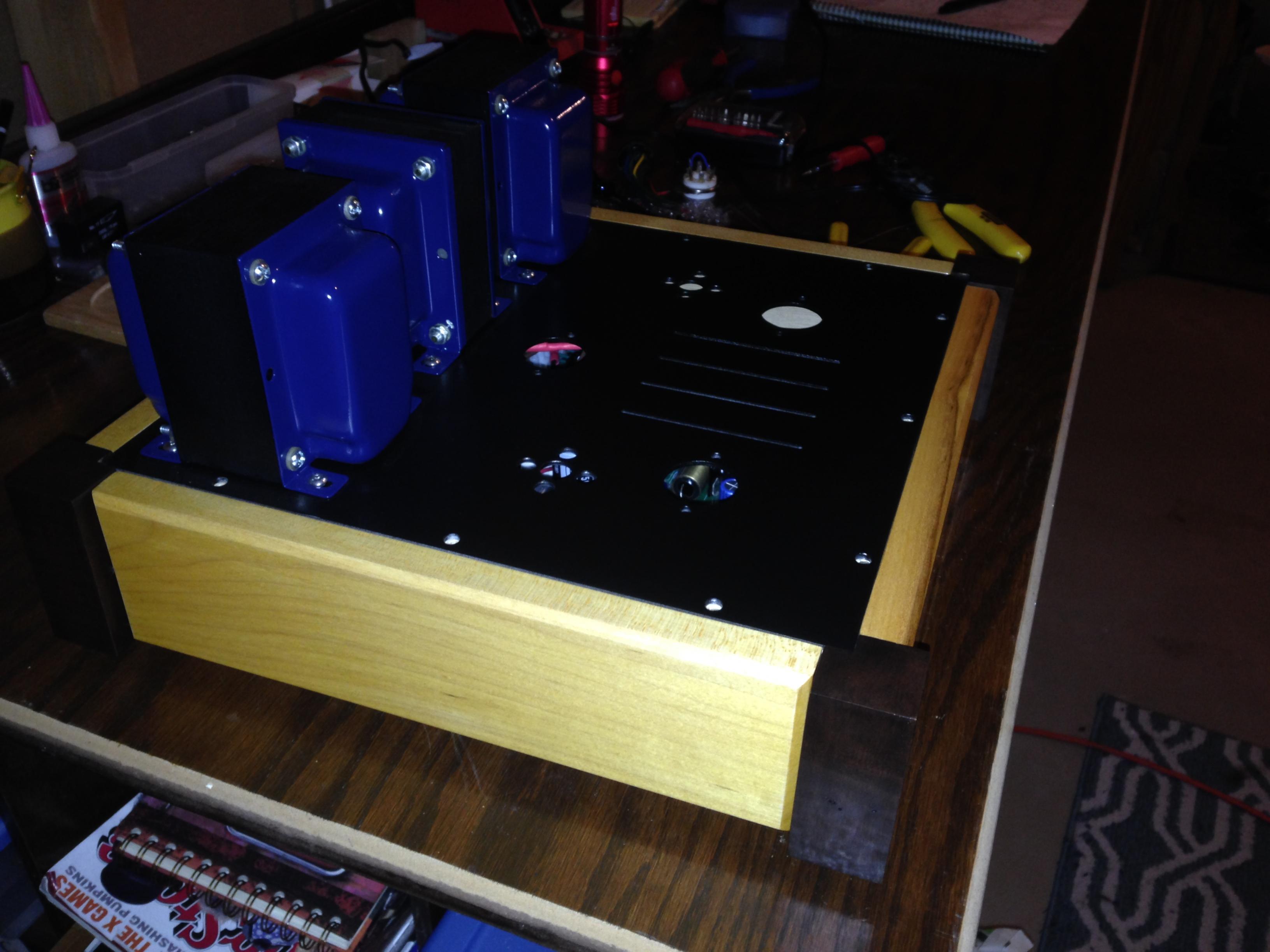

We did use a mill for the vertical lines on the top plate.
Everything else was done by hand and hole punches.
Made some progress a year later.
Working to finish the tranny wiring.

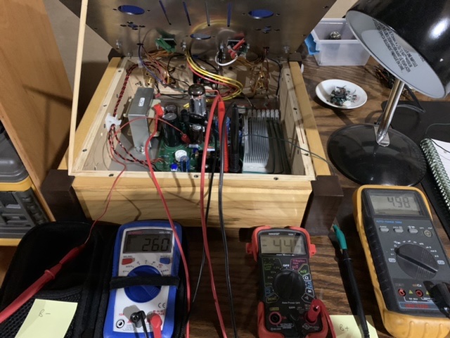

It’s alive!

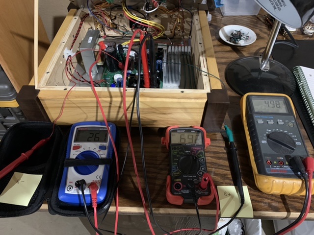

First power up specs no tubes.
B- @260v
B+ @ .69v
Filament @4.98v
Slight hum in the chassis but at least no smoke.
B- @260v
B+ @ .69v
Filament @4.98v

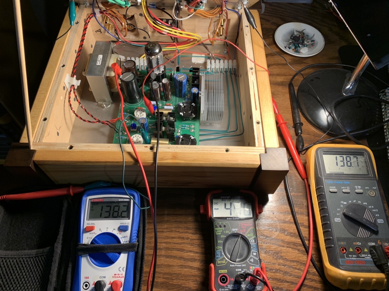

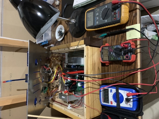

No 5842 installed:
B+ 445v
R/L channel coupling cap 138v
5842 installed
B+ 445v
R/L coupling cap 10v no change using the potentiometer.
Any ideas why voltage is low and won’t change?
B+ 445v
5842 installed
B+ 445v
