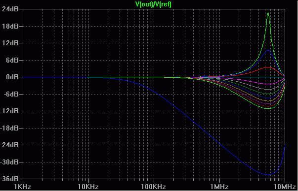

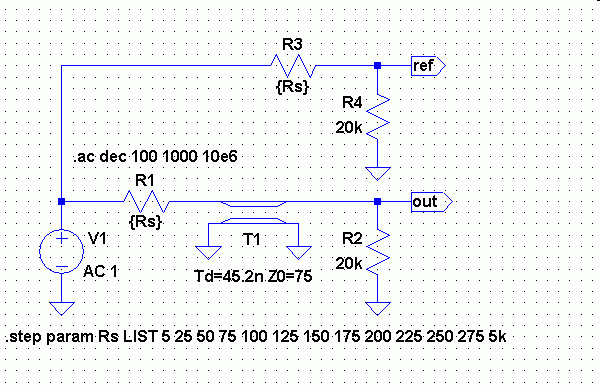

I tried a simulation of an ideal transmission line having a delay of 45.2 nsec, with a source having resistive impedances ranging from 5 Ohms to 5 KOhms, with a resistive load of 20k. Next to this I put a simple voltage divider having the same source and load. I did a plot which takes the ratio of the output voltage of the transmission line with that of the voltage divider in order to keep everything to 0 dB at DC. The 45.2 nsec assumes a coax length of 30 ft, with a dielectric constant of 2.2 (teflon). That's a nice long cable. LTSpice does not have a lossy line model, so I'm stuck with a lossless line model. However, the popular Belden 89259 has an attenuation per 100 ft of 0.9 dB at 10 MHz, which is not too bad, even at this length. The circuit is shown below.
...and here's the plot. The trace with the peaking is 5 Ohms source. The flat trace occurs when the source is matched to the 75 Ohm characteristic impedance of the line. The one with the rolloff is the 5k source - meant to simulate a 20k pot at 6 dB down from maximum. These are surprisingly good results, even though the line has almost a purely reflecting load.
So my opinion in all of this is: use an active preamp with a 75 Ohm resistor right at the op-amp output. Make every attempt to preserve the 75 Ohm impedance up to as high a frequency as possible. So you might use the microstrip formulas to determine the correct trace width for your board thickness and dielectric constant to give a 75 Ohm microstrip. Use a good 75 Ohm cable, such as Belden 89259. Make the interconnect cable long and place your monoblock amplifiers as close to your speakers as possible.
andy_c said:So my opinion in all of this is: use an active preamp with a 75 Ohm resistor right at the op-amp output. Make every attempt to preserve the 75 Ohm impedance up to as high a frequency as possible.
