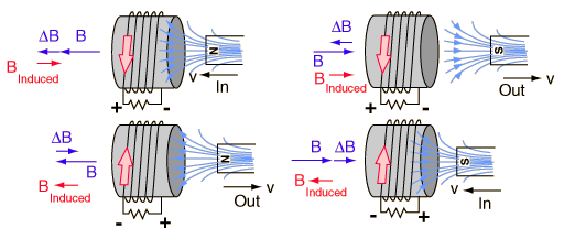

Well, it just seems that most every other reference states that the induced voltage will be differential.
For example, take symetrically round loop of wire and pass a magnet through its center such that each portion of the loop is equidistant from the magnet. Pretty much everything out there I've seen says that this will induce a voltage and subsequently a current that's proportional to the amount of flux changing in the loop and the loop area. The polarity of the induced voltage depending on which way the flux is changing and the polarity of the field.
For example:

According to most references out there, any change of flux within the area of a loop results in a differential voltage.
See, a balanced line only rejects common mode noise, NOT differentail noise, if it did reject that too the net result would be no signal at all.😀
